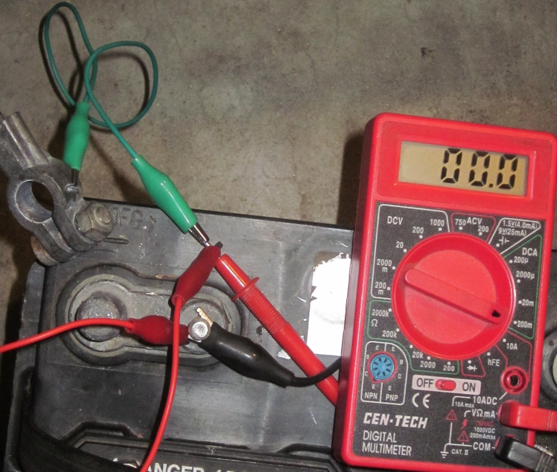

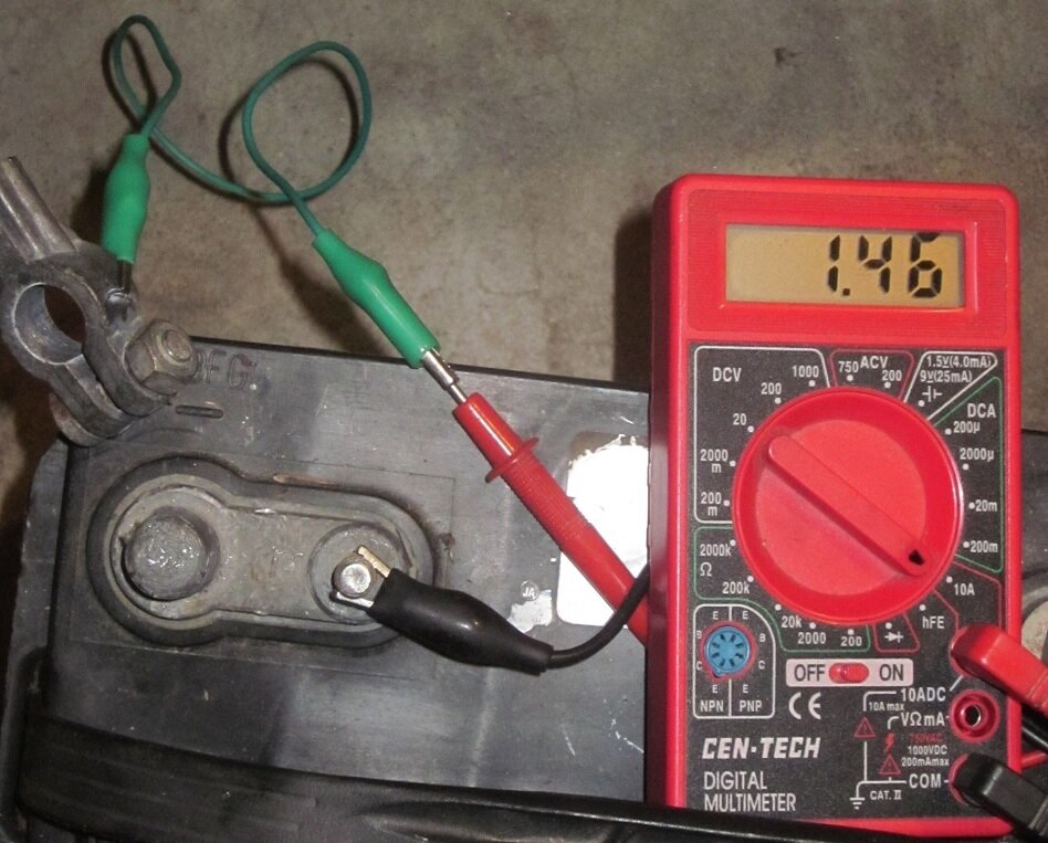

Here's photos of the procedure I use. In the first one, the negative battery cable has been disconnected, then the amp meter is connected to the battery post and cable. The green clip lead is just used so I don't have to hold onto the red probe. The meter is on the highest current range, 10 amps. That requires using the special 10-amp jack for the red lead. Current is 1.46 amps. That's enough to drain the battery in a day or two.

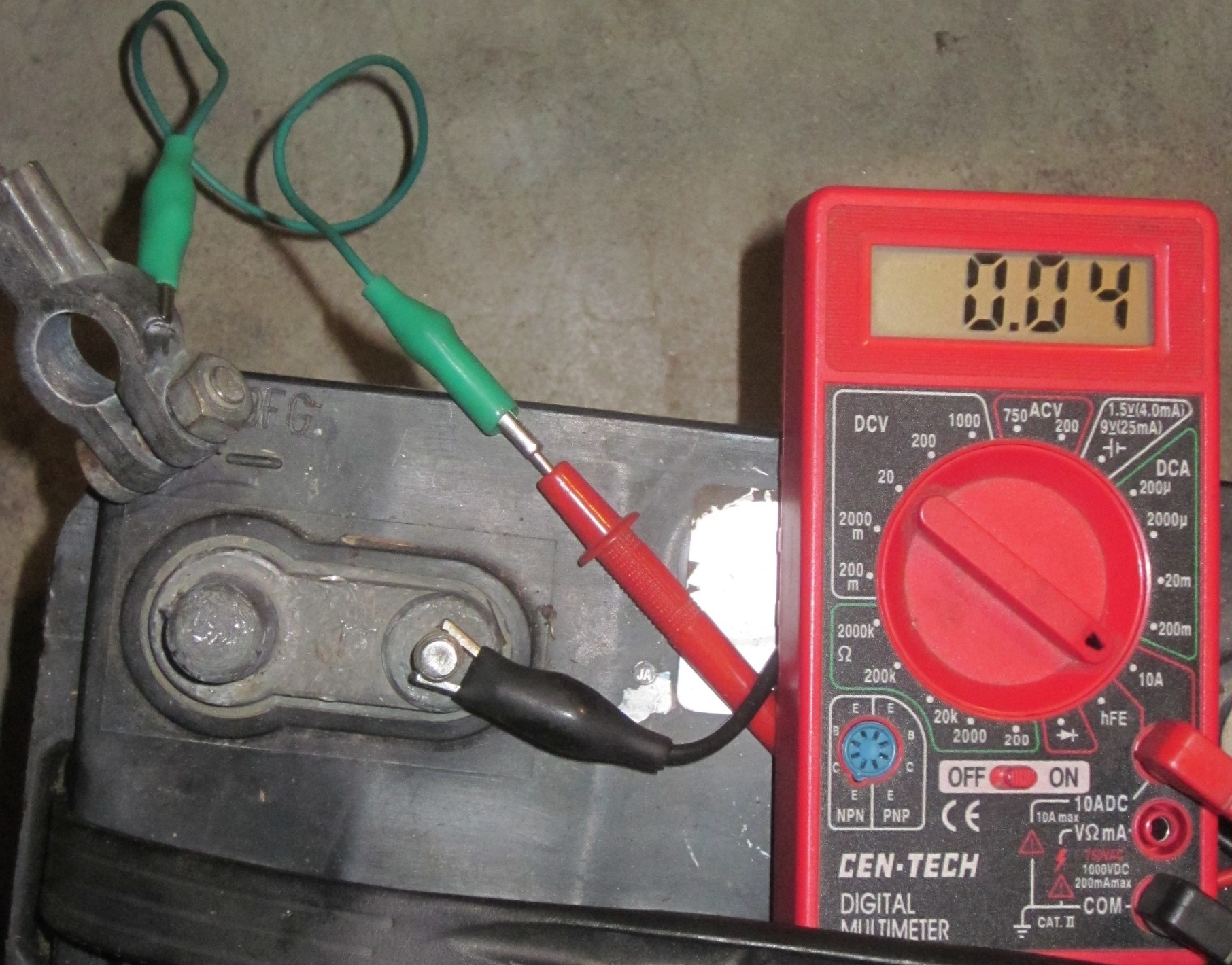

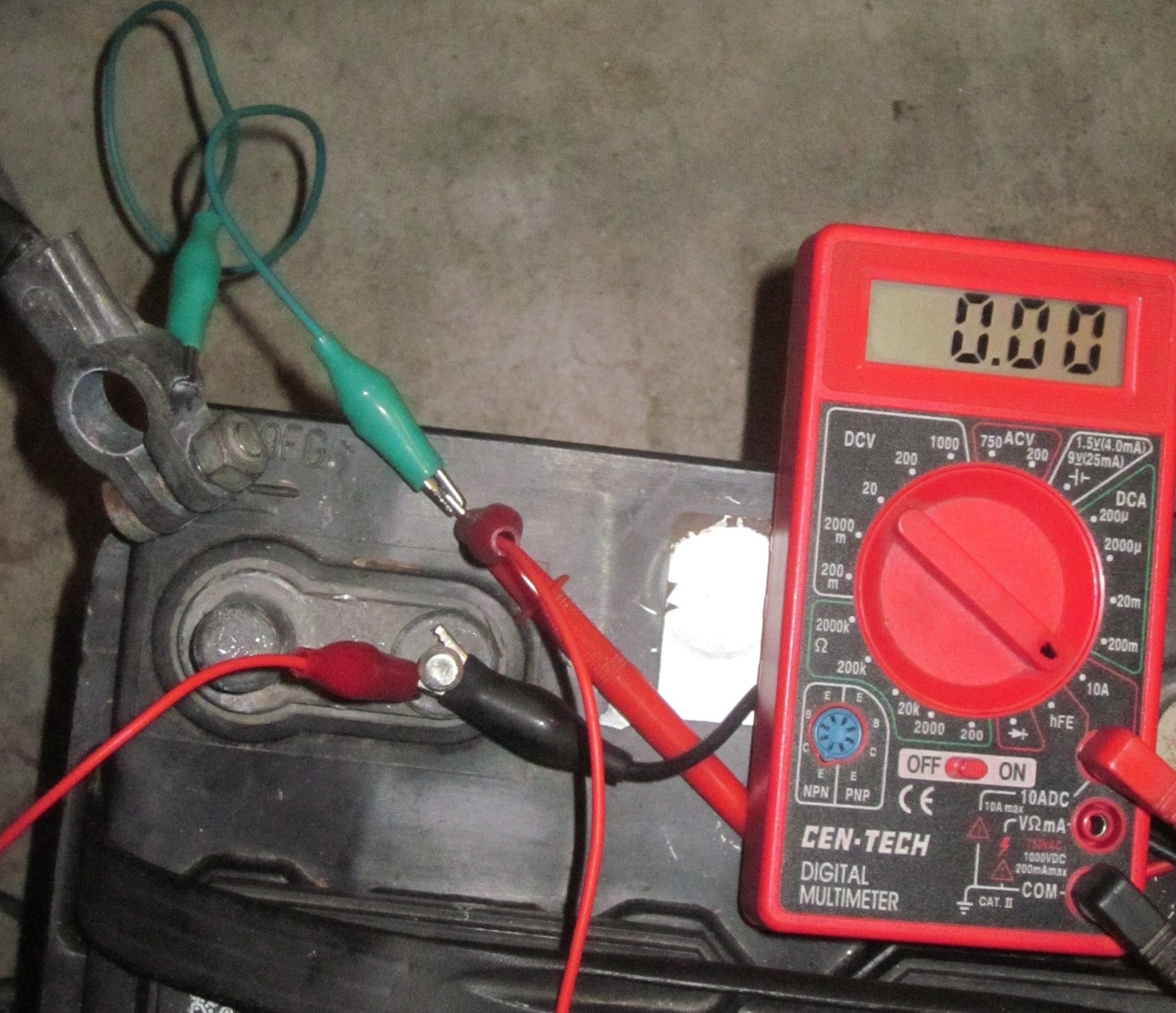

In the second photo, nothing has been changed except the computers have gone to sleep mode. .04 amps is close to the allowable limit, but to get another decimal place of accuracy, we need to switch to a lower range. To do that, in the third photo, the red jumper wire has been added between the battery post and the cable. Now, no matter what we do with the meter or its leads, the circuit will not be broken. The meter is reading 00.0 amps because current takes the path of least resistance, which is through the red jumper wire.
In the fourth photo, the red meter lead has been moved to the common jack, and the range switch is turned to the 200 milliamp range. Either of those would have broken the circuit if the red jumper wasn't in place.

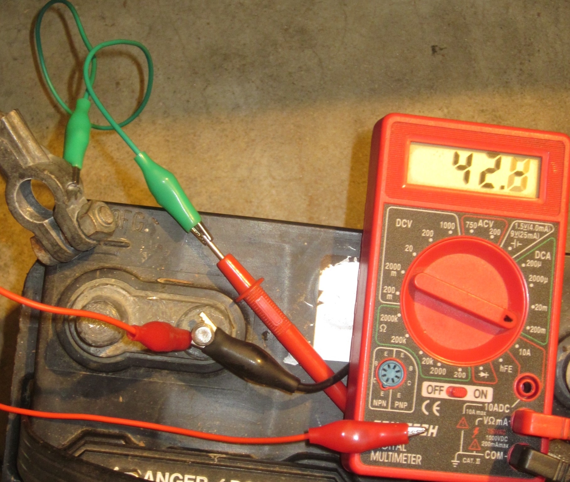

Finally, in the fifth photo, the red jumper is disconnected on one end. Now current has to flow through the meter. It's reading 42.8 milliamps. That's the same .04 amps we found previously, but with more decimal places of accuracy.
