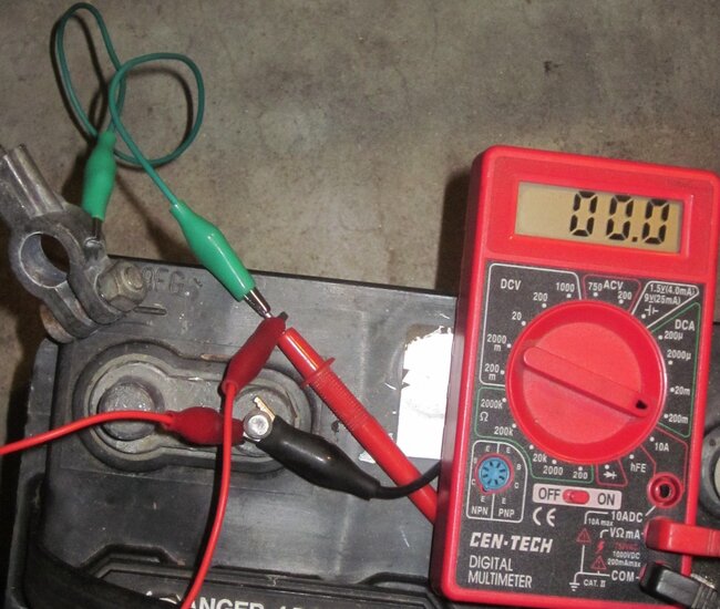

multimeter shows no drain when test by disconnecting negative post and using multimeter between post and cable when set to volts or millivolts, but after 4 days of inactivity, my battery goes from 12.56 volts to11.5 volts. Battery is new and been replaced with another new battery with same result.

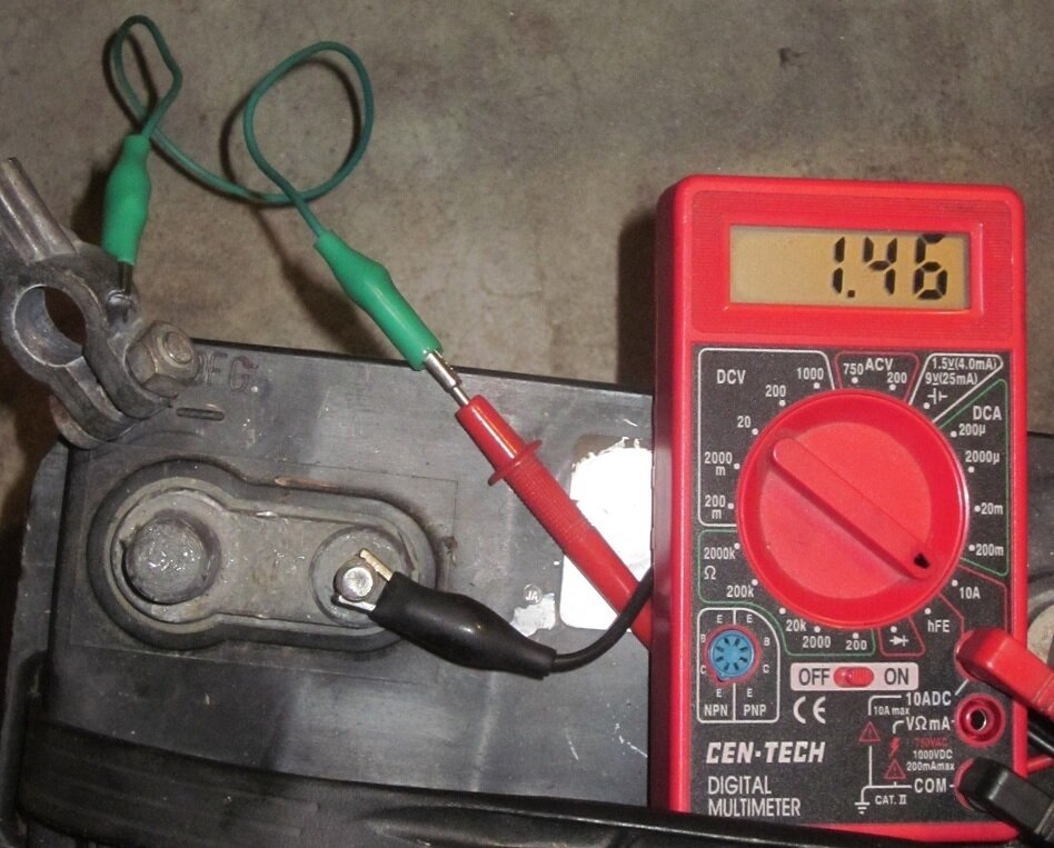

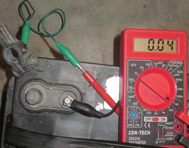

Starting with the first photo, the meter and red probe are on the 10-amp range. Current is 1.46 amps. That's too high to measure on the next lower range. After the computers have timed out in the second photo, current has dropped to 0.04 amps. That can be measured on a lower range, but that requires removing the red probe to move it to the center jack, and rotating the switch. Both actions will break the circuit and wake up the computers.

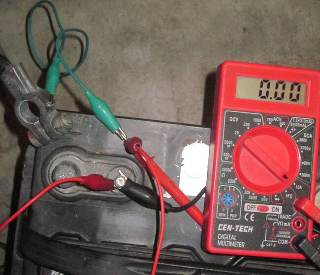

The solution is shown in the third photo. The red jumper wire has been added between the two meter probes. Current flow takes the path of least resistance, so it goes through that jumper wire instead of the meter. That's why the meter is showing 0.00 amps. As long as that jumper remains in place, it's okay to move the probe and turn the range switch. In the fourth photo, those changes have been made, but current is still flowing through the red jumper wire, so the meter still shows 0.00 amps.

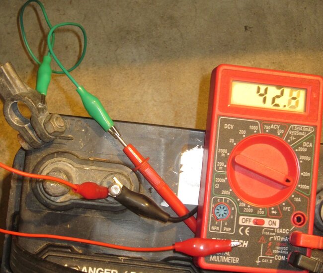

Finally, in the fifth photo, one end of the red jumper wire has been disconnected. Current has to flow through the meter now, and it's showing 42.8 milliamps. This range can measure up to 200 milliamps, (0.200 amps), but it has more accuracy than the ten-amp range. If this current would drop even more, as in below 20 milliamps, the next lower range could be used. That would provide another decimal place to the reading for even more accuracy. To do that, reconnect the jumper wire again, rotate the range switch, then disconnect the jumper.
