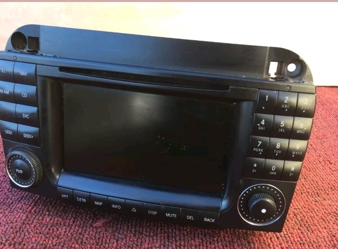

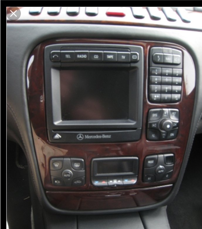

Dear,
Recently I replaced the old stereo that has Japanese language with a newer one with screen but still original as you can see from attached pictures, should disconnect it and see if the battery drain again.
Before I replaced the stereo there was no battery drain.
Thanks

If you did not have to cut and splice any wires and the radio works correctly then I would not focus too much on it. Run the test using the multi-meter if you can and you'll find that problem circuit in fifteen minutes.

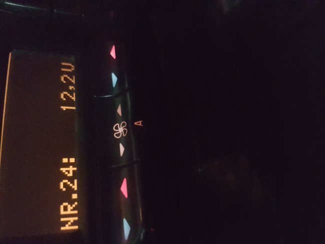

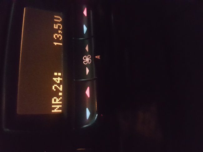

Well, I have replaced the battery again with new MB battery, and I left it now two days without starting it, now I start the car and it starts normal. I checked the voltage reading shown in the picture attached, will see two more days and let you know.
Thanks
Sep 30, 2018 at 1:09 PM
  • 54,832 POSTS
Maybe the first battery was bad and the car will be okay. Time will tell please let us know.
