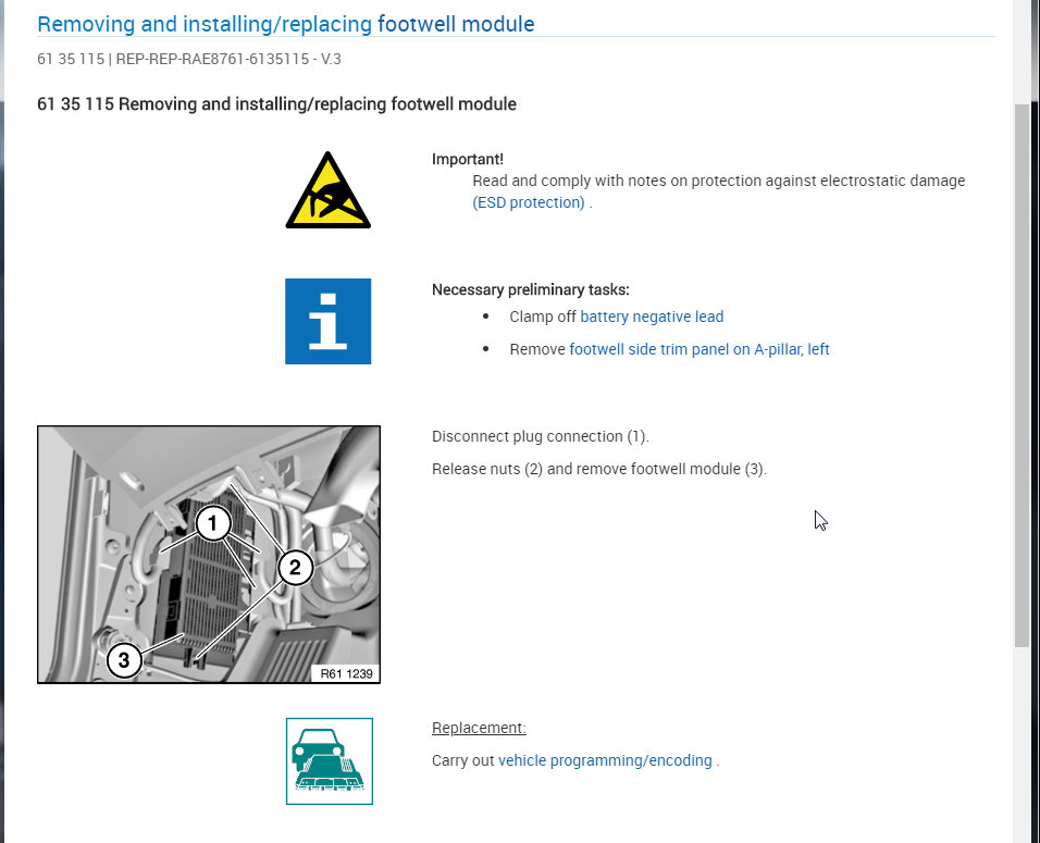

I have placed a test light between the negative cable and the negative battery post. I then removed one fuse at a time. The light never went out. Please explain more about the body module and where it is located. Thank you for your interest and help with this problem.

The footwell module has been replaced and program.
Tuesday, September 22nd, 2020 AT 6:56 AM
  • 109,885 POSTS
Is the module what was causing the battery drain?
Tuesday, September 22nd, 2020 AT 6:31 PM
MAILIBU1955
  • 76 POSTS
Yes, replacing this module did correct the problem. Thank each of you for your help.
