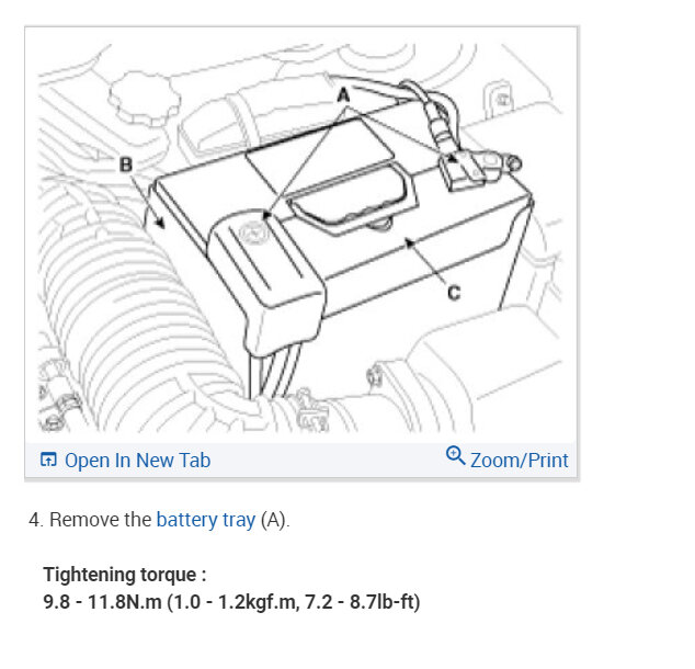

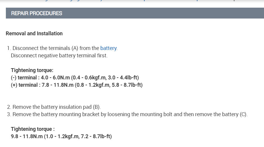

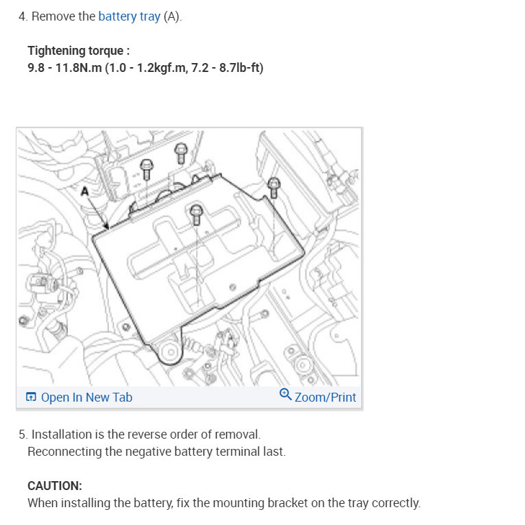

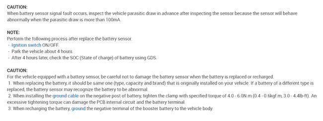

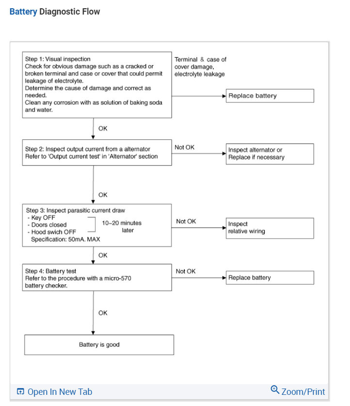

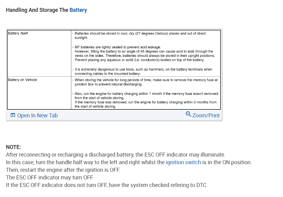

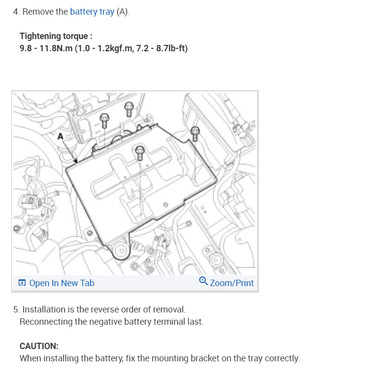

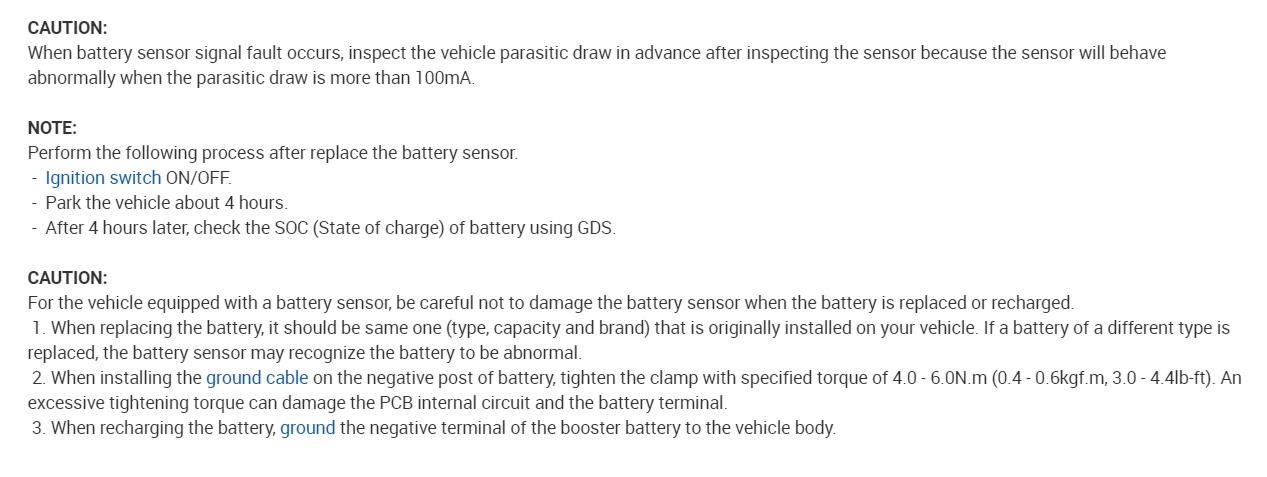

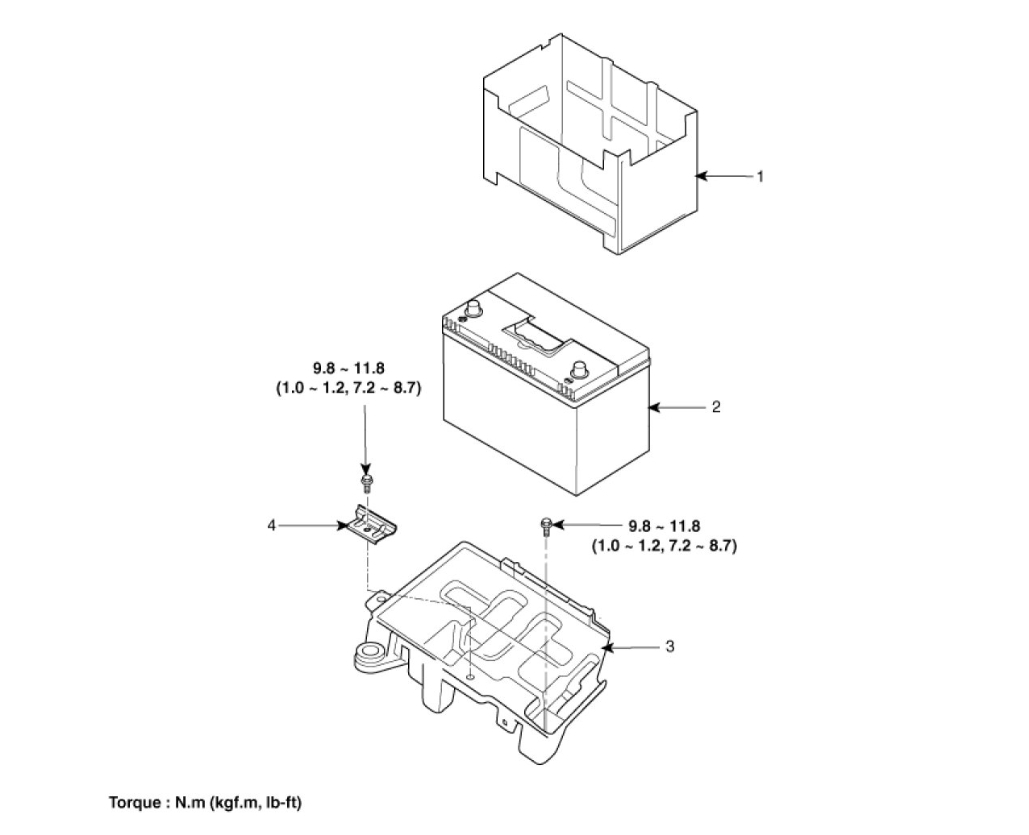

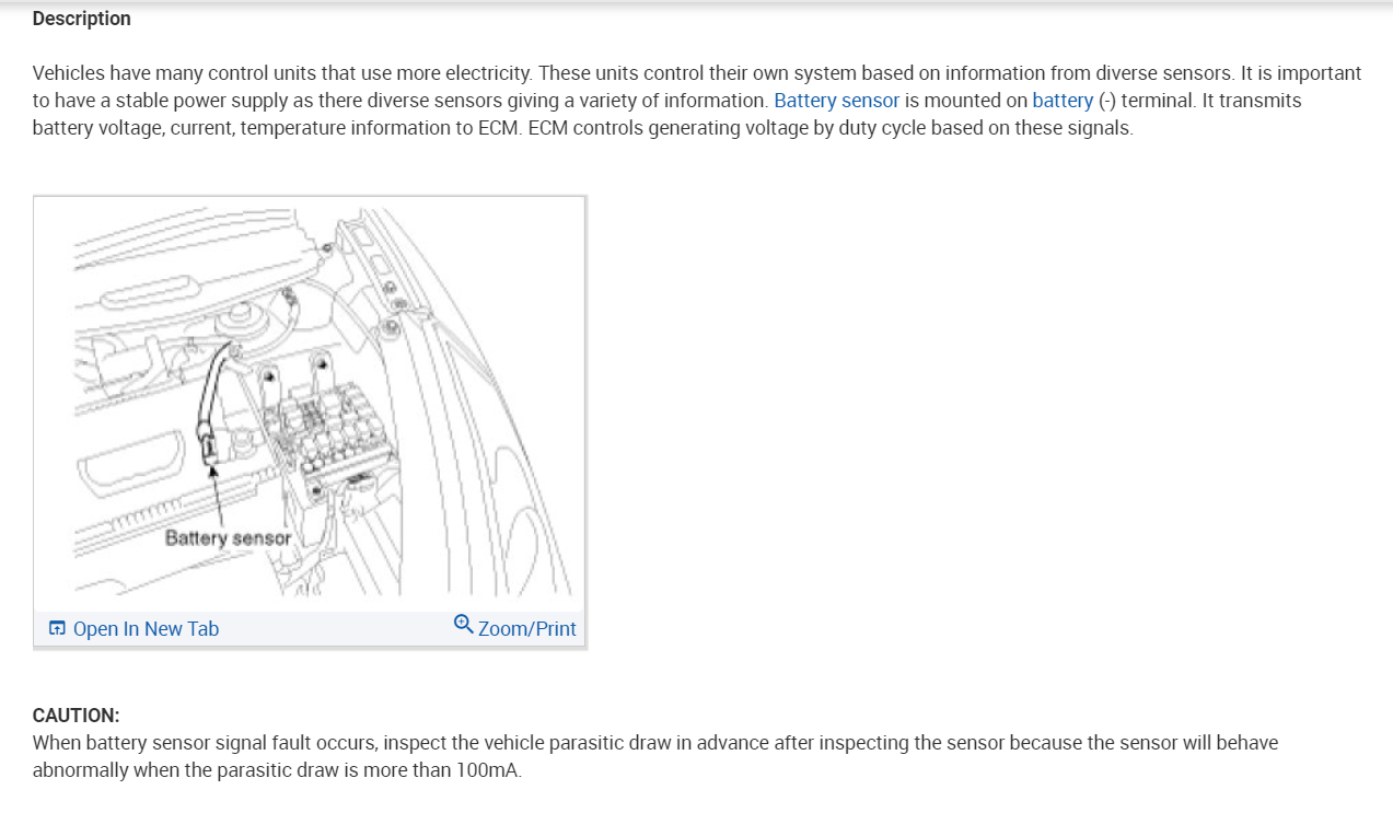

I am not sure what you want to do here, test the battery or replace it? It doesn't matter what spec the battery is if it fails the load test. Here is the information we have for the battery. There is a battery sensor at the battery cable. Please check the images below for more information.

Check out the images (below). Please let us know if you need anything else to get the problem fixed.
