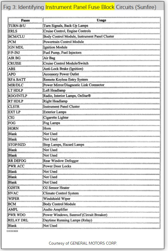

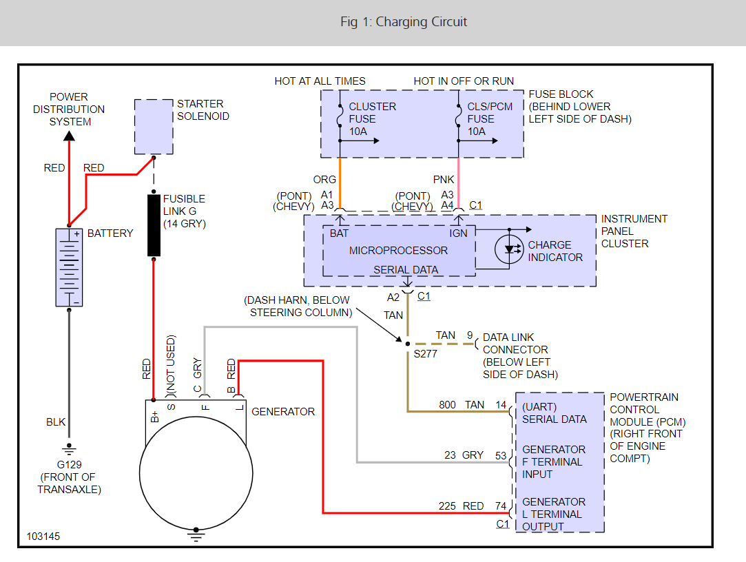

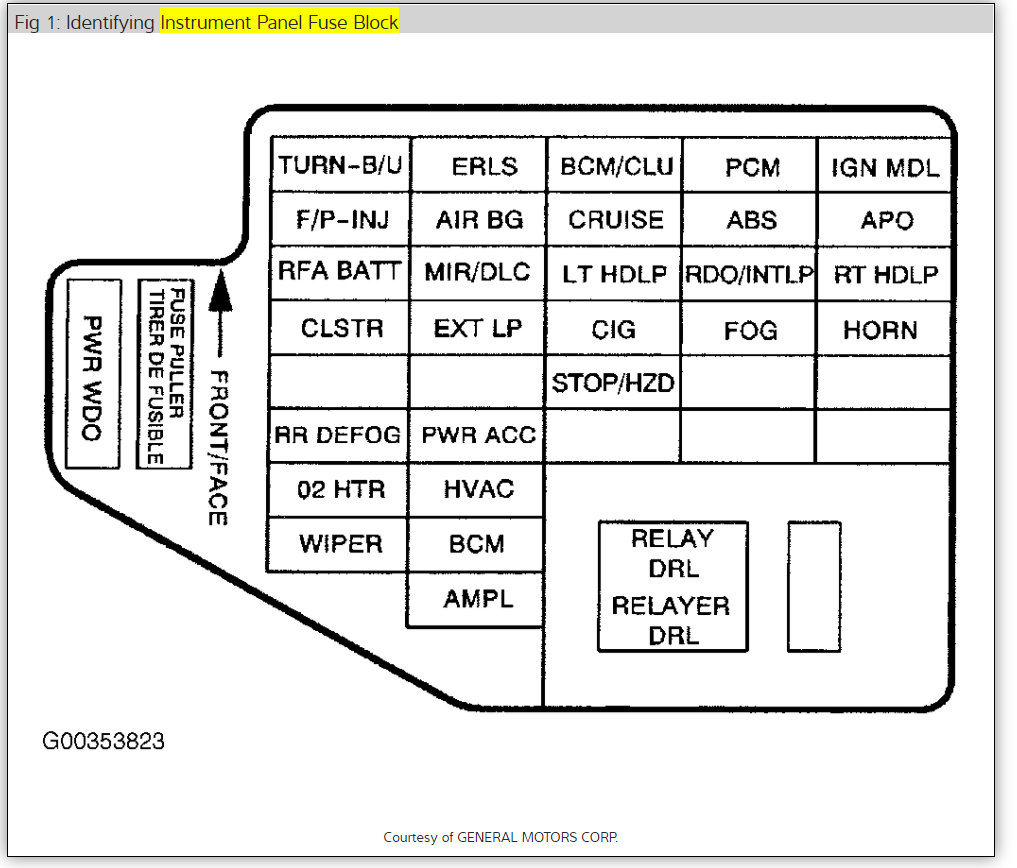

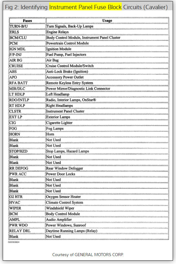

Hello, my car shut off the other day and the battery is bad. The alternator was borderline at 12.8 volts at the battery. So I replaced all and the battery light is still on. Checked voltage and now between 13.7 and 14. I checked the fuses and shorts etc., but cannot find.
Oct 25, 2018 at 3:05 AM
  • 55,808 POSTS
Lets check for power at the fuses, cluster and CLS/PCM in the passengers fuse panel here is a guide and the alternator wiring diagrams so you can see how the system works.
Check out the diagrams (Below). Please let us know what you find. We are interested to see what it is.
