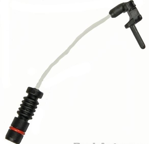

I would think with that description all it likely needs are new brake pads and the wear sensors replaced. The lower pedal is because the pads are worn and the lights are on because the wear sensor(s) are triggering that the pads are worn. They are nothing but a plastic piece with a small rod inside connected to the brake system, as the pads wear the plastic wears as well, When it wears to the point the rod is exposed it completes a circuit through the brake rotor telling you the brakes need to be serviced. The fact that it doesn't come on with a light pedal but does under heavier braking shows that there is some flex in the brakes (totally normal) and they are just starting to touch. That should mean a standard brake service with new pads and possibly rotors if they are worn but with 32K It would depend on how much it was actually driven as the rotors could be failing from rust and not just wear.

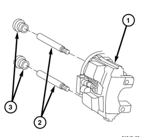

The fronts have the wear sensors so we will start there. Jack up the car and remove the front tires (or tire if you want to do them one side at a time. Secure the car on a stand, not the jack. With the tire off the brake caliper will be in front of you, It is retained by the metal clips, those pry off, Use a pry bar to force the caliper out and push the piston into the caliper. Now disconnect the wire in the top center of the pad for the wear sensor.
Next you need to remove the slide pin caps and then the caliper slide pins. Set those aside. The caliper will now slide up out of the mount. The pads can now be removed. With them out of the way clean up all of the points the pads touch on the calipers and mount with a wire brush, file or sandpaper.

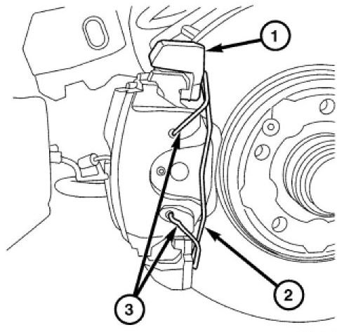

Now lube the pads and caliper where they rub on the bracket and each other, use a silicone brake lube. Place the pads on, then the caliper. Install the new wear indicators into place and then take the slide pins and clean them, then apply some lube to those and install them, They are tightened to 18 ft lbs.
Reinstall the caps. Now use the new caliper anti rattle springs and install those the way the old ones were. Plug the wear sensors back in.

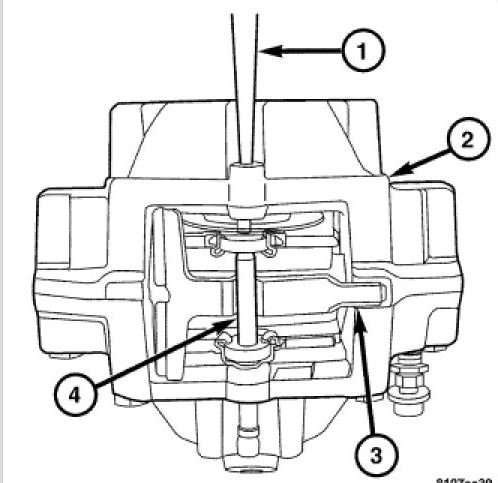

Time to do the rears, These are a bit easier as you only need to remove the mounting bolts, then use the pry bar to compress both pistons. Now lift the caliper up and knock out the pad retaining pin that also releases the anti rattle clips. Remove the pads. Clean the rubbing surfaces and apply brake grease. Install the new pads and clips and then tap the pin back into place so it holds the pads and the clips. Then put the caliper over the rotor and reinstall the bolts, They are tightened to 41 ft lbs.
