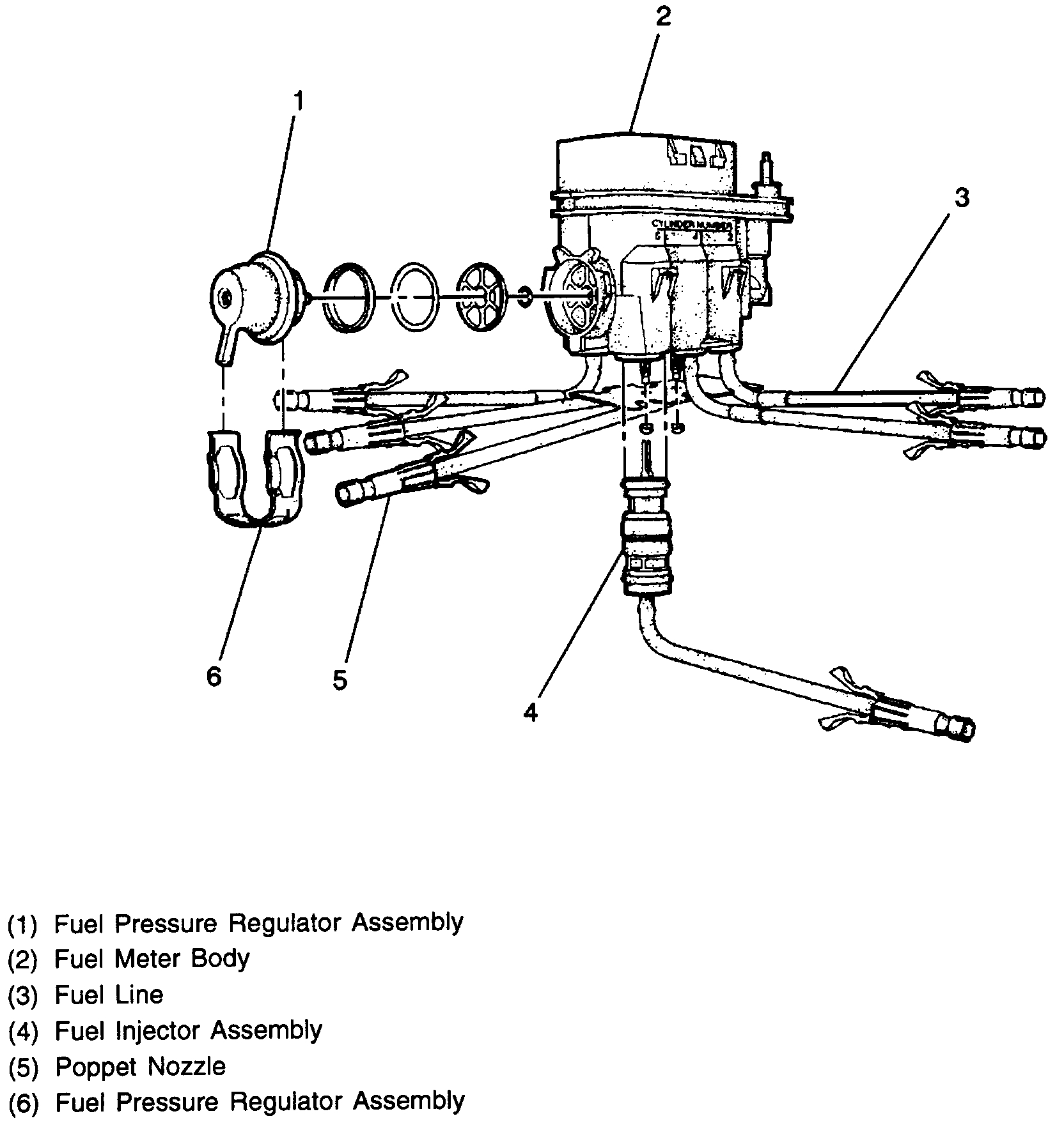

After thought. See if you can turn the engine by hand. If you cannot remove the spark plugs and try. I question if he filled the cylinders with gas. Check to see if the engine oil smells like gas. I attached a picture of the regulator. Did he put everything back together with it correctly?

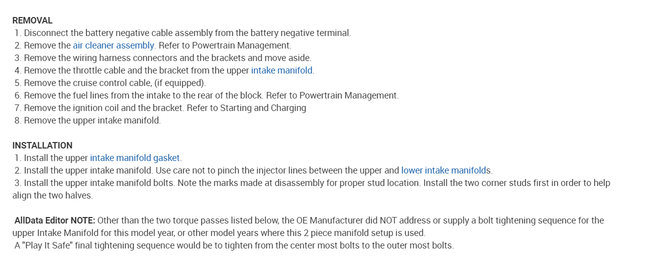

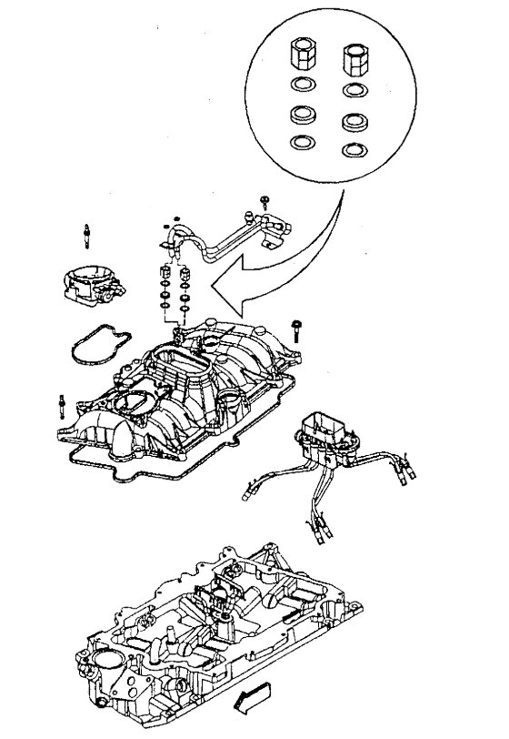

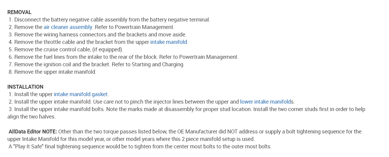

Yep, there is a seal that goes back there to stop vacuum from leaking. Can you take the upper intake back off to inspect? Here are diagrams to help. Check out the diagrams (below). Let us know what happens and please upload pictures or videos of the problem.

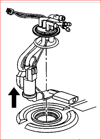

For starters I have to apologize for my stupidity on this. The suction noise was coming from the fact that the vacuum hose going to the brake booster did not have its hose clamp. So the next thing I did was borrow a fuel pressure gauge from the parts store. Since my original problem was still there. This is what it read: turn key on- 58 psi for two seconds then 20 psi, start engine 52-54 psi, then sometimes it drops into the twenties and shuts off. I assume that means the fuel pump is the culprit?
Aug 23, 2018 at 7:58 AM
DANNY L
  • 5,648 POSTS
Hello, I am Danny-
Yes, it sounds like your fuel pump is on its way out. It should maintain 50-60 P.S.I at all times. To gain access to the in-tank pump you have to remove or drastically tilt the truck bed to gain access. Hope this helps and thanks again for using 2carPros.
