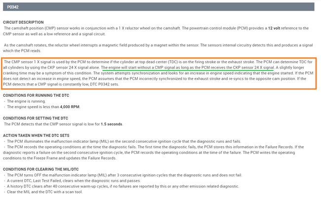

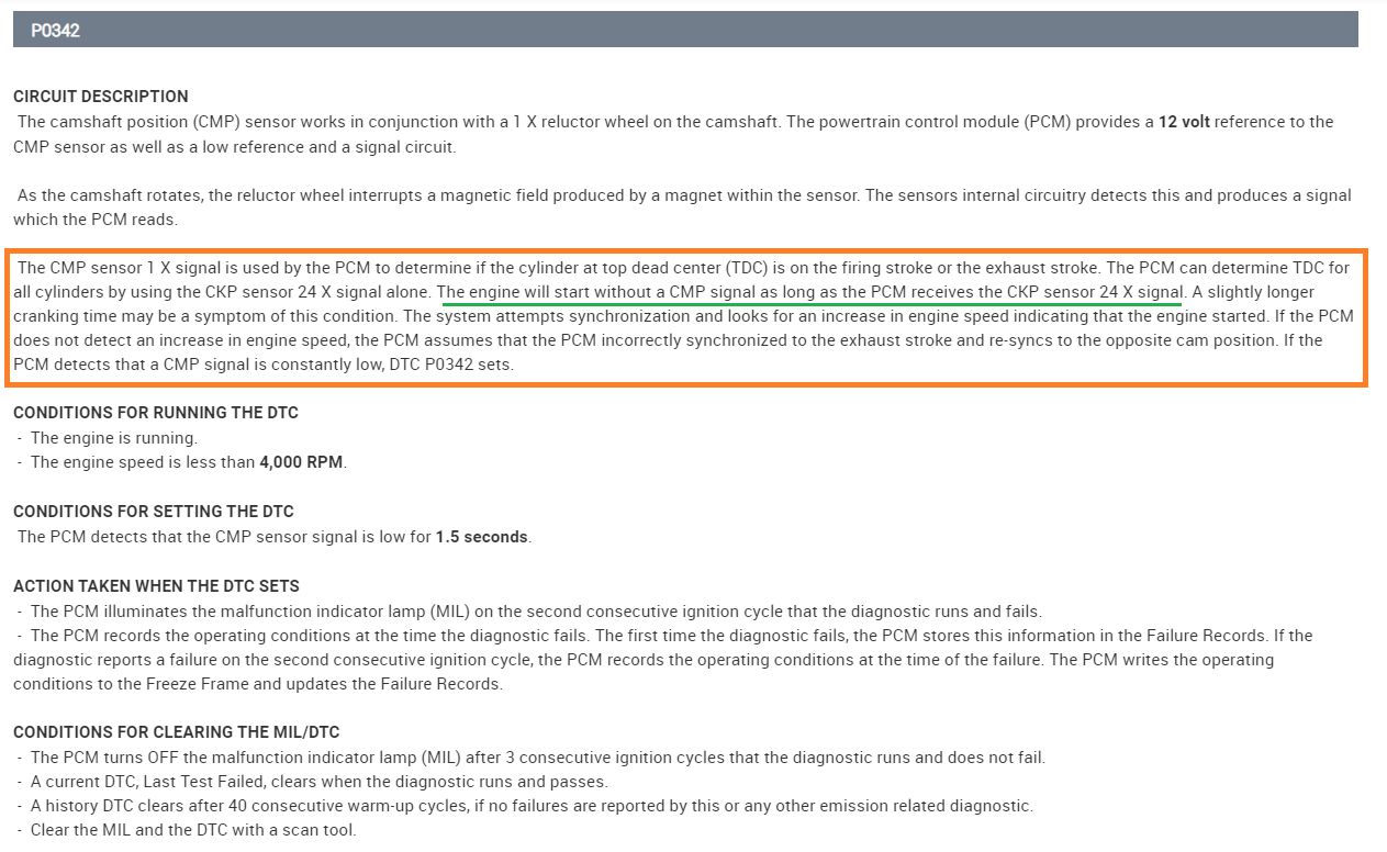

Hello, the fact that the vehicle won't start points more to a crankshaft position sensor than the cam sensor. This vehicle will start without a cam signal, it will just have an extended crank, but should run. This code sets when the cam and crank synchronization isn't correct. I'll post the code criteria for you.

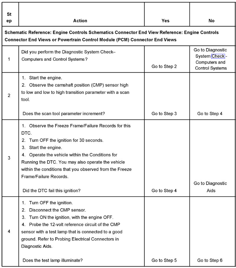

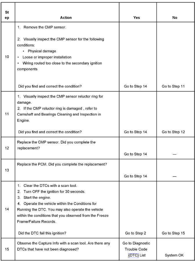

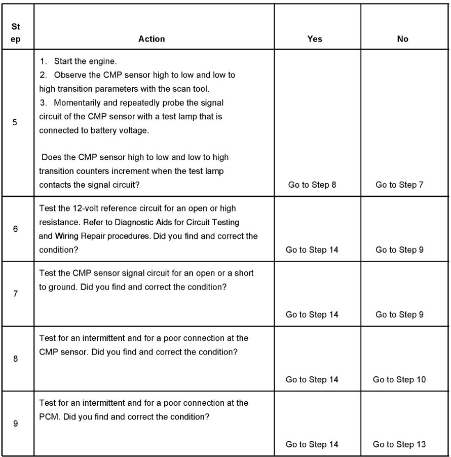

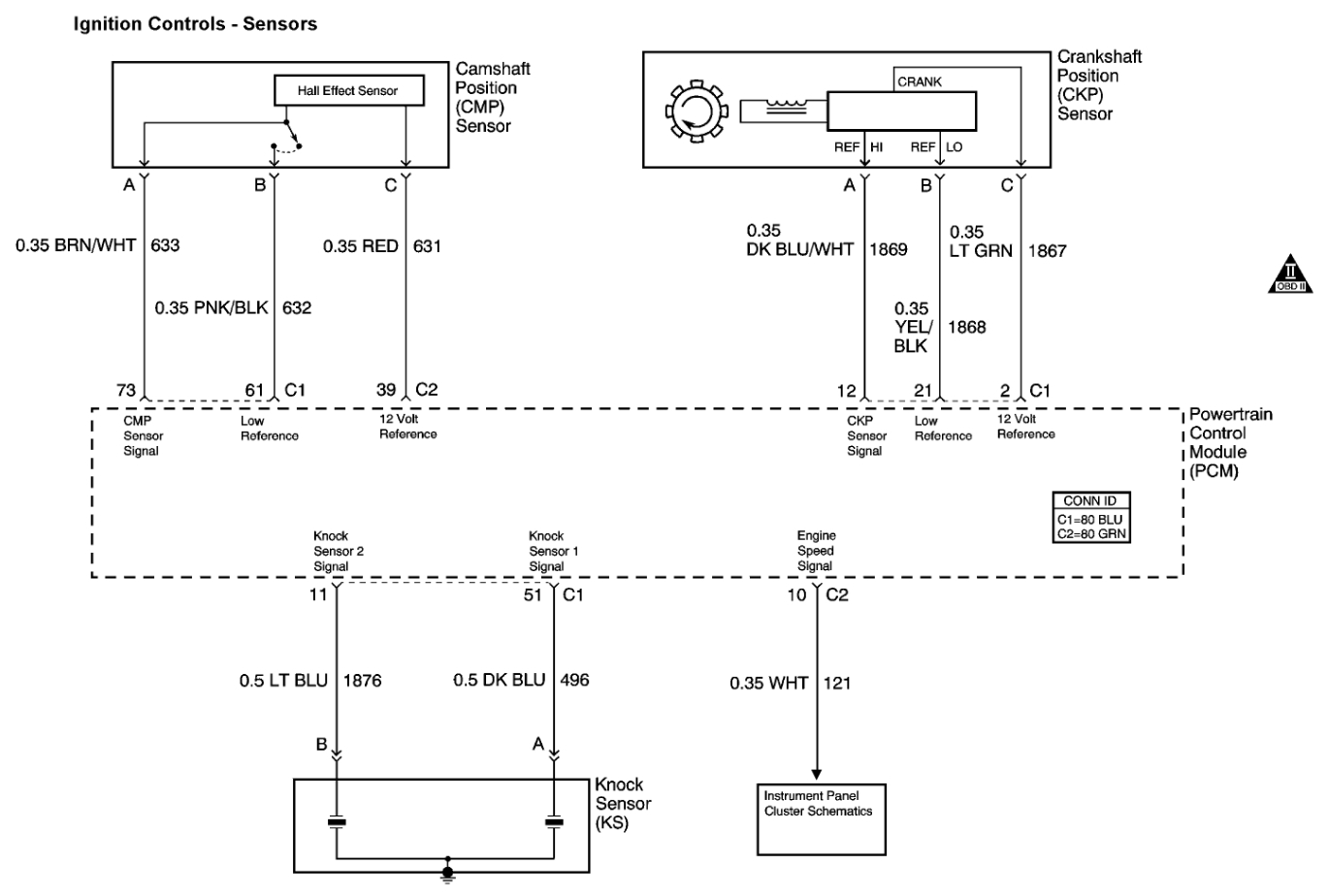

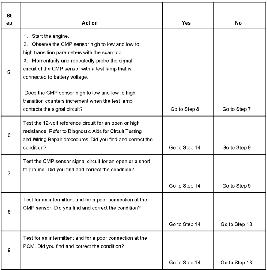

Yeah, it's the lack of crank and cam sensor sync that sets this code. Backfiring also points to timing being off. The cam sensor is just a 1 tooth signal on this vehicle for the number 1-cylinder top dead center. The crank sensor is a 24x where the PCM can identify each cylinder TDC, so that's why they can run without a cam signal. But if the sync fails, the PCM will keep trying. But I will post the flow chart for this code as well, you can go through the testing
Do you have live data on your scan tool for the PCM?
Diagrams 2,3,4 below are the flow chart for that code, and I'm also going to post the power and ground pinout diagrams for the PCM, they should all be checked before condemning the PCM. This computer has quite a few power feeds and grounds. A bad ground or corroded connector can cause this type of issue as well, especially with the vehicle's age and mileage. GM used frame to body grounds on these that didn't last long. You can do a voltage drop test with the key on from the battery negative post to the engine block, then to the frame/body and see if there are any large voltage drops across the grounds of the vehicle. Check the ground straps under the frame rail as well, if they are falling apart or are green with corrosion, they are no good.

Refresh this page, I just posted information on my last post, I'm getting the PCM connector pinouts for you as well so you can check them, if you have a test light, which would be the best way to check the PCM connectors because it puts a small electrical load on the circuits. I'll explain that further when I put up the PCM diagrams.

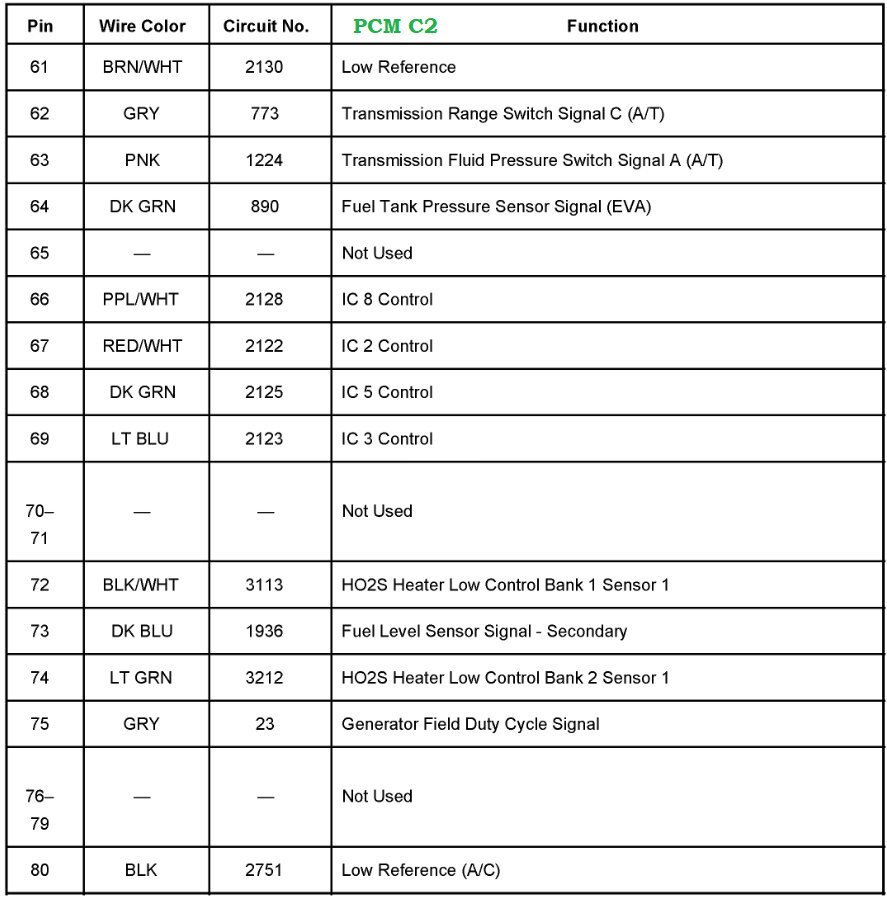

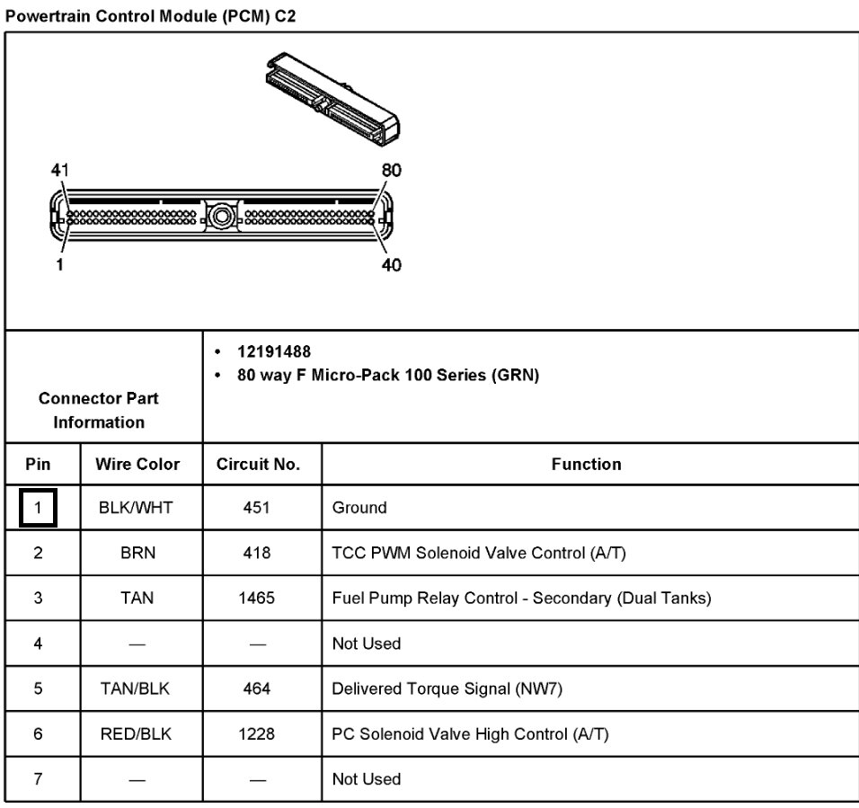

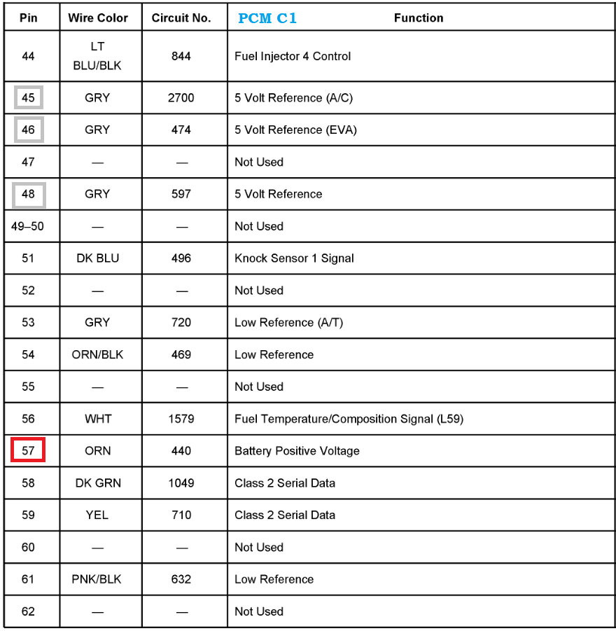

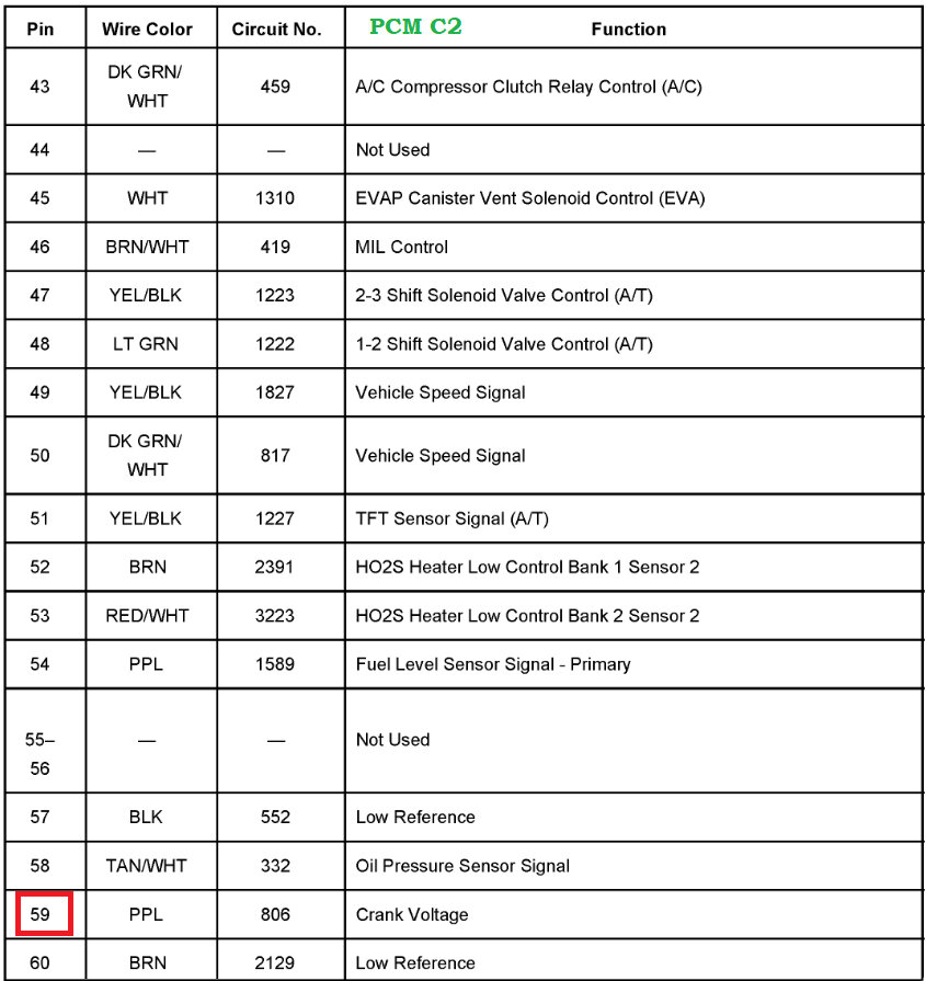

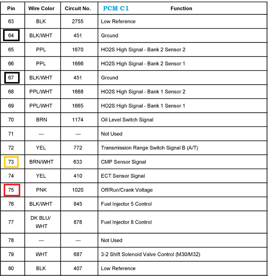

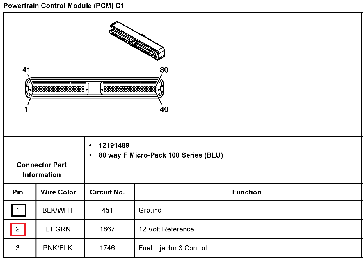

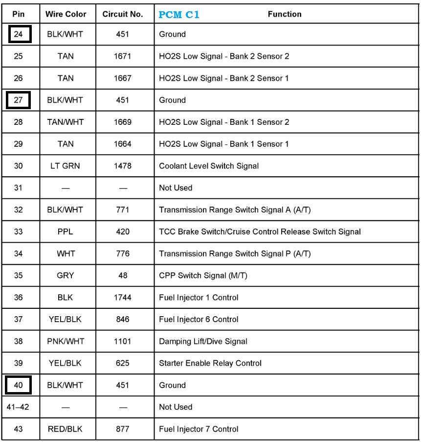

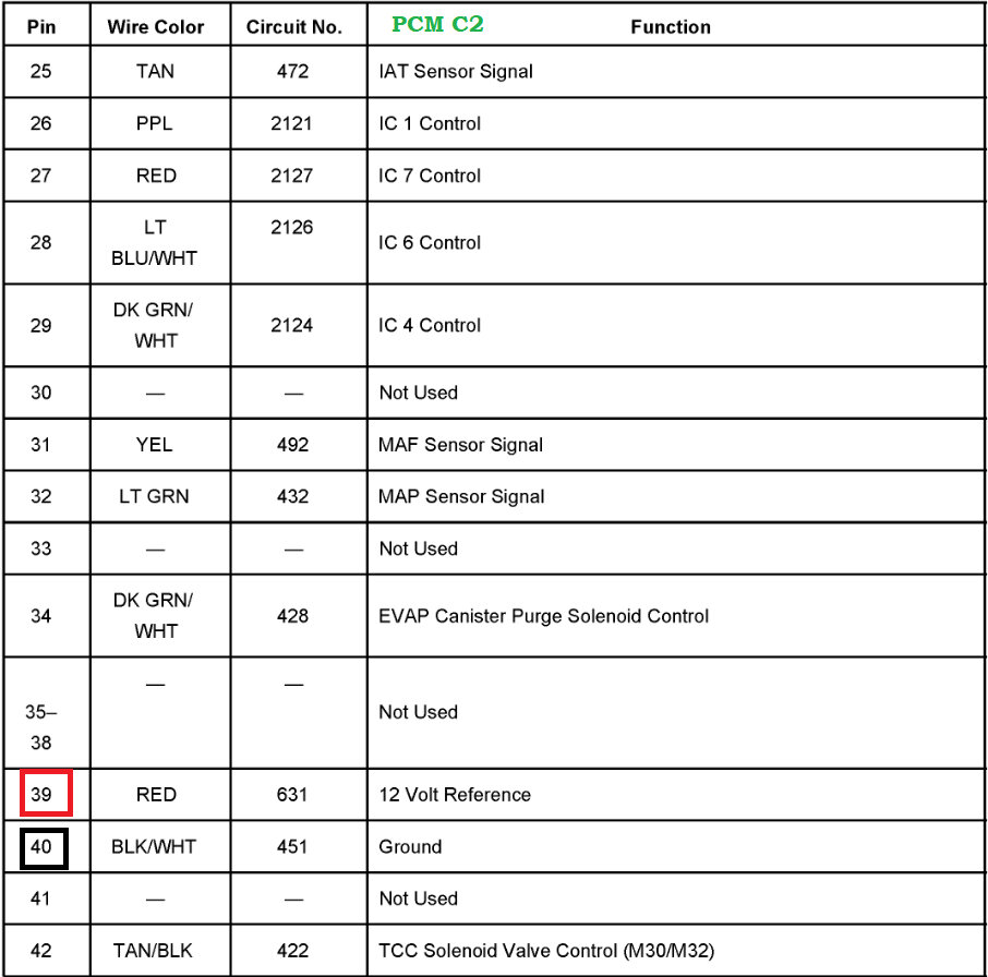

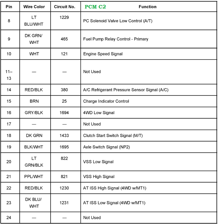

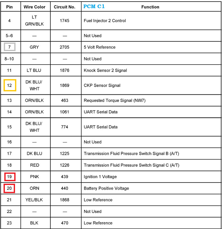

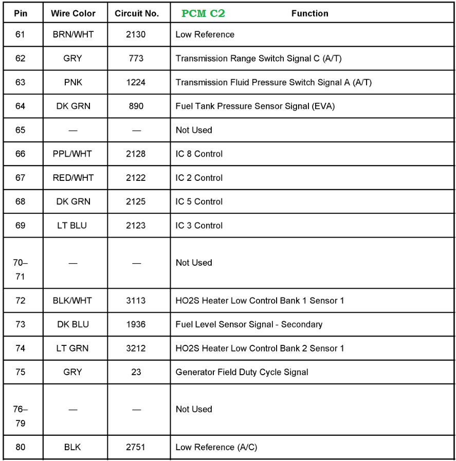

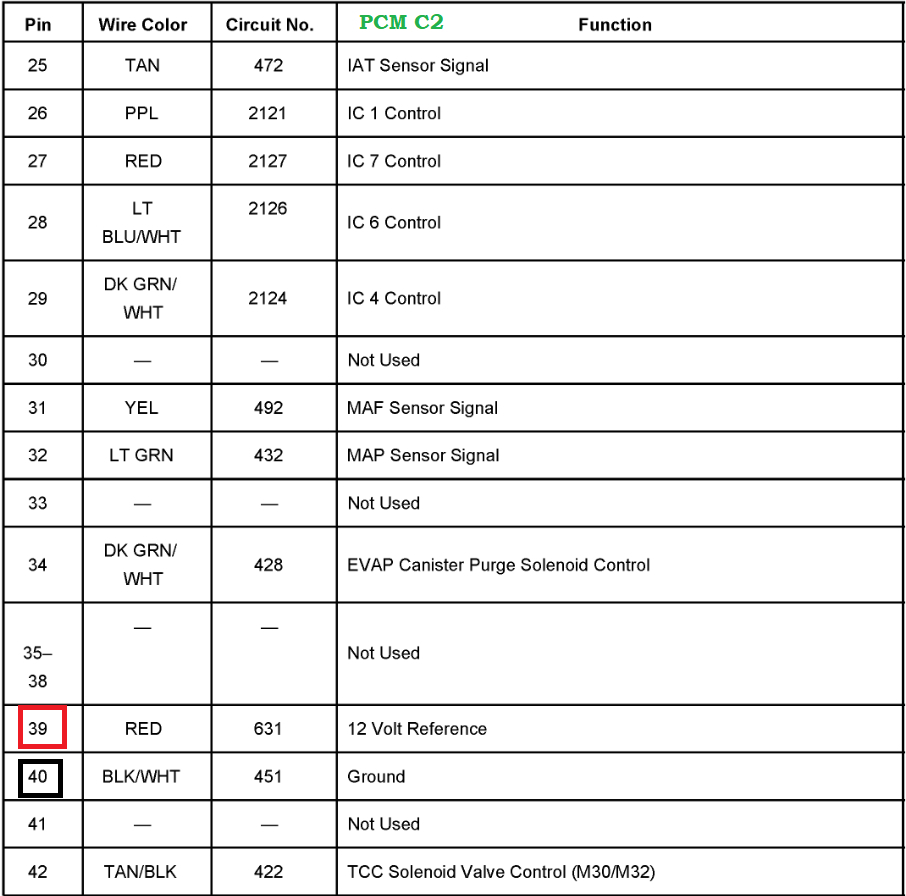

Okay, below are the PCM connector diagrams C1 and C2, all the 12v feeds and 12v References going out to sensors are marked in Red, the Grounds are marked in black, and the cam and crank pins are marked yellow.
The 5v reference voltages going out to sensors is marked in Grey. They feed the MAP, TPS, ECT, etc. You probably won't need to check those since the cam and crank use 12volt Reference feeds, they are in diagram 11.
If your vehicle has a Tachometer, that can be another clue as to the crank sensor dropping out. After the stall is out, and before you clear any codes, you can watch for the Tach to jump while cranking, if it doesn't move during the no start condition, which is a sign the PCM is not receiving an RPM signal.
When you go to check powers at the PCM, make sure the key is Off before you unplug the PCM connectors, check them for corrosion as well. With the first connector unplugged (C1), hook the test light to battery negative and just touch the PCM pins in the connector that should have 12volts and the test light should be bright. Some pins will be powered all the time and others will be key on power, but make sure the key is Off before unplugging and plugging back in the PCM connectors.
Testing the Grounds, do the opposite, hook the test light to battery positive and touch the ground pins, again the test light should be bright. Just don't jam the test light into the connector pins because they will spread and not make contact after plugging them back in.
The voltage drop testing is done with a multimeter set on DC volts, PCM plugged in, and Key on.
Battery negative to engine ground and to frame and body ground. There should be less than 1v drop.

What brand of cam sensor did you install? Was it an OEM part from the dealership? There have been many bad aftermarket parts the last few years but check the wiring to the crank sensor as well, it's a 12v feed, ground, and signal, the same as the cam sensor. If the crank sensor is shorting out, it might be pulling down the cam sensor signal with it. Even though the 2 sensors have different 12-volt feed pins from the PCM, they are most likely a shared 12-volt Reference internal to the PCM, that might be why its setting this sync code. They tend to do the same thing with the 5v Reference for the other sensors, they use one voltage regulator inside the PCM, and this saves on circuit board components.
This code is kind of unique, the code sets if the PCM sees the cam signal constantly low, but that should not cause the no start or stall out. I'm surprised it's not setting any other codes.
You can try clearing the code, turn the key off, unplugging the cam sensor, and see if the engine starts, technically it should with an extended crank. See if it sets another code besides the p0342.
