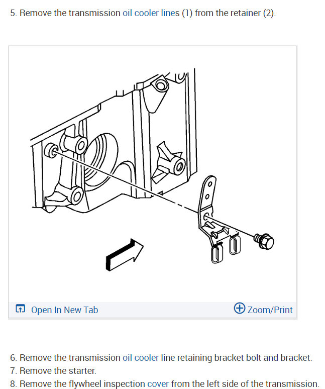

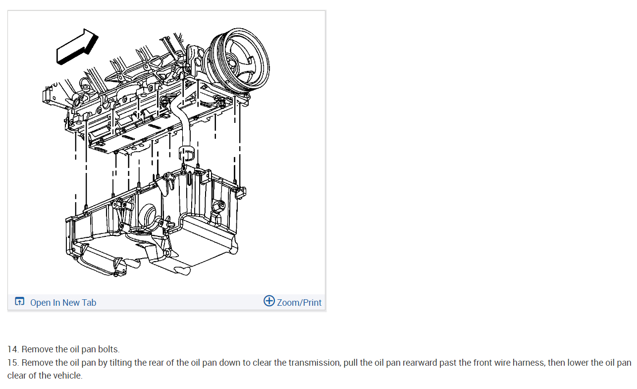

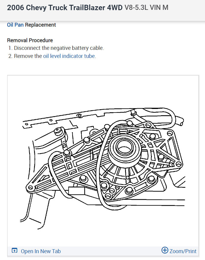

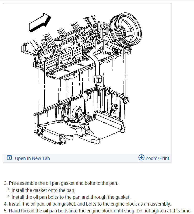

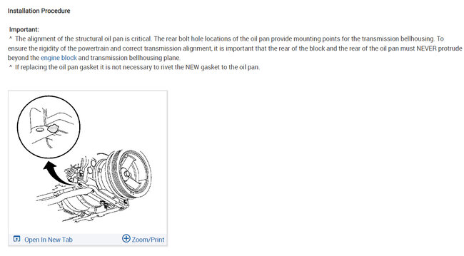

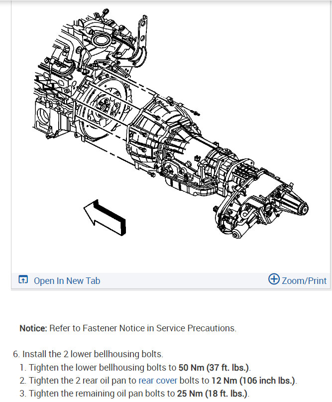

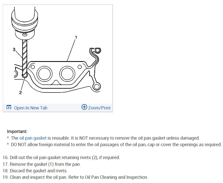

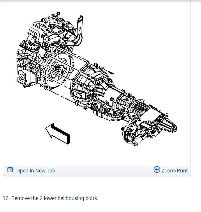

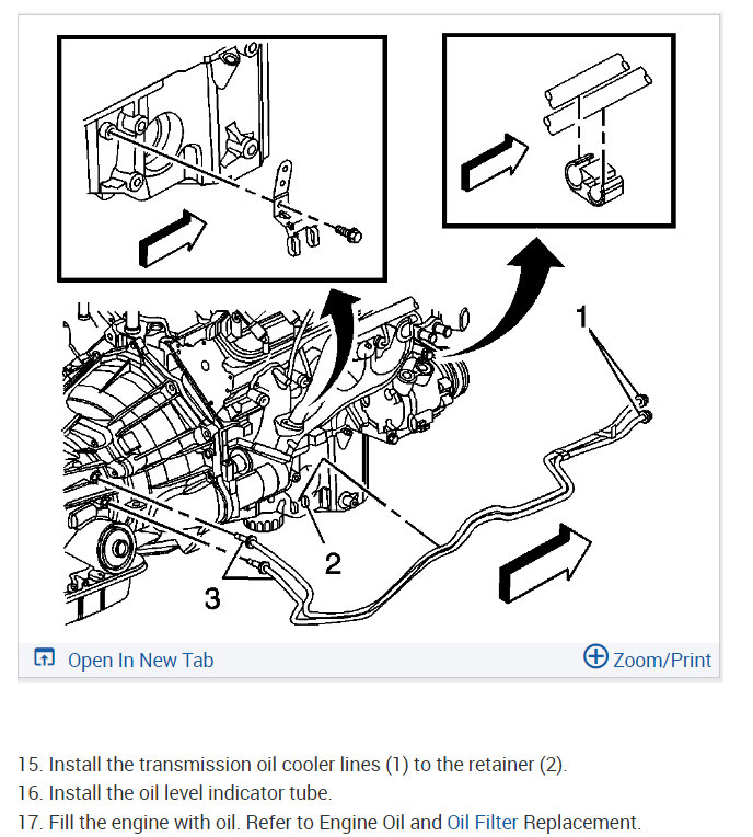

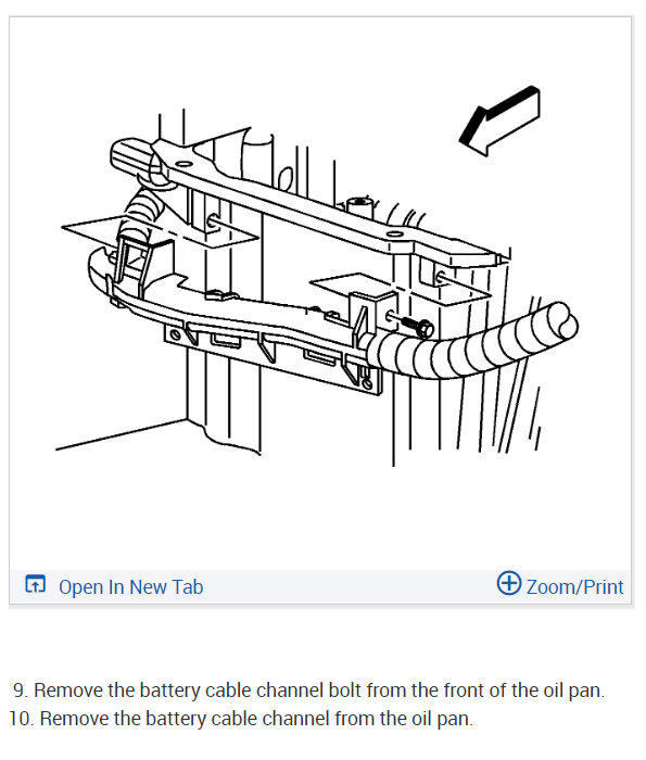

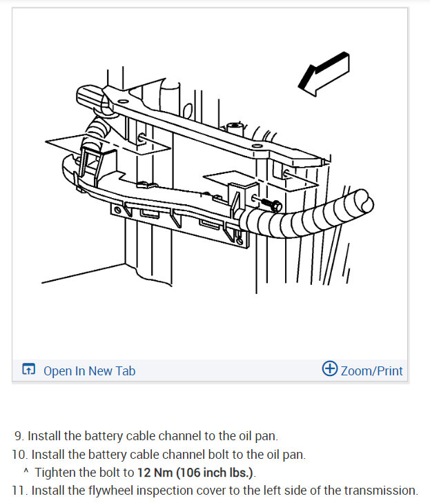

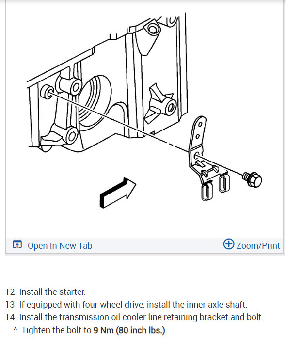

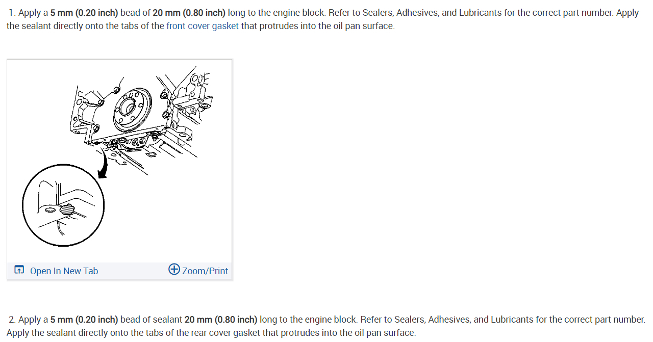

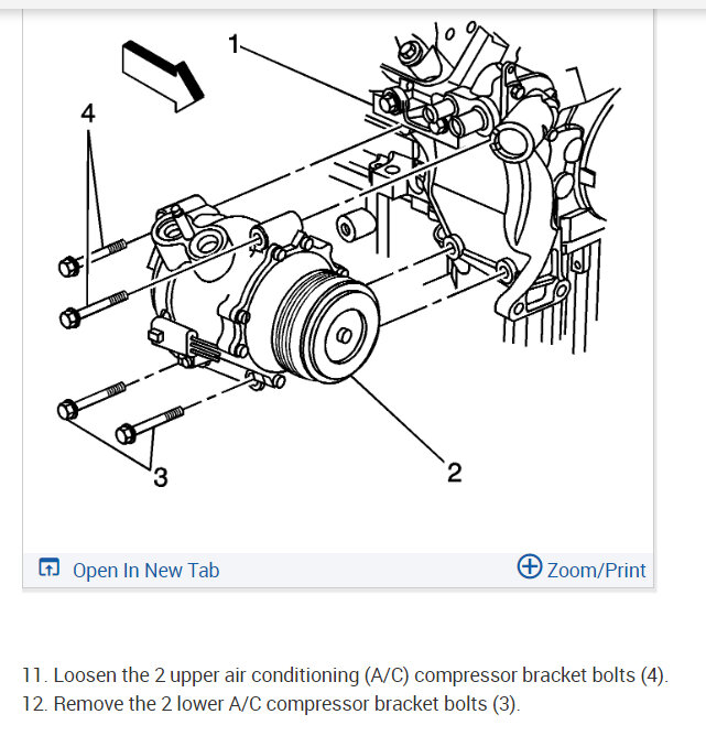

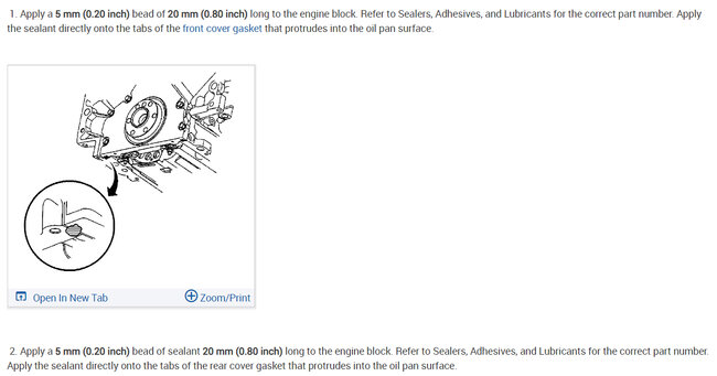

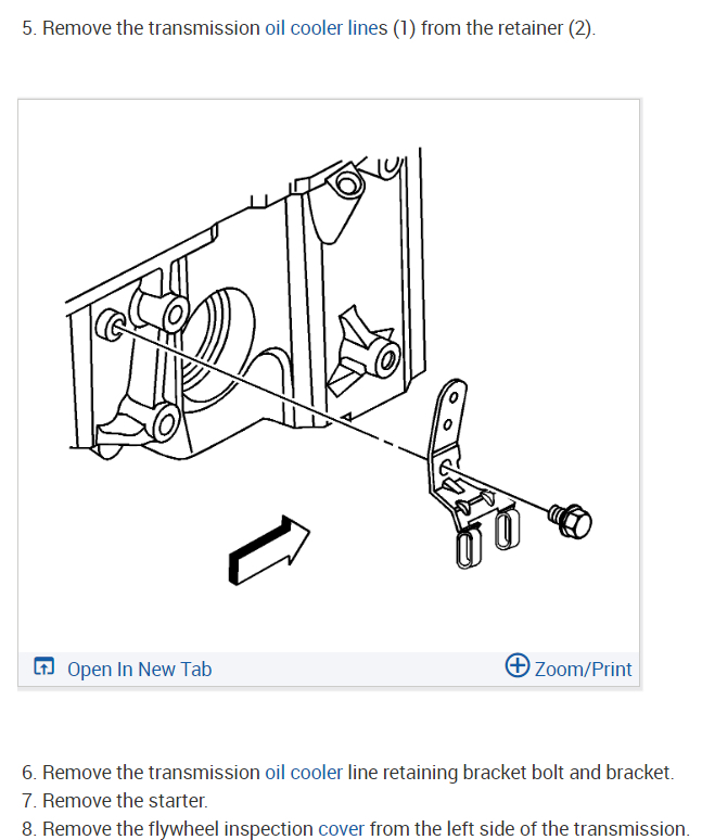

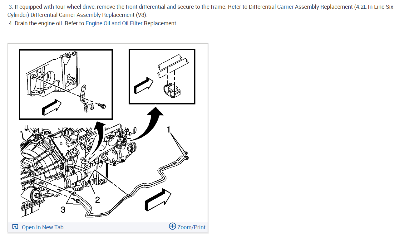

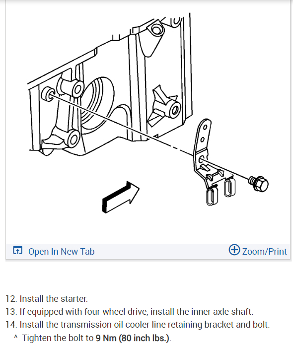

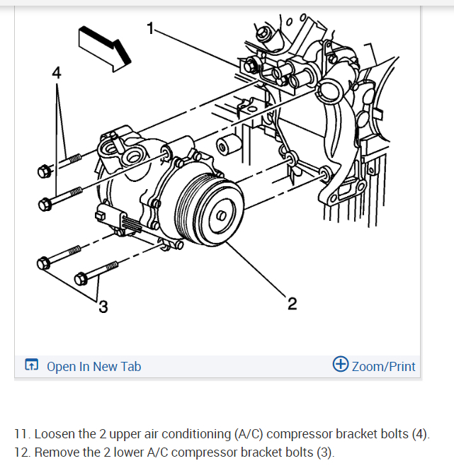

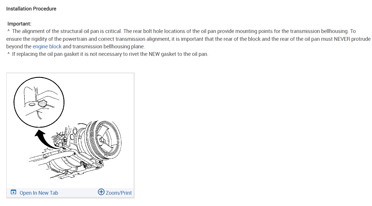

Yes, you could have a bad cluster and a clogged oil pump pick up. I would remove the oil pan to inspect the oil pump pickup, also you can try a manual oil pressure gauge which you can rent from the auto parts store to confirm the problem. It is inserted where the oil pressure sender goes. Here is how to remove the oil pan. Check out the images (below). Please upload pictures or videos in your response to the problem so we can see what's going on.
