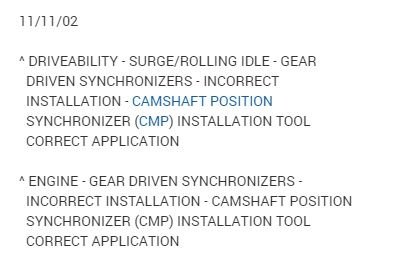

did you reinstall the cam syncro and time it correctly?
the 2 codes are for the cam timing off. This is why I asked if you timed it correctly. There is a special tool for aligning the syncro.

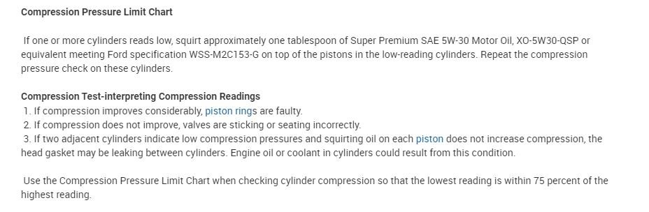

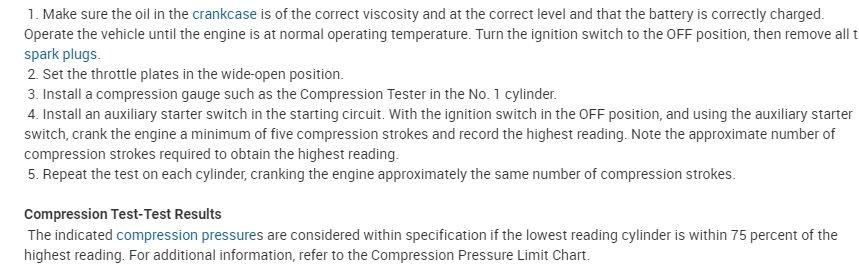

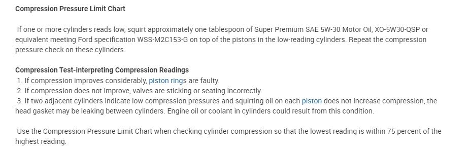

Did you do a compression test on all the cylinders for the miss?

You removed the syncro as you stated way back. After that, you set the codes for the cam timing from the syncro set wrong.
I told you that you need to reset the cam timing as it will cause a hard start and erratic engine operation.
The timing chain can be confirmed by checking the compression or using a vacuum gauge to check the engine vacuum.

With the 2 codes, you listed, it is pointing right at the syncro. You could have a bad syncro assembly.
You need to resolve those codes first with either setting the timing or replacing the syncro. It will cause the hard start and the misfire.
