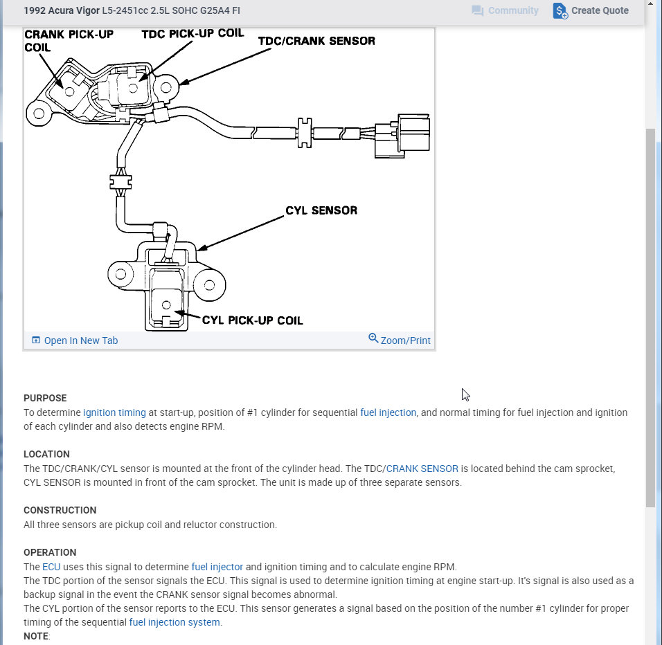

I bought my this vehicle over a month ago and it's still in the repair shop my mechanic is stumped and he cannot figure out what is wrong with it. it will not give him any codes on the diagnostic; is he doing something wrong? All of the research that I've done online points to a possible faulty crankshaft sensor. is it hard to remove and replace that in my car? I have a Chilton's manual so I'm hoping that will give me some help. my car starts runs for about 5 minutes and then it shuts off and then it will only crank and won't start unless I let it sit for about 1 hour. then it starts right up again but again it only runs for a few minutes and then shuts off.

You are correct that this issue is normally caused by a crank sensor. However, that is when the sensor is a Hall Effect type sensor. Your sensor is what is called a reluctor type sensor. They are not a susceptible to heat as Hall Effect type sensors.
What I would suggest is when the engine cuts off, let's pull a spark plug, connect it back to the wire and hold it against the block then crank the engine to see if there is spark to the plugs. If there is no spark then we can go down this path. If there is spark then it is not the crank sensor.
At that point, you need to spray some starter fluid in the intake to see if it fires. That would point to a fuel issue.
Let me know what you find and we can go from there. Thanks

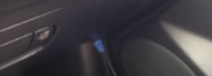

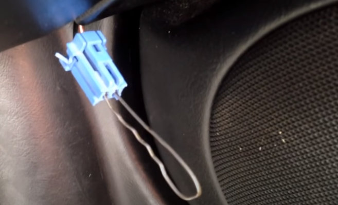

You can pull the codes without a scan tool by jumping the connector that should be on the passenger side next to the center console. Possibly behind the carpet.
Here is a guide on the codes:
https://www.2carpros.com/articles/honda-car-1990-1995-obd1-code-retrieval-procedure-and-definition-table
As for the key, I am not sure your key has a chip in it. I could be wrong on this but even Acura didn't start using it until the early 2000's. Send me a picture of your key and we can go from there. Has this key ever started the engine?
