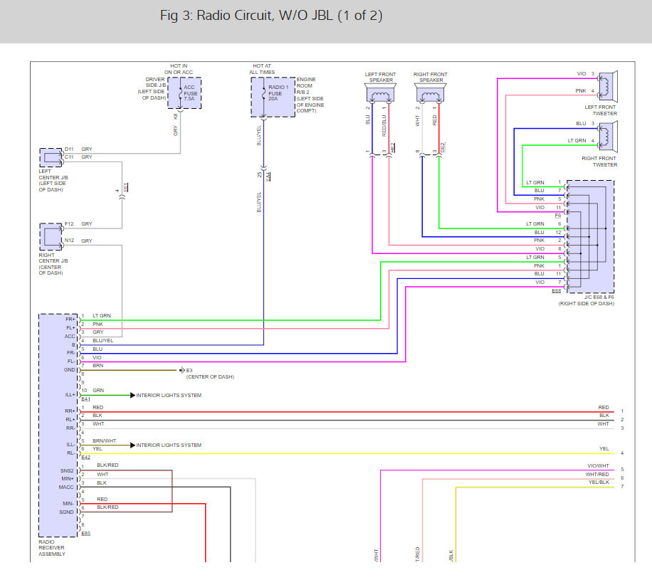

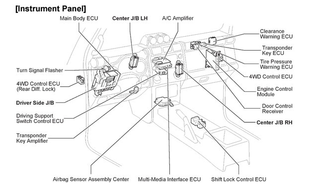

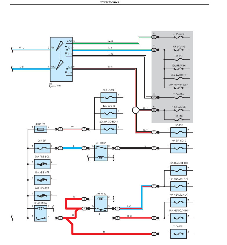

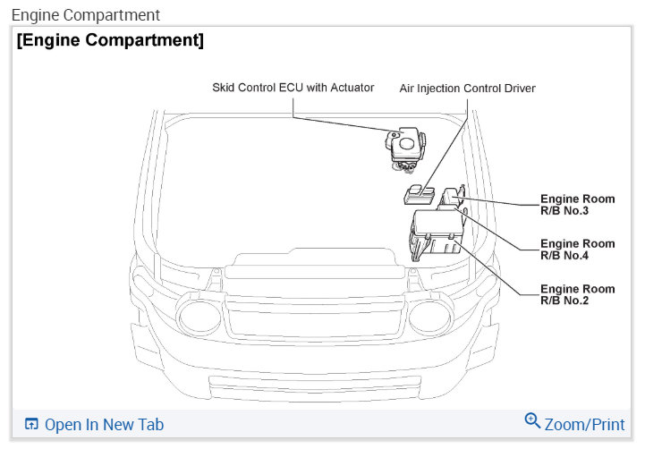

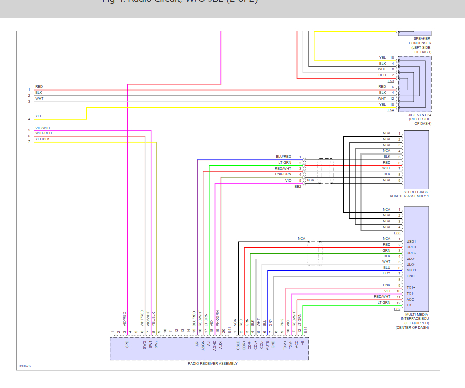

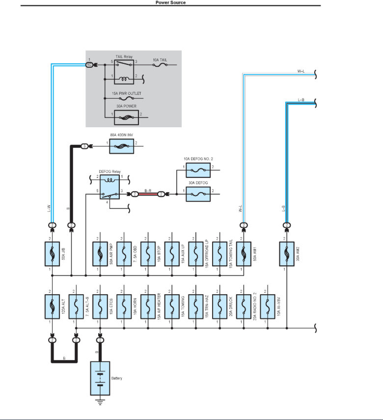

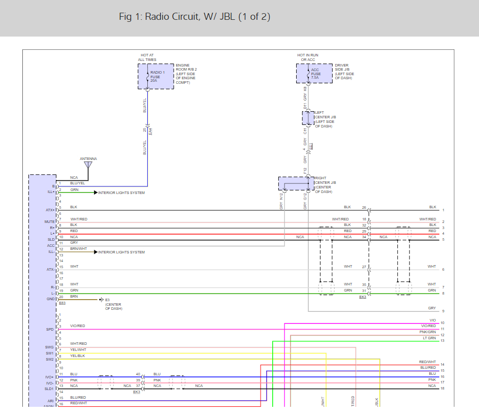

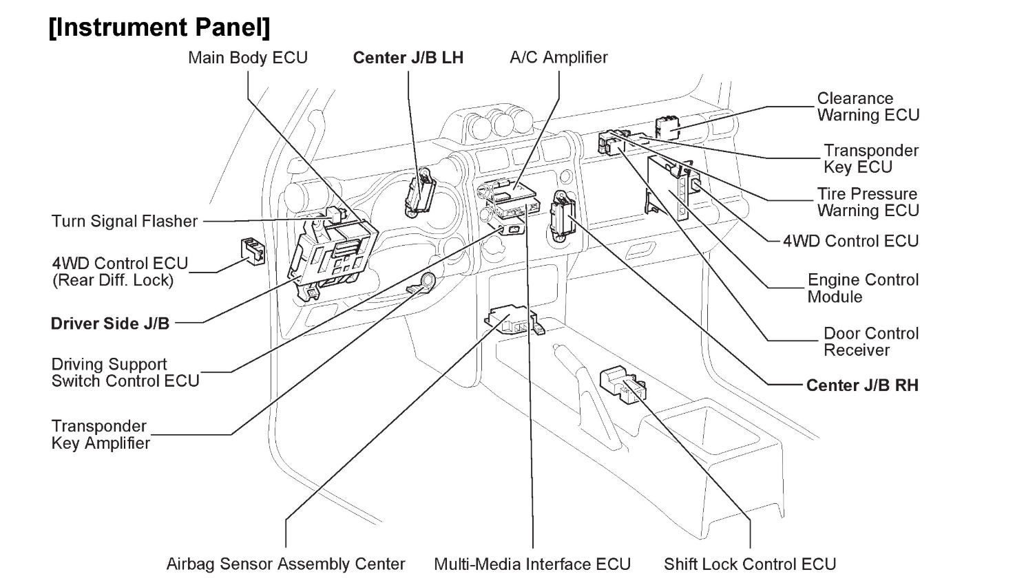

Can you check for power at the IG1 fuse at the drivers side fuse panel. Here is a guide to help and the backup camera wiring diagrams so you can see how the system works and the fuse location:
Mar 23, 2019 at 9:11 AM

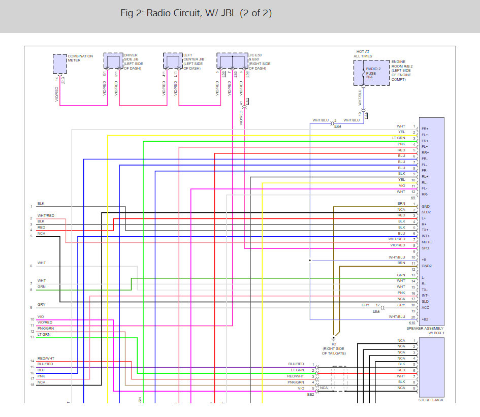

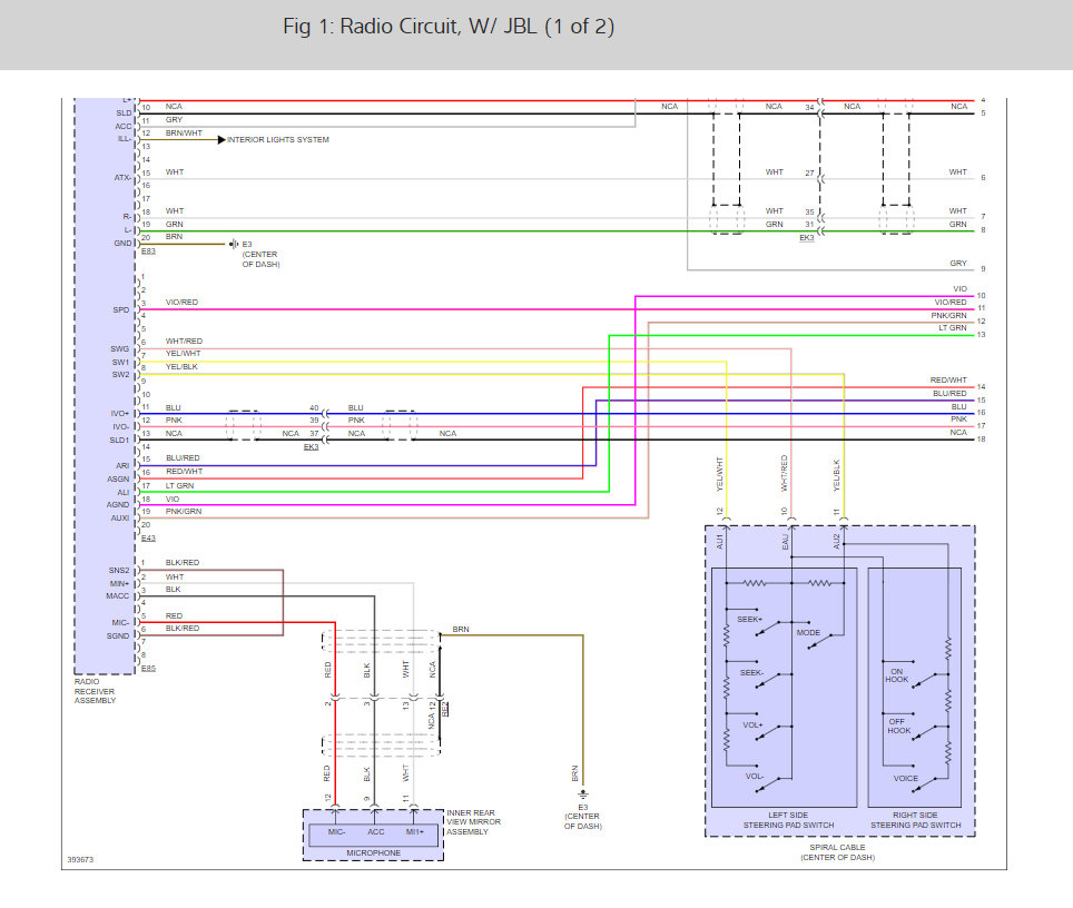

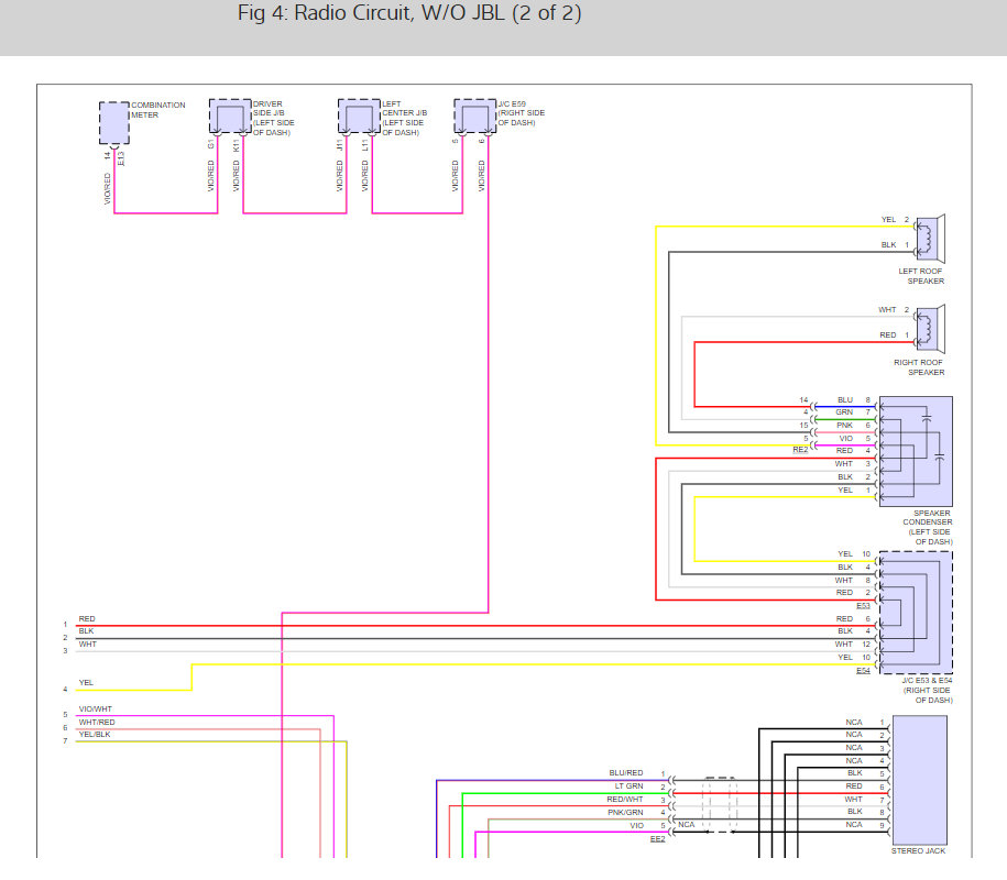

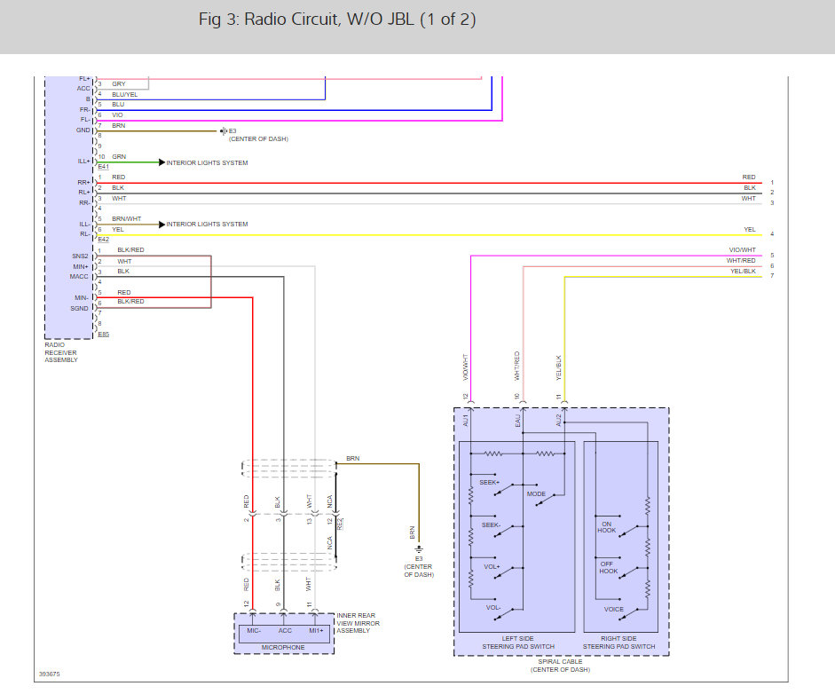

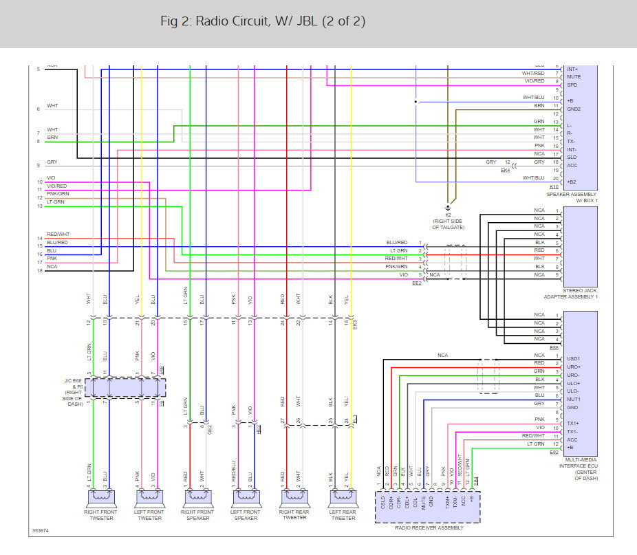

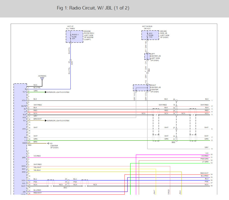

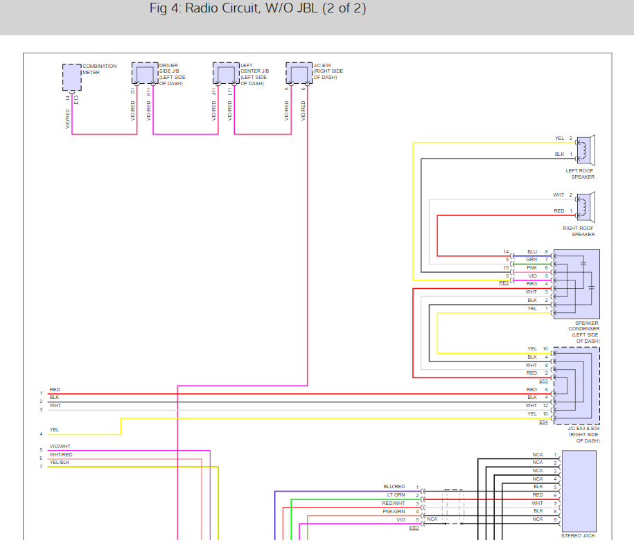

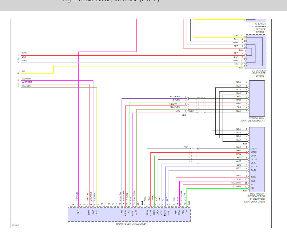

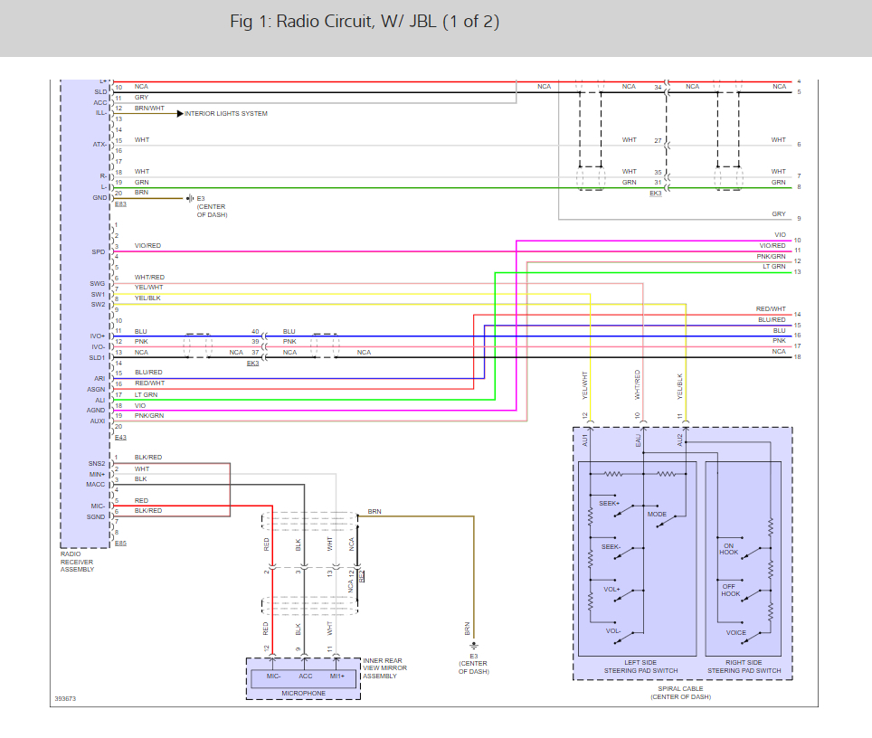

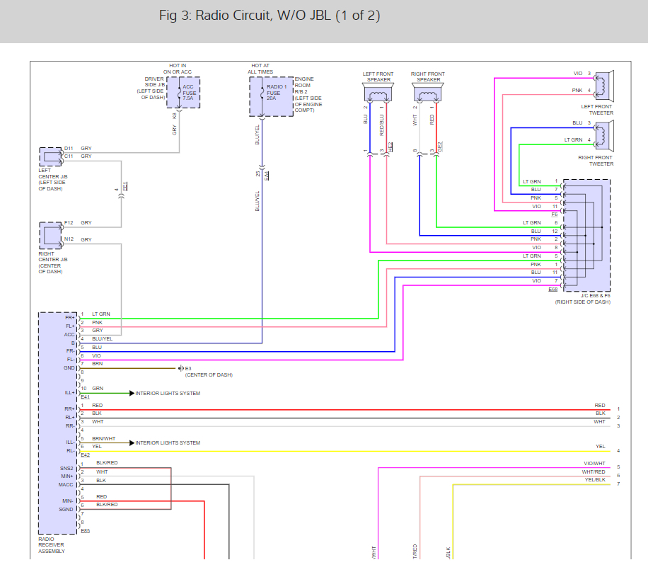

That's a good sign it means the camera is working. Did the previous radio have the capability of the rear camera or is this a new feature you are installing? Here are the radio wiring diagrams and a guide to help make sure you have the wiring done correctly:
Check out the diagrams (below). Please let us know what you find.

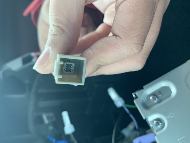

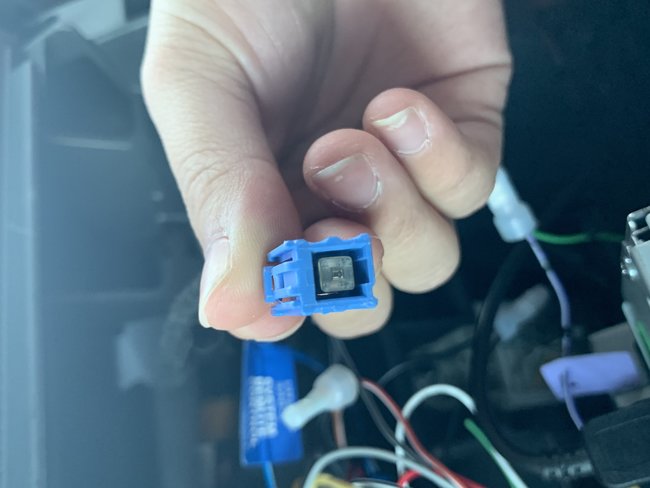

The blue is the factory plug and the other picture is the aftermarket harness I bought that doesn’t fit.
Apr 1, 2019 at 11:22 AM

It looks like you got the wrong harness. do they offer an updated connector?
