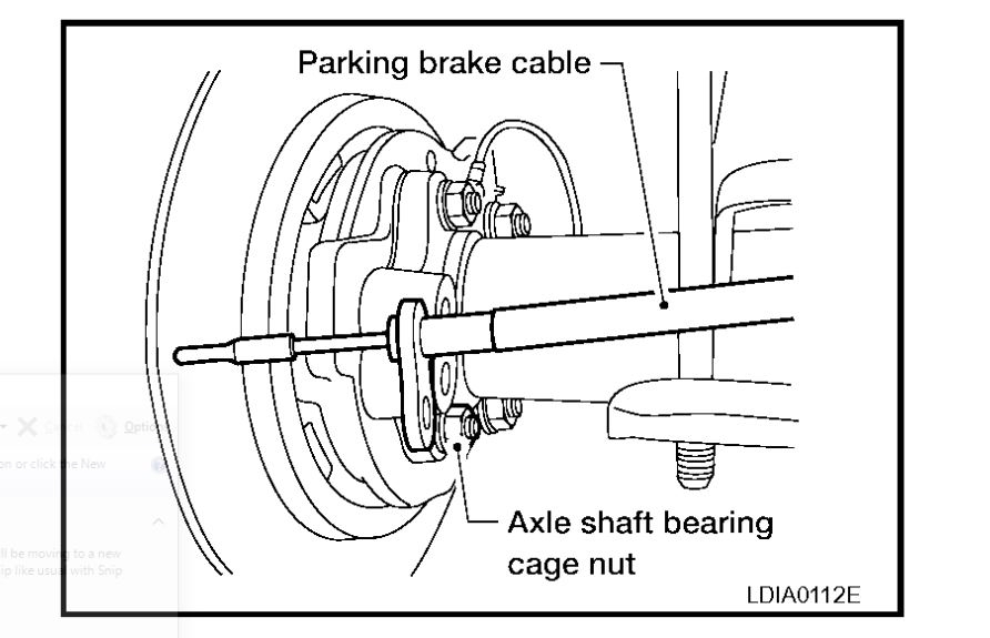

The seal assembly on the driver side axle shaft was torn apart. When I go and replace it, is there a possibility that the pieces of metal made their way down to the pumpkin cover of the axle.
Allen
May 9, 2020 at 10:47 PM
Good morning,
Can you verify if it is the front axle or the rear axle so I can get you the correct information?
May 10, 2020 at 12:40 AM
STOWEY13
It is the rear drivers side. I was able to pull the shaft out without using a push hammer or crow bar. The seal assembly bearing and spacer was busted up pretty good. The spline looks pretty in tact. Could the metal from the spacer and bearing make it's way to the pumpkin cover of the rear. Hopefully it's unlikely.
May 10, 2020 at 1:17 AM
Okay, thanks.

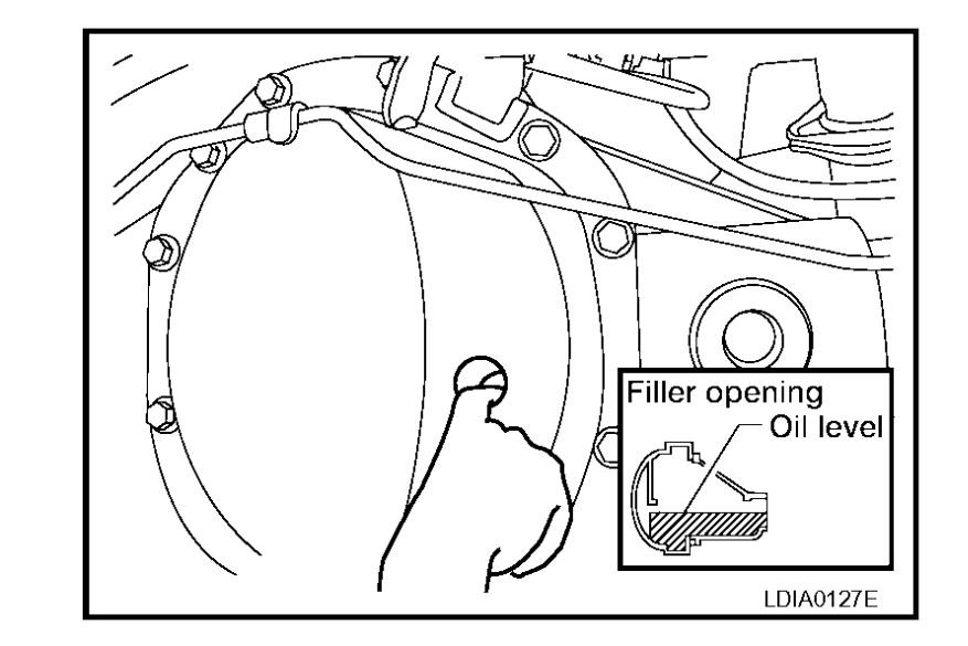

Yes, it will travel into the pumpkin and the oil.
Replace the seal and bearing and then you will need to flush out the tube, remove the rear cover and oil and flush out the inside of the differential.
https://www.2carpros.com/articles/differential-service
If you do not, the metal will get to the bearings and races and fail those bearings in a very short period of time.
REMOVAL

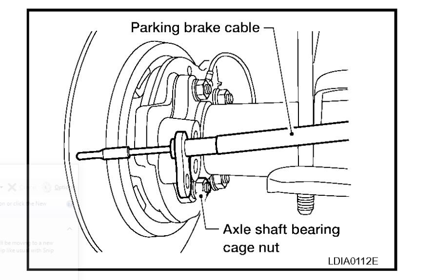

1. Remove the ABS sensor.
2. Remove the rear brake rotor.
3. Remove the parking brake assembly from the back plate.

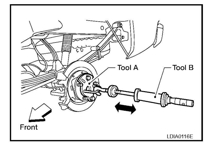

4. Remove the four axle shaft bearing cage nuts and lock washers.
5. Remove the axle shaft assembly using Tools as shown.

Tool number
A: KV40101000 (J-25604-01)
B: ST36230000 (J-25840-A)

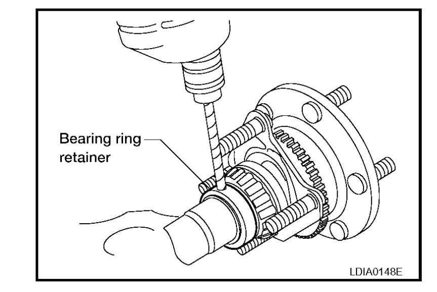

7. Secure the axle shaft in a suitable vise, then use a 1/4 in size drill bit to drill a hole approximately 3/4 into the thickness of the bearing ring retainer [3/4 thickness is approximately 6.3 mm (0.25 in) deep].
CAUTION:
Mount the axle shaft using a soft jaw vise to avoid damaging the axle shaft.
Do not drill all the way through the bearing ring retainer, the drill may damage the axle shaft surface.

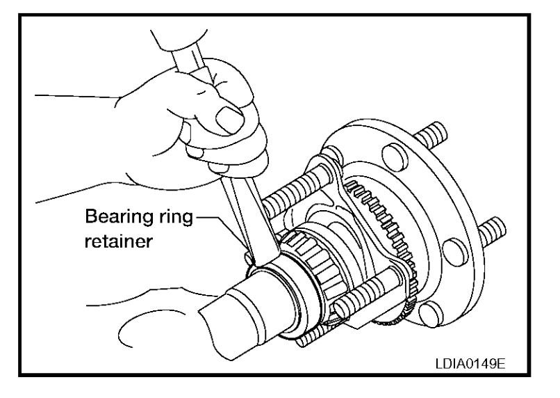

8. Strike the bearing ring retainer using a suitable chisel and hammer, with the chisel positioned across the drilled hole. Break the bearing ring retainer to remove it.
CAUTION: Do not heat or cut the axle shaft bearing or bearing ring retainer with a torch during removal, doing so will damage the axle shaft.

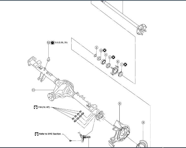

12. Remove the wheel bearing cage.
NOTE:
If reinstalling the old axle shaft, it may not be necessary to remove the ABS sensor rotor. Inspect the ABS sensor rotor and replace as necessary.
The ABS sensor rotor cannot be reused after it is removed. If replacing the axle shaft, install a new ABS sensor rotor on the new axle shaft.

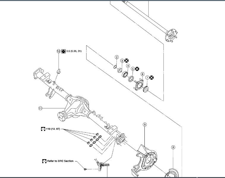

INSTALLATION
1. If installing a new axle shaft, install a new ABS sensor rotor onto the new axle shaft.
CAUTION: Do not reuse the old ABS sensor rotor.
2. Install the axle shaft bearing cage.
3. Install a new axle oil seal.
CAUTION: Do not reuse the axle oil seal. The axle oil seal must be replaced every time the axle shaft assembly is removed from the axle shaft housing.
