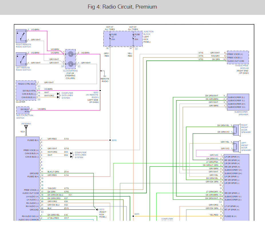

Hi, I can't find any info for identifying the wire of the OEM plug, can you? The radio plays 1 second then stops until I restart the truck and then it does the same 1 second and stops again.

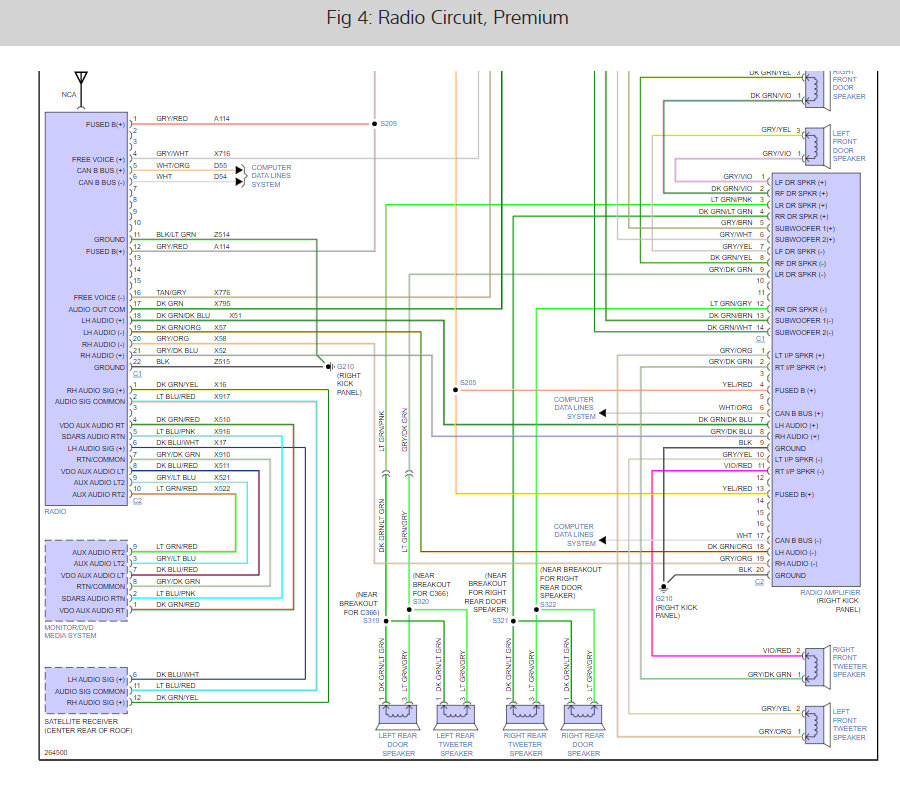

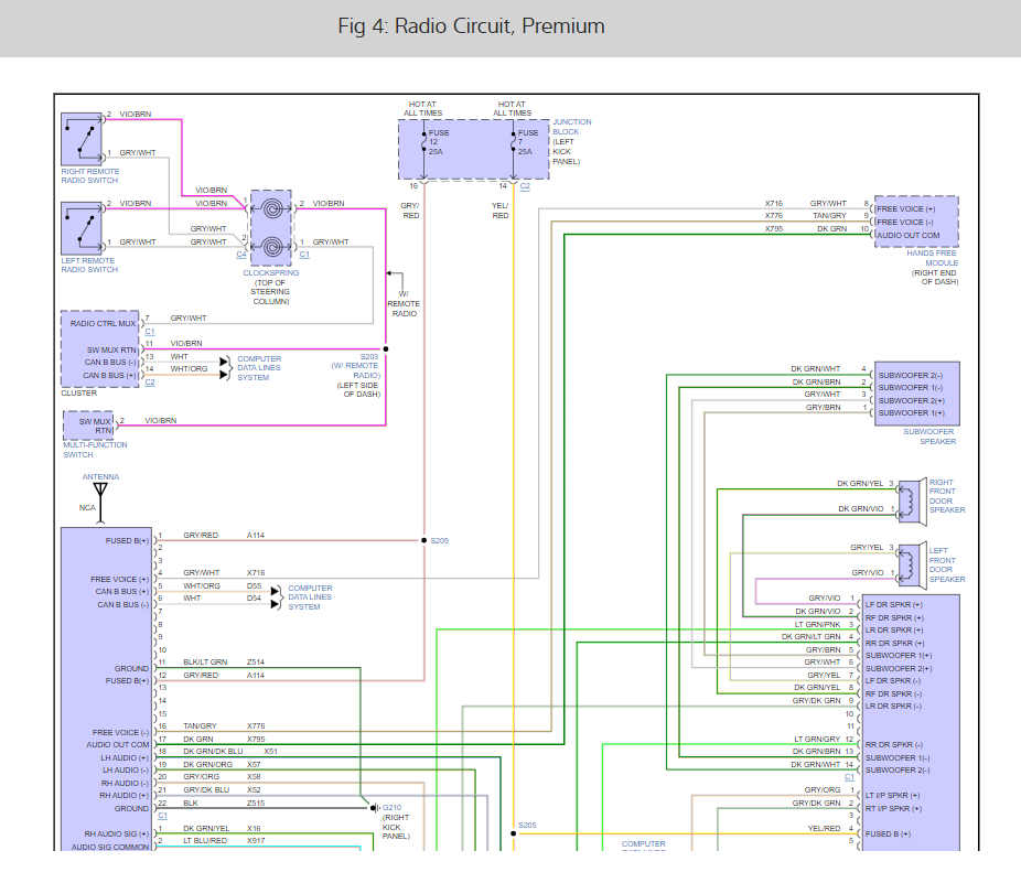

It sounds like the amplifier inside the radio is going out, which will require replacement, but here are the radio wiring diagrams so you can see how the system works. Check out the images (below). Please let us know if you need anything else to get the problem fixed.
