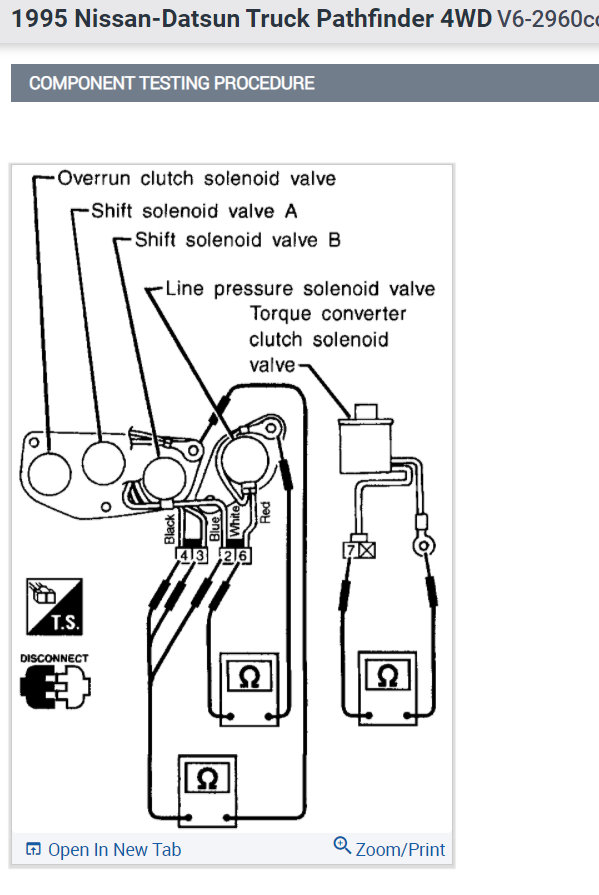

Okay, so i used to daily drive this car and one day we parked on a slope that was about 15-20 degrees and when i put it in reverse it took a second to kick in but it did kick in. After a while the problem got slightly worse so i checked the transmission fluid and it was fine. About a week goes by and i was going about 10 MPH and i heard a grinding sound coming from the transmission. After that reverse stopped working for about a month and i tried it and it worked one last time. After that nothing ever again. All the other gears are fine. I checked the solenoids, they seem fine as well. It has been about 4 months since i have driven it on the road at all. And i plan on fixing it for a off road car.
Yea, I'm planning to pull it of soon unless i missed something.

How was the fluid condition? if burnt I would service the unit. here is a guide to help walk you through the steps with a video of the job being done on a similar car below:
and
https://youtu.be/FglBsUEOSEk
This guide can help as well:
Please run down these guides and report back. i have also seen the pressure regulator sednoid go out as well. Check out the diagrams (below). Let us know what happens and please upload pictures or videos of the problem.
