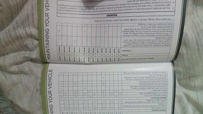

My paperwork from the dealer says that I have the 6-speed Automatic Transmission w/ the Auto-stick, not the CVT. And my Manual states that I shouldn't need any Transmission servicing until maybe 120,000 miles.

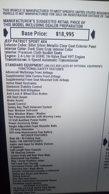

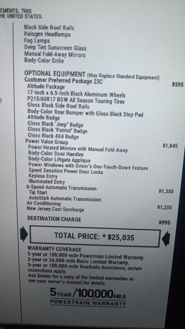

I purchased this Jeep a year and a half ago at 41000 miles. Is it possible that the Dealer gave me an inaccurate set of Vehicle Specs? The vehicle specs say "Transmission: 6-speed Automatic" and "Autostick Automatic Transmissions Tip Start".

Do you have different information for the 6-speed Automatic Transmission? I've found that the Transmission is inaccessible under the hood. There's no reservoir. I think it's accessed from underneath the vehicle.

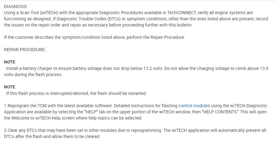

You are correct. The standard equipment transmission is a CVT. This vehicle was upgraded.

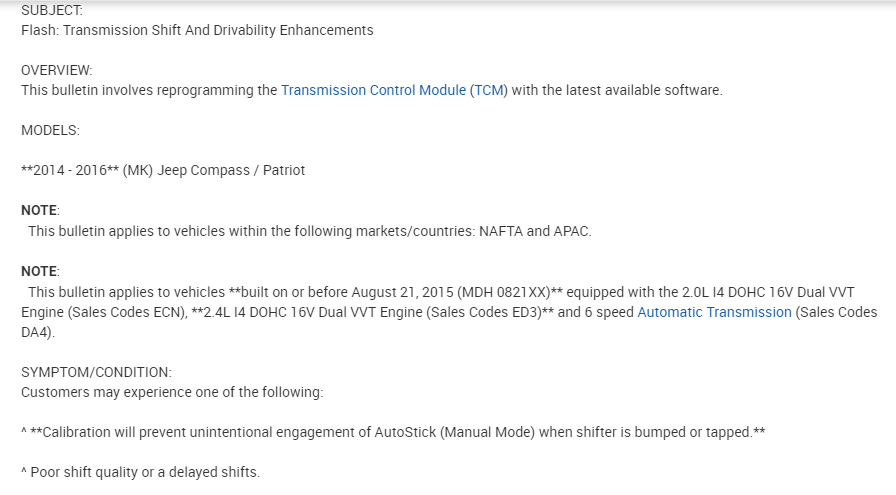

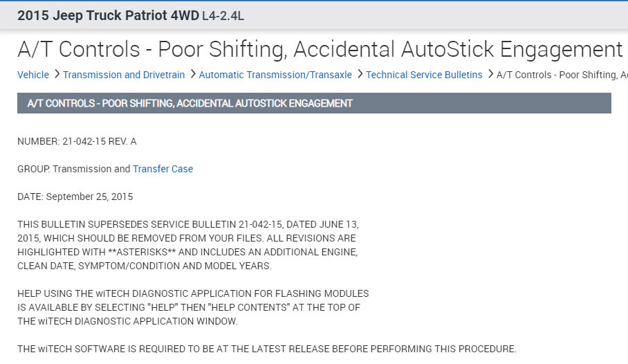

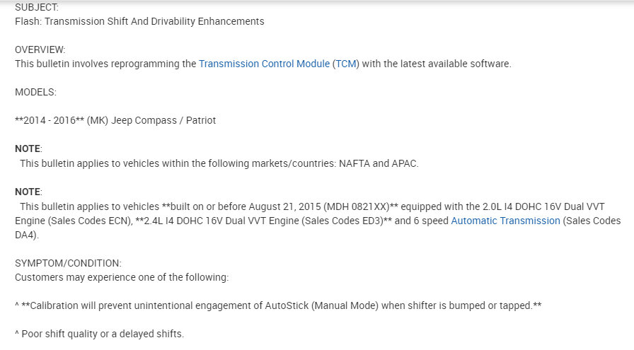

As far as the shift issue, my first suspect is the transmission control module (TCM) needs to be flashed/reprogrammed with the most up-to-date information. I was able to find a technical service bulletin specific to a delayed shift.
I attached the TSB below. Mention this to the shop and let me know what they say.
