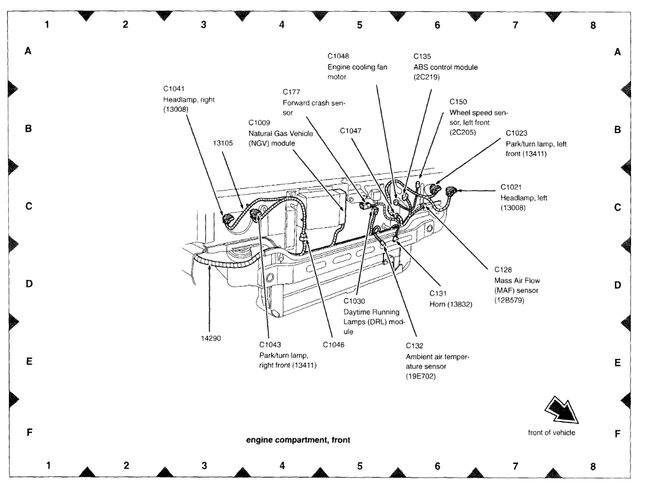

Okay, I tried it a bunch of times with no results. The heat works when it kicks on. When it kicks on, it works fantastically. The car has a lot of miles and years but was very well cared for and there was only one owner for all the miles. I was wondering if what reads the outside temperature is the problem. The display reads warmer than it is. I'd say 10 to 20 degrees warmer.
Mar 12, 2023 at 1:18 PM
  • CERTIFIED EXPERT
  • 53,872 POSTS

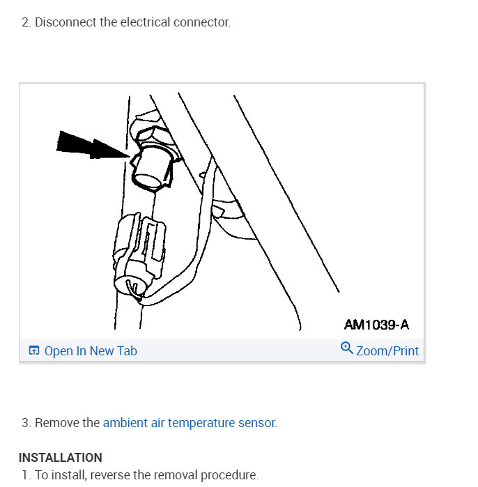

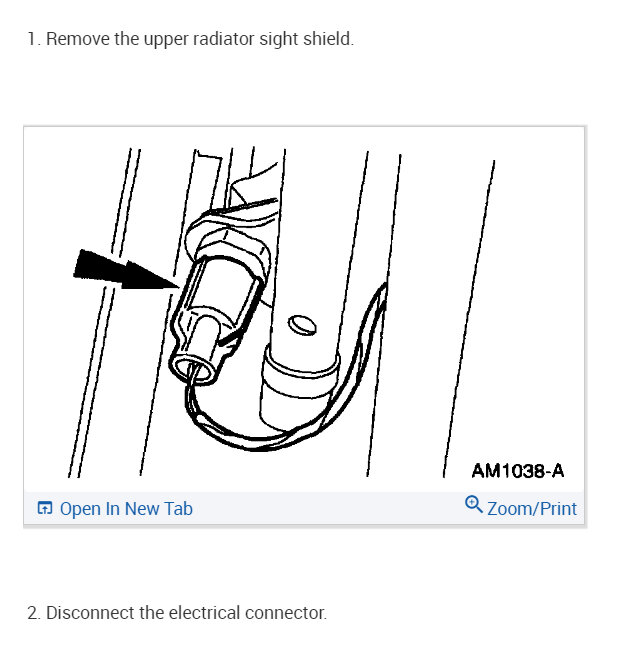

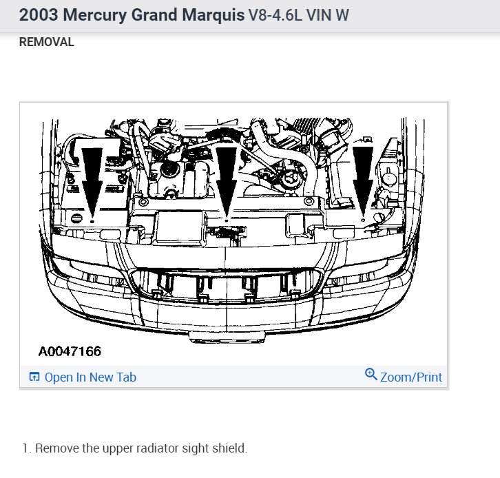

Yep, that can do it, the misinformation can fool the HVAC controller, here is the location of the ambient temperature sensor in the front of the car and the instructions on how to change it out.
