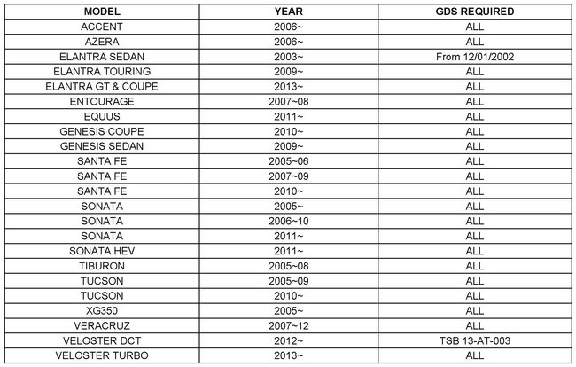

pic 8

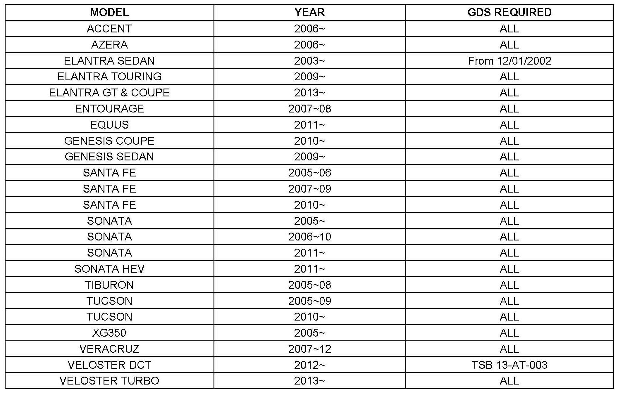

GDS must be used to reset (erase) the adaptive learning for the following vehicles.

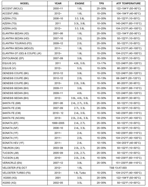

II. RELEARN ADAPTIVE VALUES:
pic 9

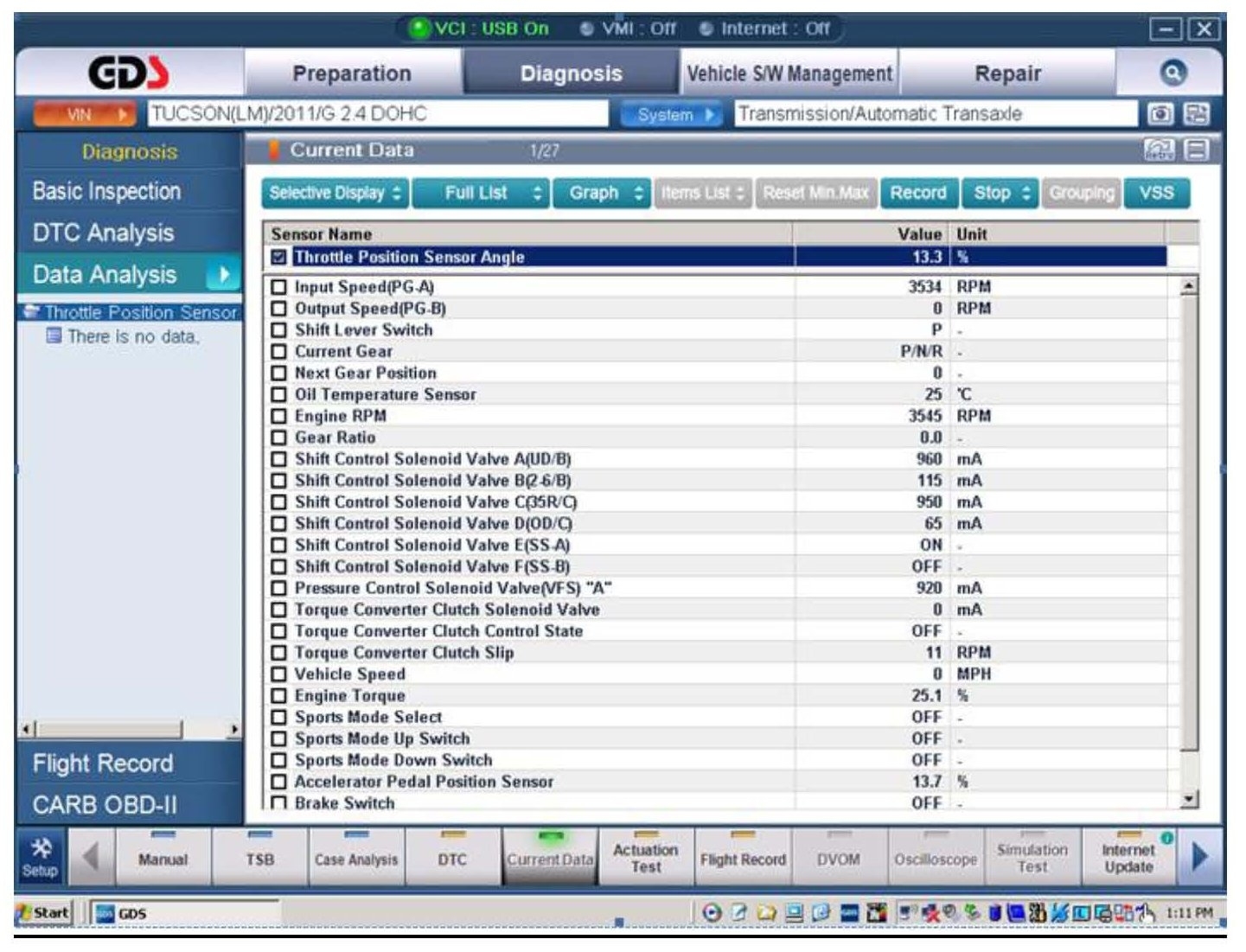

1.Attach a GDS and select VIN and A/T menu, Current Data and Throttle Position Sensor.
pic 10
2.Drive the vehicle until the ATF temperature is within the range shown.
3.Request an assistant to monitor the GDS:
Accelerate from a stop at the TPS specification while the transmission shifts through gears 1-2-3-4-5-6-7-8 (if equipped) and decelerate slowly to a stop. Repeat 5 times.

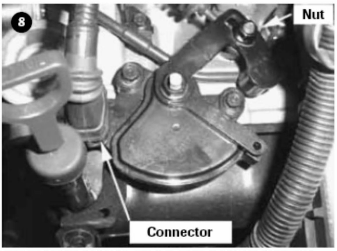

VERIFY THE RANGE SWITCH ADJUSTMENT:

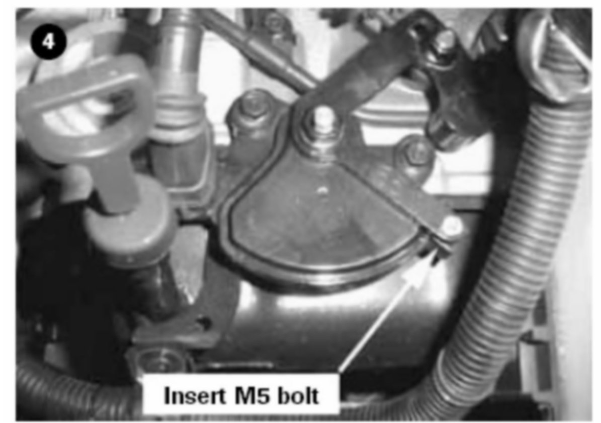

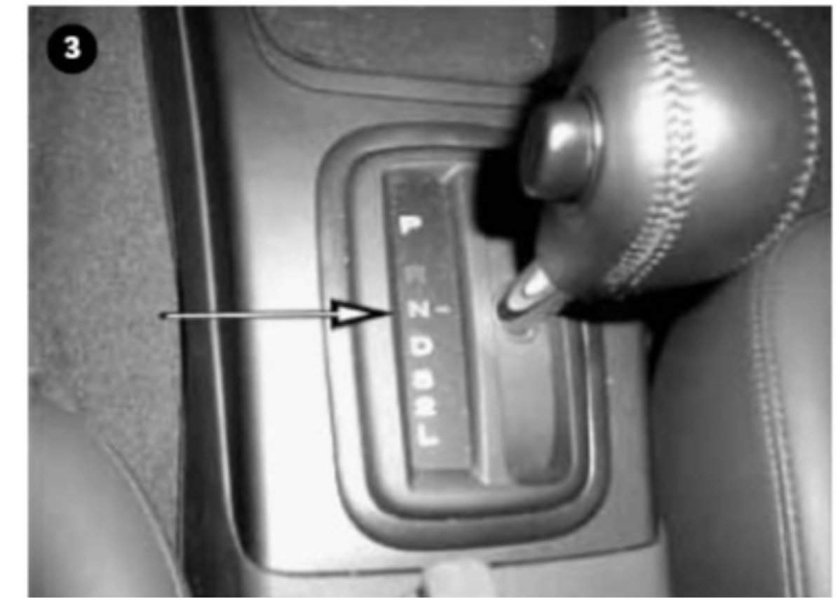

3. Move the shift lever to "N".
pic 1
4. Insert a 5 mm drill or MS (5 mm) bolt in the adjustment hole of the range switch. Check that the drill or bolt fits into the adjustment holes.
^If not, go to Step 5
^If so, go to Step 9
pic 2

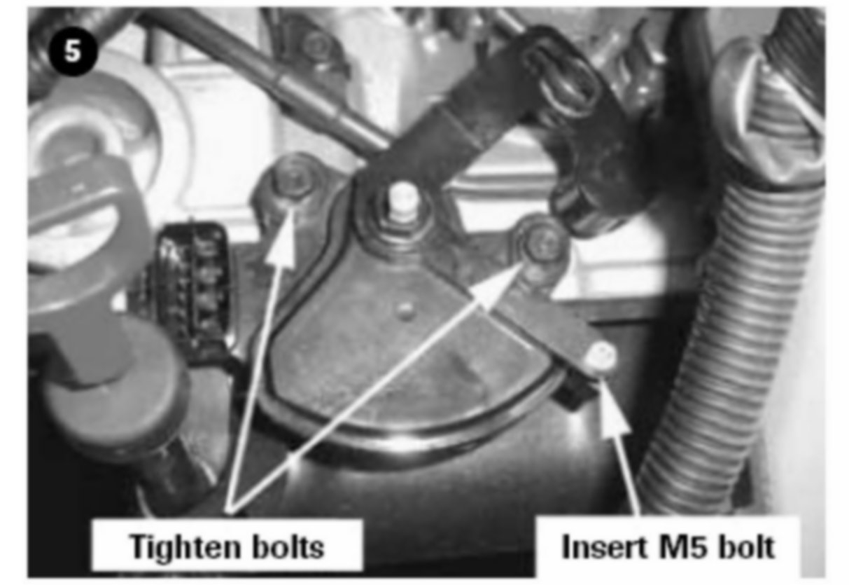

5. Loosen the two 10 mm mounting bolts.
pic 3
6. Disconnect the shift cable at the lever.
7. Insert a 5 mm drill or M5 (5 mm) bolt in the adjustment hole of the range switch. Tighten the two 10 mm mounting bolts to specification.
Specification: 7-8 ft.lb
(10-12 Nm, 100-120 kg.cm)
8. Move the shift lever to the "N" position. Attach the
shift cable to the lever and install the nut. Tighten the nut to specification.
Specification: 9-10 ft.lb
(12-13 Nm, 120-130 kg.cm)
Remove the 5 mm drill or M5 bolt
pic 4

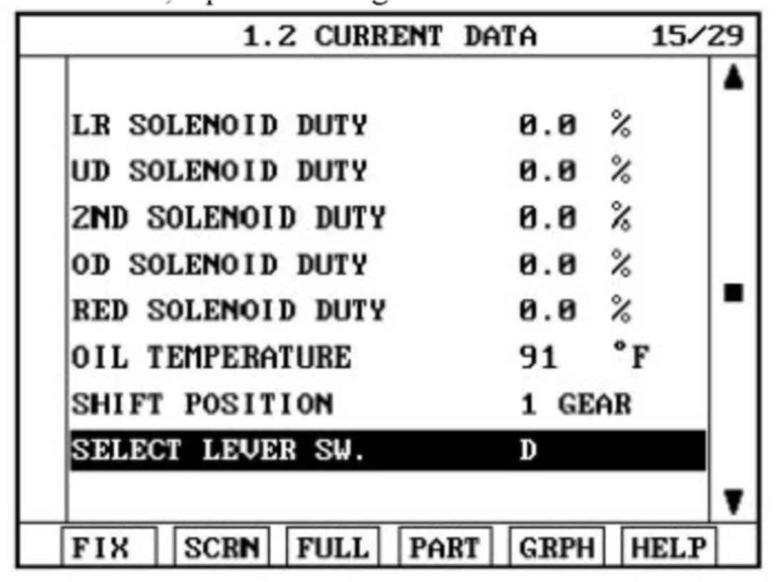

VERIFY THE SIGNAL FROM THE RANGE SWITCH:
9. Attach a Hi-Scan Pro and select:
^"Hyundai Vehicle Diagnosis"
^Vehicle
^Automatic Transaxle" menu
^"Current Data" menu

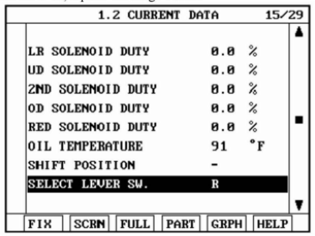

^"Select Lever Switch" and "Shift Position:
10. Move the shift lever to Reverse.
^Monitor "Select Lever Switch".
^If "R" is displayed, the TCM is receiving the correct signal from the range switch. Go to Step 11.
^If not, check the connector at the TCM and the range switch for a bent pin or pin not fully inserted.
Check the wiring harness for an open or short circuit. If ok, replace the range switch.
pic 5
11. Move the shift lever to Drive.
^Monitor "Shift Position" and "Select Lever Switch".
^If "D" and "GEAR 1" are displayed, the TCM is receiving the correct signal from the range switch. Go to Step 12.

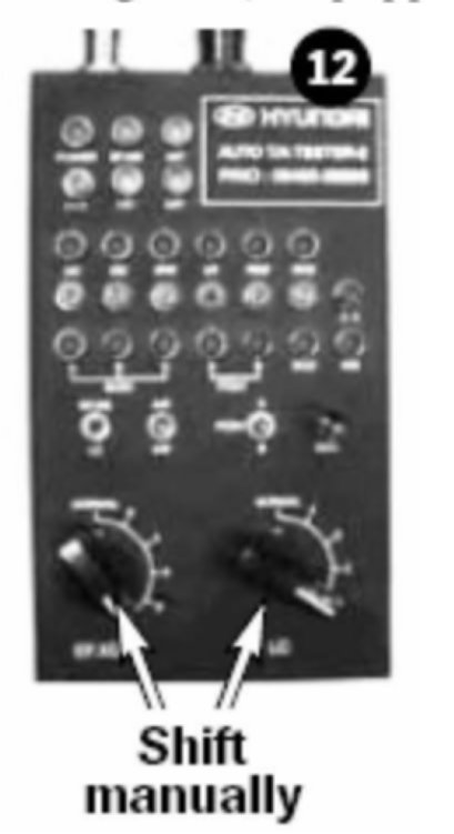

12. Install the A/T Tester, P/N 09450-AT000, to the vehicle:
^Shift the transaxle to "D". Move the gear selector switch of the A/T Tester and shift manually in 1, 2, 3, 4, and 5 gears (if equipped).
pic 7
NOTE:
Use the "EF, XG" switch for side-pan transaxles and the "LC" switch for bottom pan transaxles.
^Disconnect the A/T Tester from the solenoid. Do not reconnect the harness connector to the solenoid. Shift the transaxle to "R".
^If no movement replace the transaxle.
^If the vehicle moves check the harness connector at the TCM and the solenoid for a bent pin or pin not fully inserted. Check the wiring harness for an open or short circuit.
^If no problem is found swap a TCM from a similar vehicle and test for movement in Drive and Reverse. If the vehicle moves in Drive and Reverse replace the TCM.
