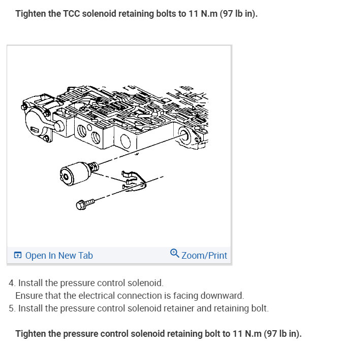

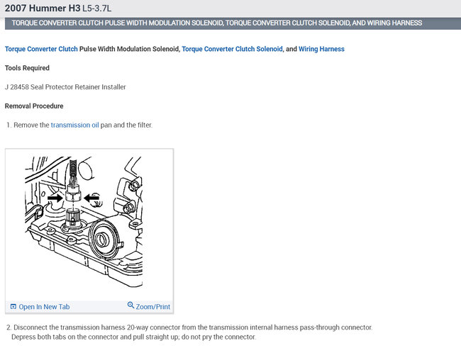

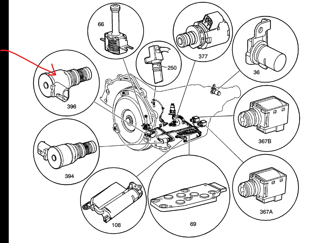

I’ve done tests on the alternator and it’s not what’s causing the issue. My H3 drives fine and there’s really no issues besides when I hit my brakes, the headlights will dim, the RPMs will drop to like 400 and jump back up to 1,000 and then repeat a few more times. Sometimes it recovers, sometimes it completely stalls out. It’s an automatic, so this shouldn’t be happening. I lose all power steering which is dangerous in a state with busy round-a-bouts. I have to quickly shove it into neutral and start it again and put it into drive.
Any idea what might be causing this besides an alternator?
Feb 6, 2023 at 11:22 AM
  • 54,832 POSTS

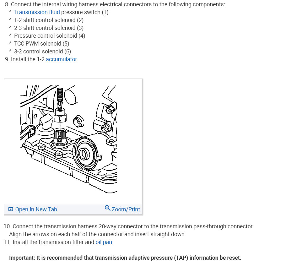

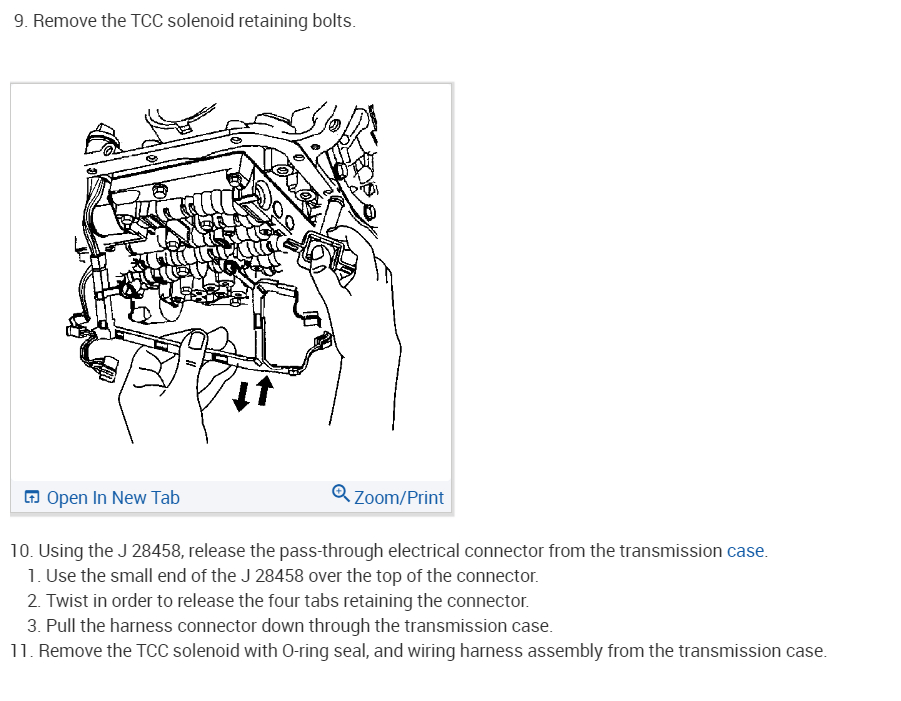

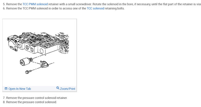

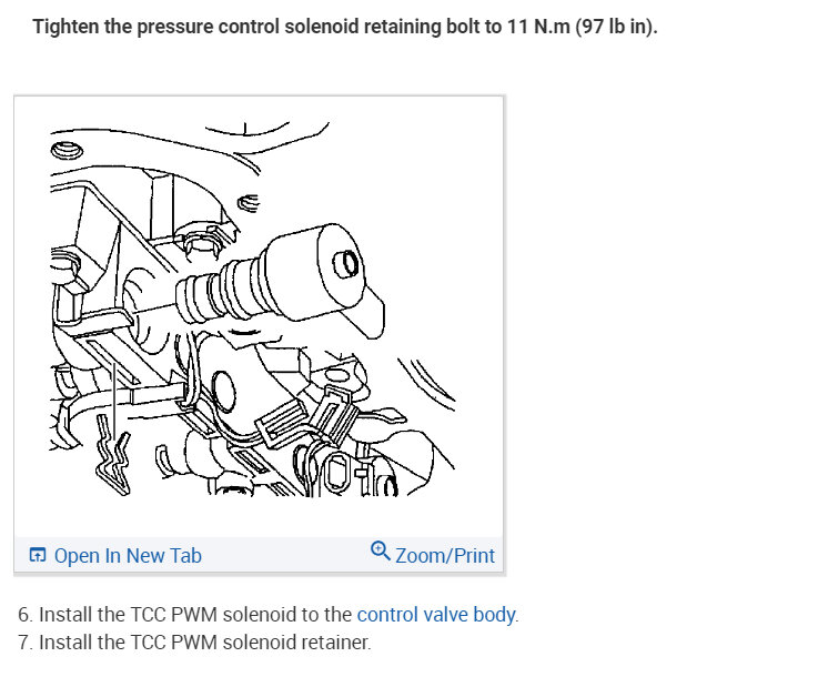

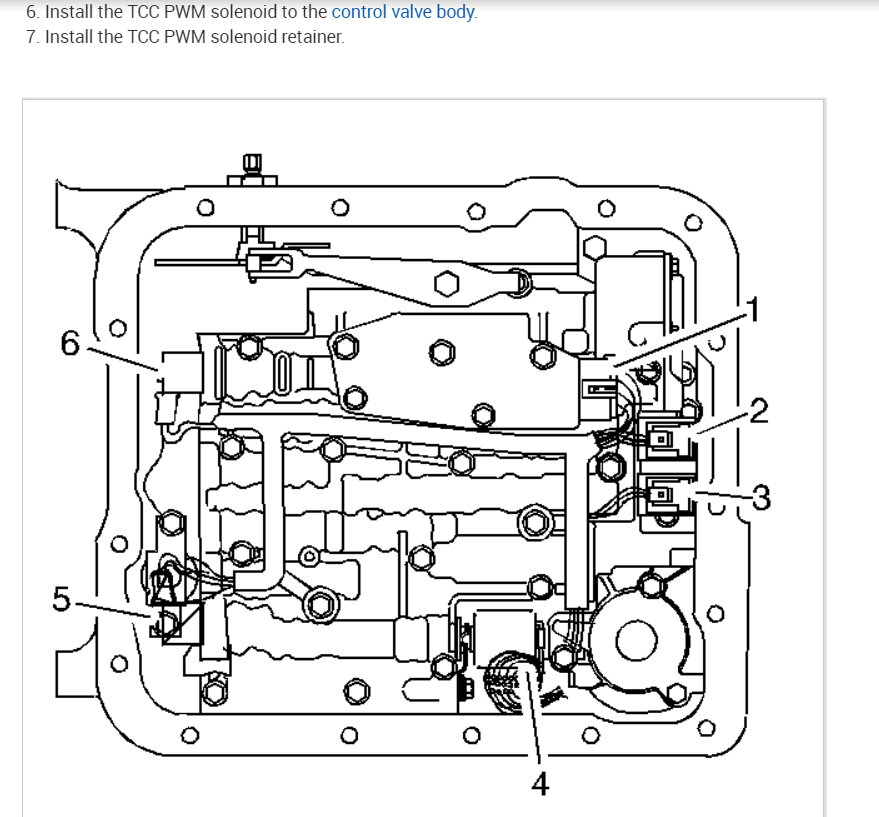

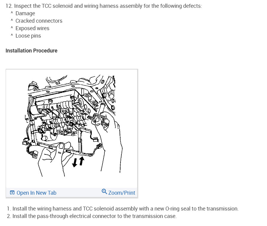

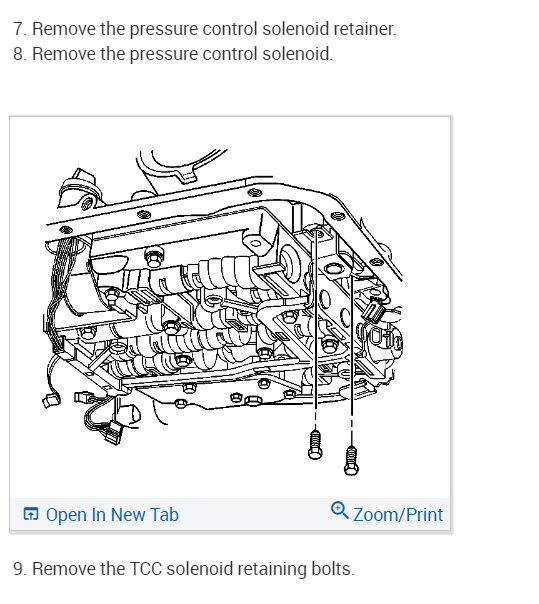

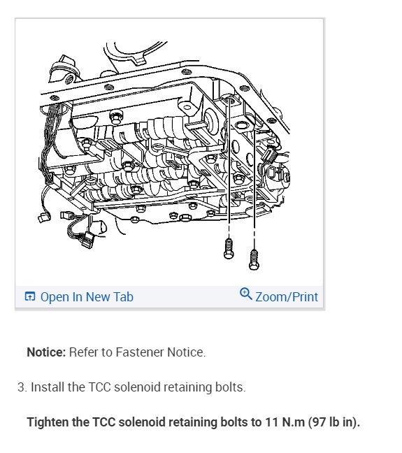

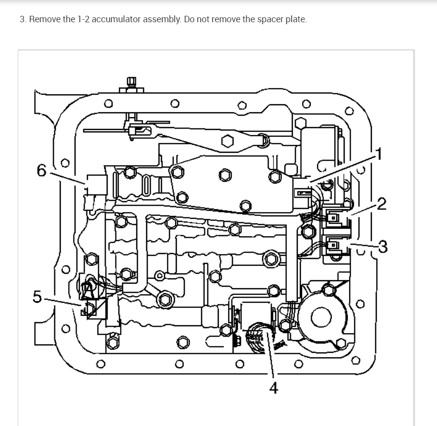

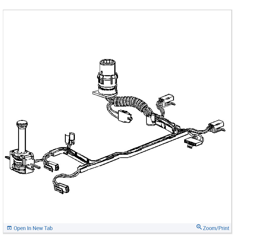

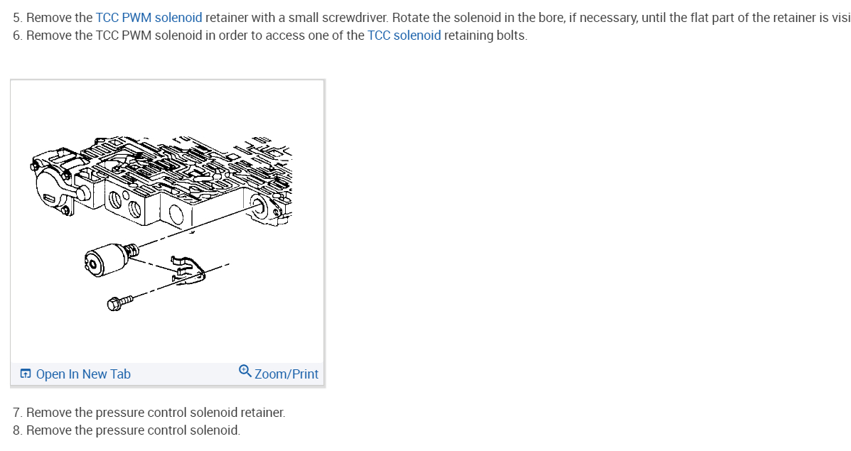

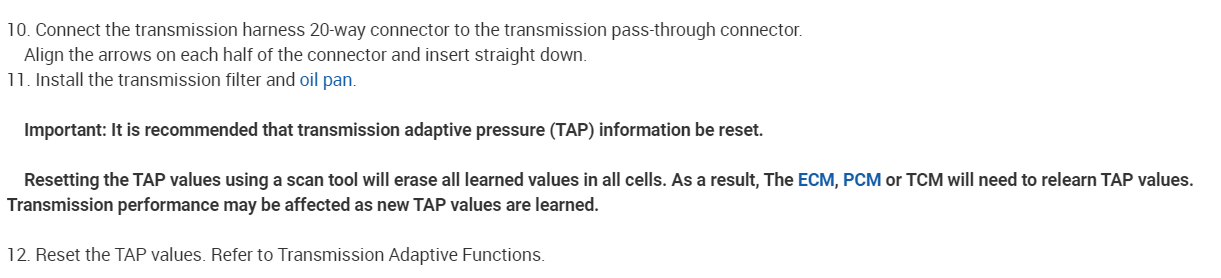

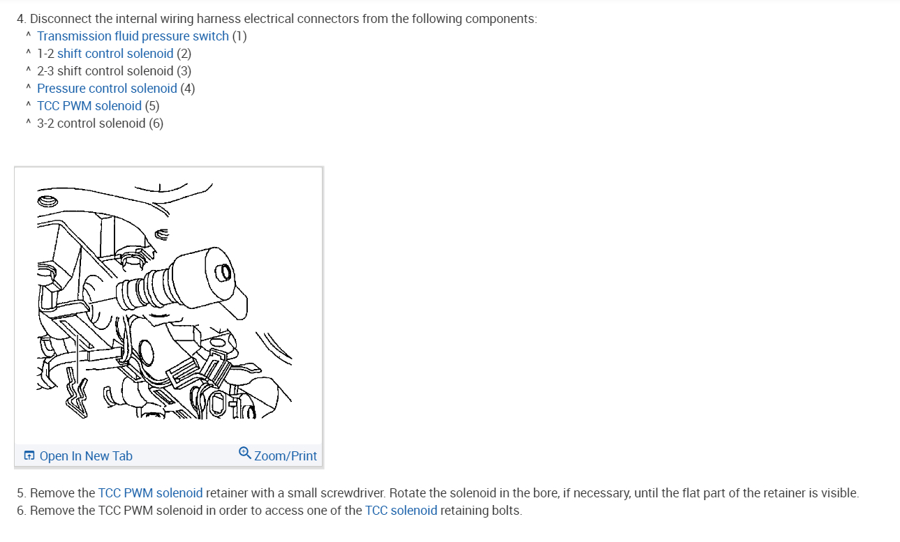

It sounds like the torque converter control solenoid is not releasing causing the engine to stall out, but we should run the codes to see what comes up. This guide will help, and I have included the location for the control solenoid in case you need it. Also, if the transmission has not been serviced, I would change the filter as well when doing the solenoid. Check out the images (below). Let us know what happens and please upload pictures or videos of the problem.
