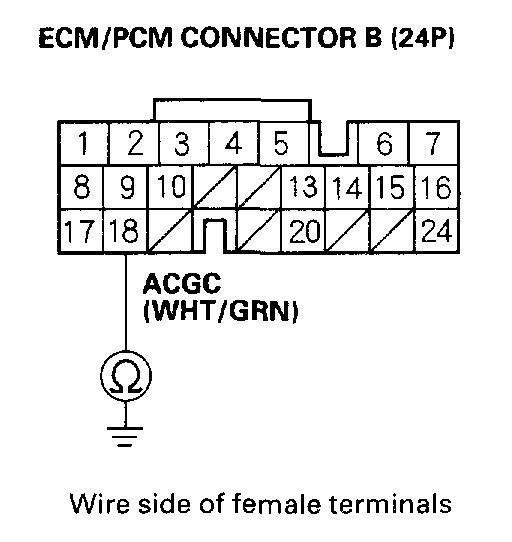

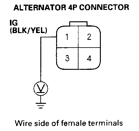

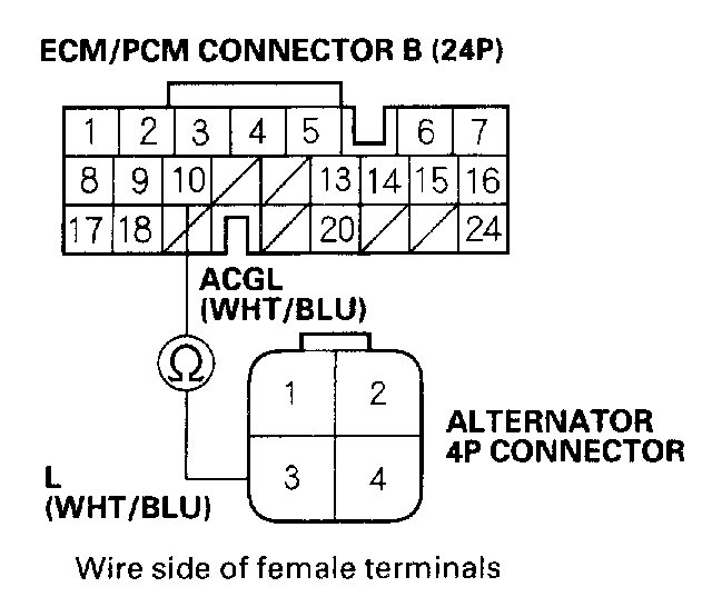

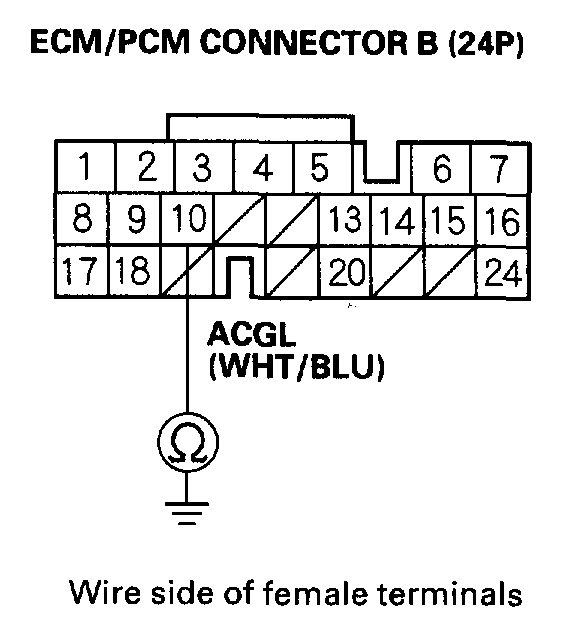

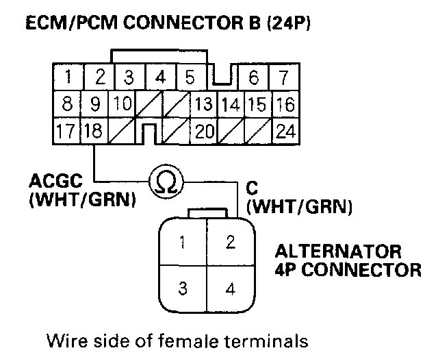

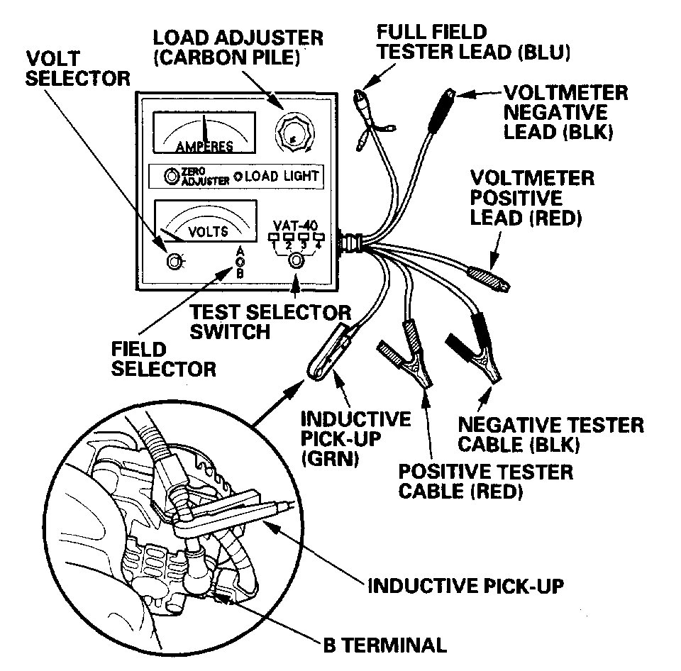

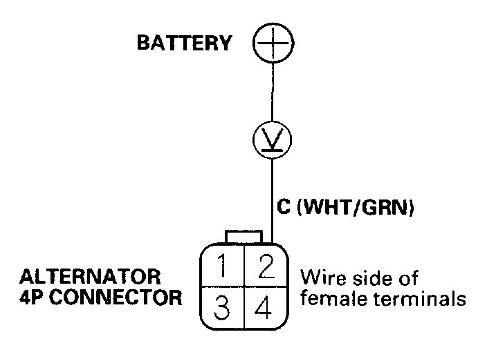

I changed the alternator twice, still my car have not fixed running the battery down and getting me stuck on roads.

To start, here are general directions for checking an alternator. It basically will tell us if the battery is receiving a charge from the alternator. You will need to use a volt or multi-meter. Here is a link showing how that's done, one for checking wiring, and then the alternator check:
Here are the directions for diagnosing a charging problem with your vehicle from Alldata. It it is much more involved. All pictures attached correlate with these directions.

5. Disconnect the alternator 4P connector from the alternator.
6. Measure the voltage at the No.1 terminal of the alternator 4P connector with the ignition switch ON (II).
Is there battery voltage?
YES - Go to step 7.
NO - Check for a blown No.4 (10 A) fuse. If the fuse is OK, repair open in the wire between the alternator and the under-dash fuse/relay box.
7. Turn the ignition switch OFF.
8. Disconnect the negative cable from the battery.
9. Disconnect Engine Control Module (ECM)/Powertrain Control Module (PCM) connector B (24P).
10. Check continuity between the ECM/PCM connector terminal B10 and alternator 4P connector terminal No.3.
Is there continuity?
YES - Go to step 11.
NO - Repair open in the wire between the alternator and the ECM/PCM.
11. Check continuity between the ECM/PCM connector terminal B10 and body ground.
YES - Repair short in the wire between the alternator and the ECM/PCM.
NO - Reconnect the negative terminal to the battery and go to alternator and regulator test.
Alternator and Regulator Circuit Test
1. Be sure the battery connections are good, and that the battery is sufficiently charged.
2. Connect a VAT-40 (or equivalent tester), and turn the selector switch to position 1 (starting).
3. Shift to [P] or [N] (A/T, CVT) or neutral, and start the engine. Hold the engine at 3,000 rpm, with no load until the radiator fan comes on, then let it idle.
4. Raise the engine speed to 2,000 rpm, and hold it there.
Is the voltage over 15.1 V?
YES - Replace the voltage regulator.
NO - Go to step 5.
5. Release the accelerator pedal, and let the engine idle.
6. Make sure all accessories are turned off. Turn the selector switch to position 2 (charging).
7. Remove the inductive pick-up, and zero the ammeter.
8. Place the inductive pick-up over the B terminal wire of the alternator so that the arrow points away from the alternator.
9. Raise the engine speed to 2,000 rpm, and hold it there.
Is the voltage less than 13.5 V?
YES - Go to alternator control system test
NO - Go to step 10.
10. Apply a load with the VAT-40 until the battery voltage drops to between 12 - 13.5V.
Is the amperage 60 A or more?
YES - The charging system is OK.
NO - Repair the alternator.
Alternator Control System Test (U.S. models)
1. Check for proper operation of the electrical load detector (ELD) by checking the malfunction indicator lamp (MIL). If a DTC is present, diagnose and repair the cause before continuing with this test.
2. Disconnect the alternator 4P connector from the alternator.
3. Start the engine, and turn the headlights (high beam) ON.
4. Measure voltage between the alternator 4P connector terminal No.2 and the positive terminal of the battery.
Is there 1 V or less?
YES - Go to step 8.
NO - Go to step 5.
5. Turn the headlight and ignition switch OFF.
6. Disconnect engine control module (ECM)/powertrain control module (PCM) connector B (24P).
7. Check for continuity between ECM/PCM connector terminal B18 and body ground.
YES - Repair short to ground in the wire between the alternator and ECM/PCM.
NO - Check that the terminals are firmly seared at the connecters. If OK, Reprogram the ECM/PCM if it does not have the latest software, or substitute a known-good ECM/PCM, then recheck. If the symptom/indication goes away with a known-good ECM/PCM, replace the original ECM/PCM.
8. Turn the headlight and ignition switch OFF.
9. Disconnect the ECM/PCM connector B (24P).
10. Check for continuity between ECM/PCM connector terminal B18 and alternator 4P connector terminal No.2.
YES - Repair the alternator.
NO - Repair open in the wire between the alternator and ECM/PCM.
