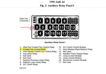

My cooling fans will not turn on I have replaced cooling fan switch but still wont kick on any sugestions.

check the cooling fan control relay, see pic.
