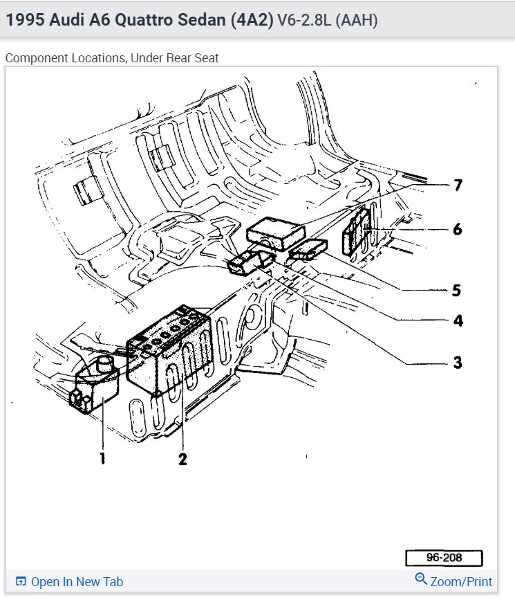

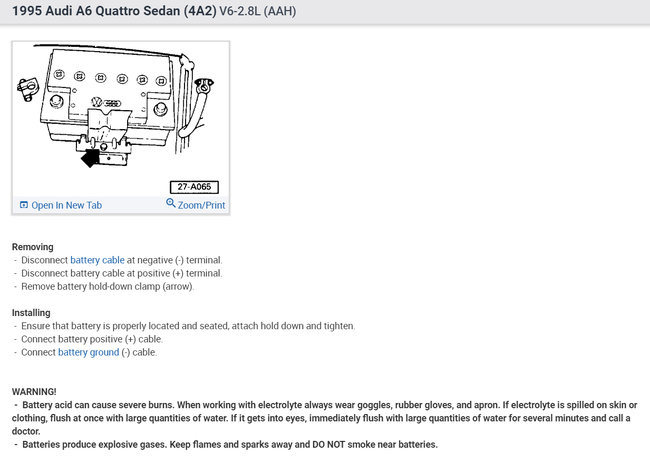

Where is the battery located on Audi A6 1995 Quattro?
Sunday, June 28th, 2020 AT 11:38 AM (Merged)
KHLOW2008
  • 41,814 POSTS
The battery is under the back set here isa guide to help you change it and diagrams below to show you on your car.
https://www.2carpros.com/articles/how-to-replace-a-car-battery
