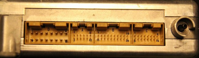

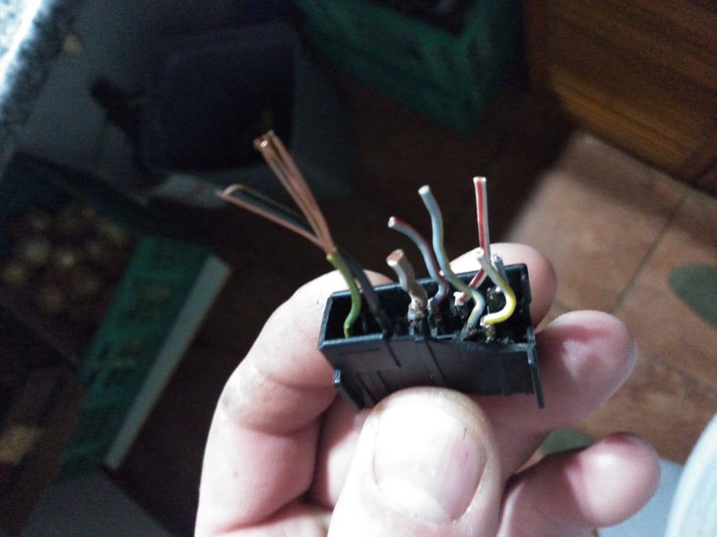

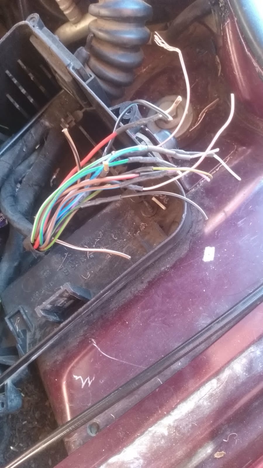

Someone tried to steal my vehicle. They have cut and pulled out all the wires out of the connector D on the ECU.

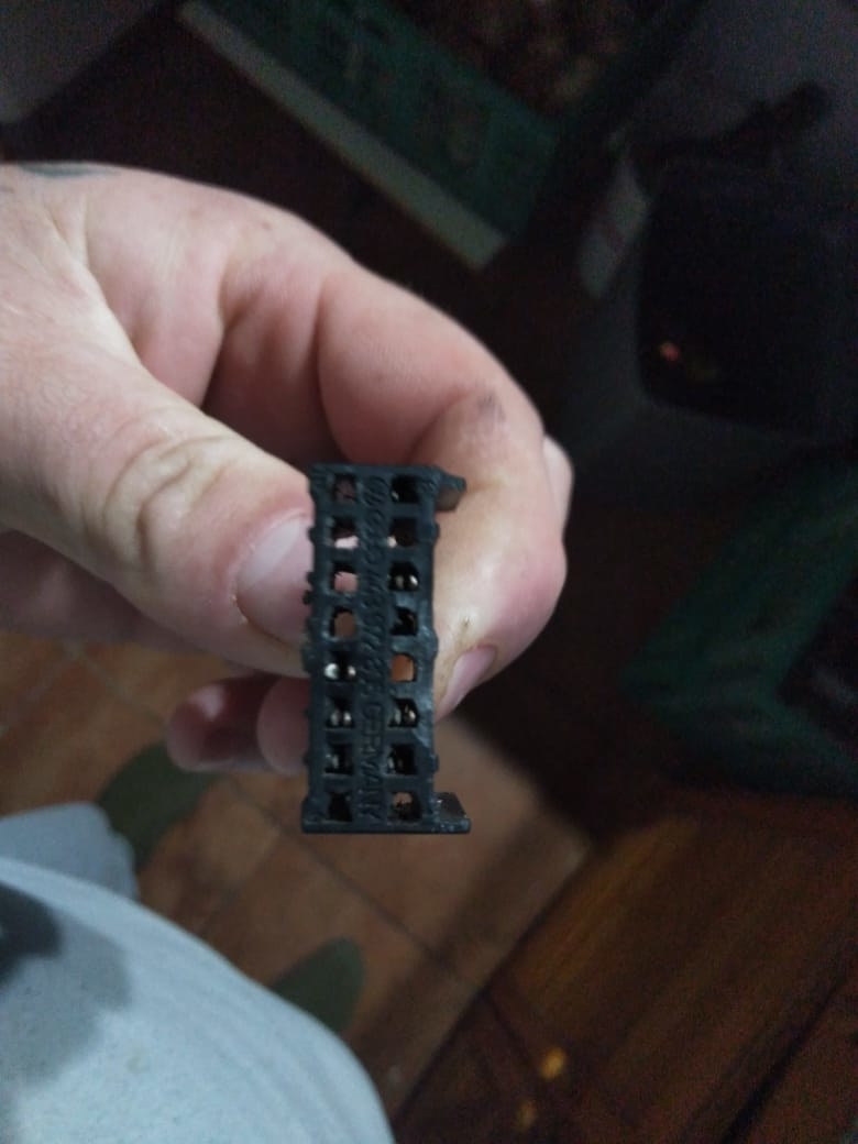

If someone may kindly assist me. I just need to get an auto electrician to re-wire. I live in South Africa, and the auto electricians tell me the same story they need a schematic diagram or photo of the wires that plugs into the plug.
The 16-pin plug 443 972 805. I need the color wire diagram on the 16-pin piggyback plug. I really need to get my car sorted out for my children.
If someone may please help me urgently.

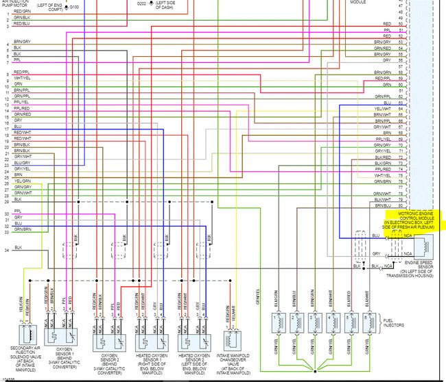

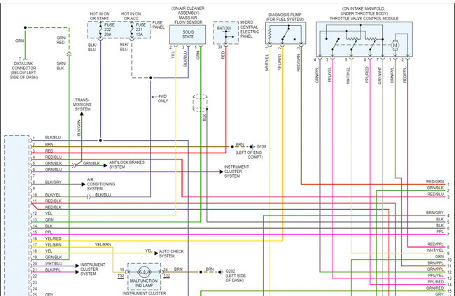

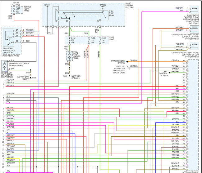

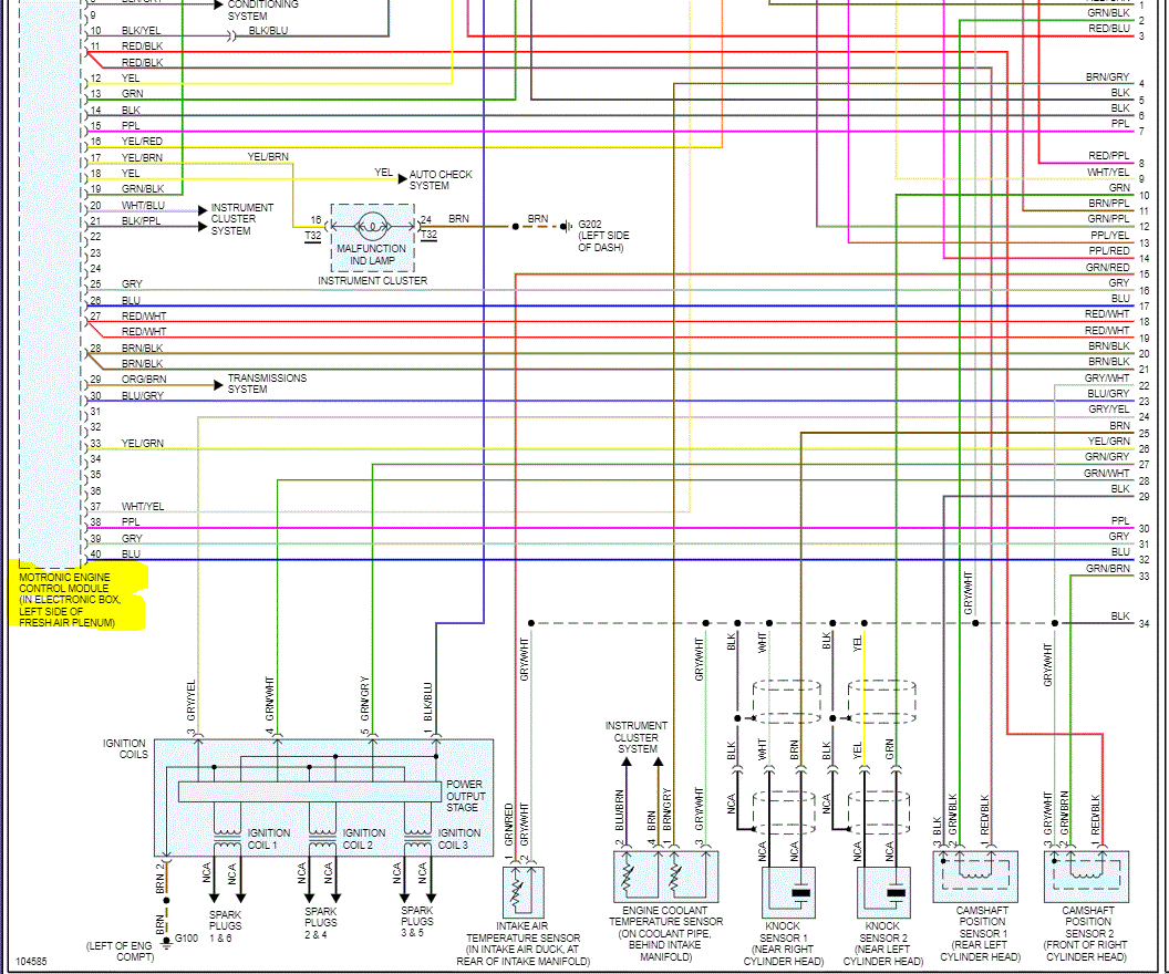

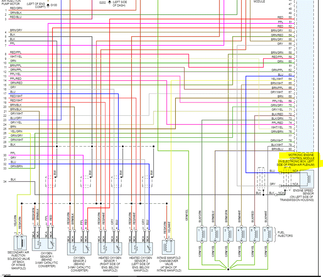

I attached the wiring schematics below for a V6, but it indicates it to be a 2.8L and not a 2.6L. Also, you show it as being turbo. The only turbo model we have is a 1.8L.
As far as the schematics, I had to cut each one in half to make them readable for you. I did overlap them so you can follow from one to the next.

Thank you very much it is highly appreciated. I see on the diagrams it says Motronic. My Audi has a Hella computer box. As far as I know the Motronic and Hella differs from one another. I have bought a new 16 pin plug. Like I say I just need to make sure what color wire goes into what pin on Connector D.

The Motronic is the only one I'm showing. Tell me this. Is the engine size you listed correctly? If it isn't, are you in the US?

Thanks for the update. That was my concern. Because it isn't one offered here, I don't have the 2.6L information. So, the information I provided is likely incorrect.
I feel bad that I couldn't be of more help. Please let me know if there is anything I can do to help you.
