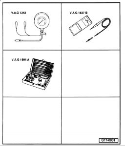

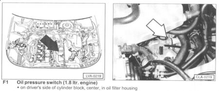

Is it easy to change the oil sensor in the sump? My oil warning light come on sometimes when I drive at high speed, I check my oil level, It is ok, I posted and donated before. Thank you so much.

Oil Pressure Switch (1.8 Ltr. Engine) F1

Special tools and equipment
https://www.2carpros.com/forum/automotive_pictures/12900_opa1_1.jpg
V.A.G 1342
V.A.G 1527 B
V.A.G 1594 A

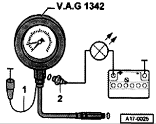

Testing oil pressure switch
*Disconnect wire from oil pressure switch.
https://www.2carpros.com/forum/automotive_pictures/12900_opa2_1.gif
*Remove oil pressure switch and screw in oil pressure tester VAG 1342.
*Thread oil pressure switch -2- into VAG 1342.
*Connect brown wire -1- of tester to Ground
*Connect voltage tester VAG 1527 B to oil pressure switch and positive side of battery using test leads from VAG 1594 A.
*Test lamp should not light up.
*If test lamp lights up, install new oil pressure switch.
*Start engine.
Note: The switching point of the oil pressure switch can be reached when the engine is cranked on the starter motor, so watch the tester and the test lamp while starting the engine.
Black oil pressure switch:
*LED must light up at 1.2 to 1.6 bar.
*If test lamp does not light up, install new oil pressure switch.
Check oil pressure
https://www.2carpros.com/forum/automotive_pictures/12900_opa3_1.gif
*Start engine (engine oil temperature approximately 80 °C) .
*Oil pressure at idling speed: at least 1.3 bar
*Oil pressure at 2000 rpm: 3.5 to 4.5 bar
If specified values are not attained:
*Pressure relief valve or oil pump faulty, replace oil pump

Thank you for your answer, so first I need to change the oil switch, if the warning light still come on that means oil pump need to be replaced / Thanks again.
