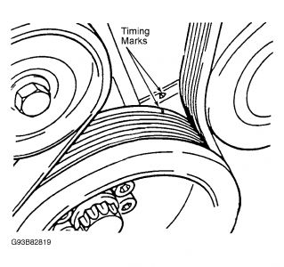

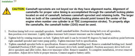

i just changed the valve cover gaskets and the water pump and now the car will turn over but not start. i had to take off the timing belt and i didnt know you needed a crank holder. I need to know how to adjust the time and how to a line the marks? it is not getting spark. after it wouldnt start i changed the plugs and wires. i tried to find the repair manual put can only find the one that is for all the 1992 Audi 100, but the v6 for some reason
