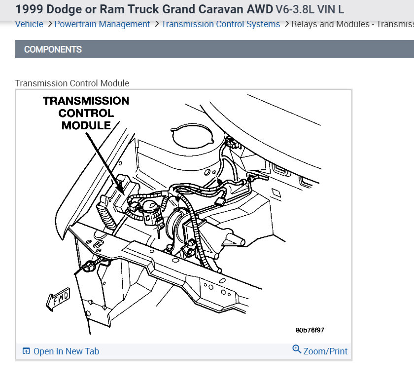

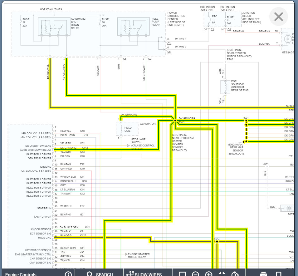

Can you give me the fuse numbers that keep blowing? It sounds like transmission control module, or a shift solenoid could be shorting out, but I need the fuse numbers to be sure. Here is where the TCM is located so you can check it out, this control module is subject to moisture because of its location. I would remove the electrical connector and look for corrosion. Check out the diagrams (below). Let us know what happens and please upload pictures or videos of the problem.

The reason you were able to get the vehicle to start with jumping the ASD relay is because this relay controls the injectors and coils.
