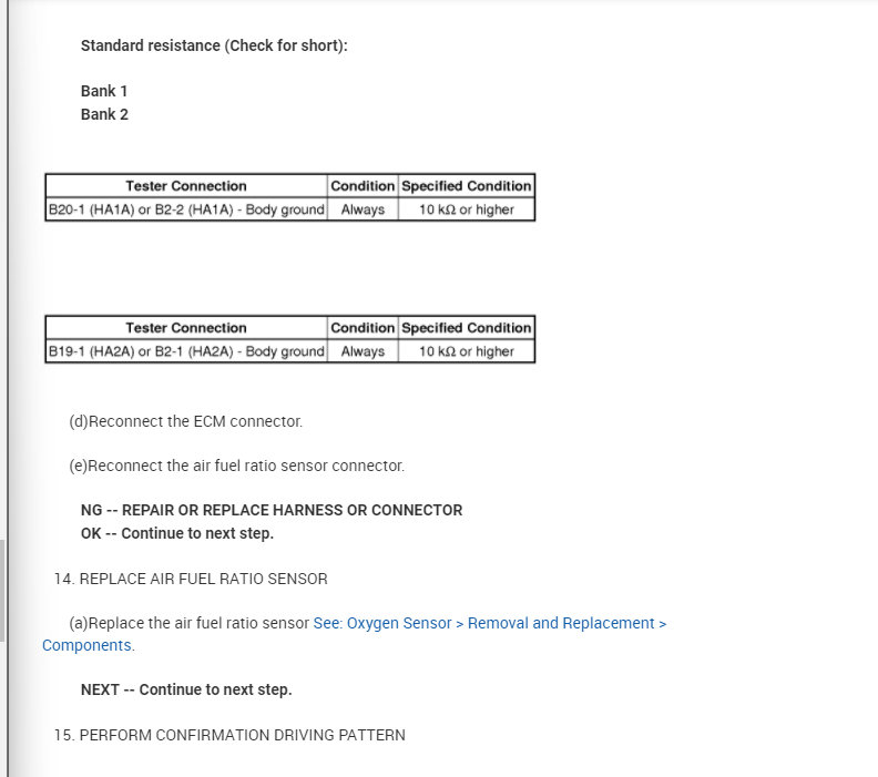

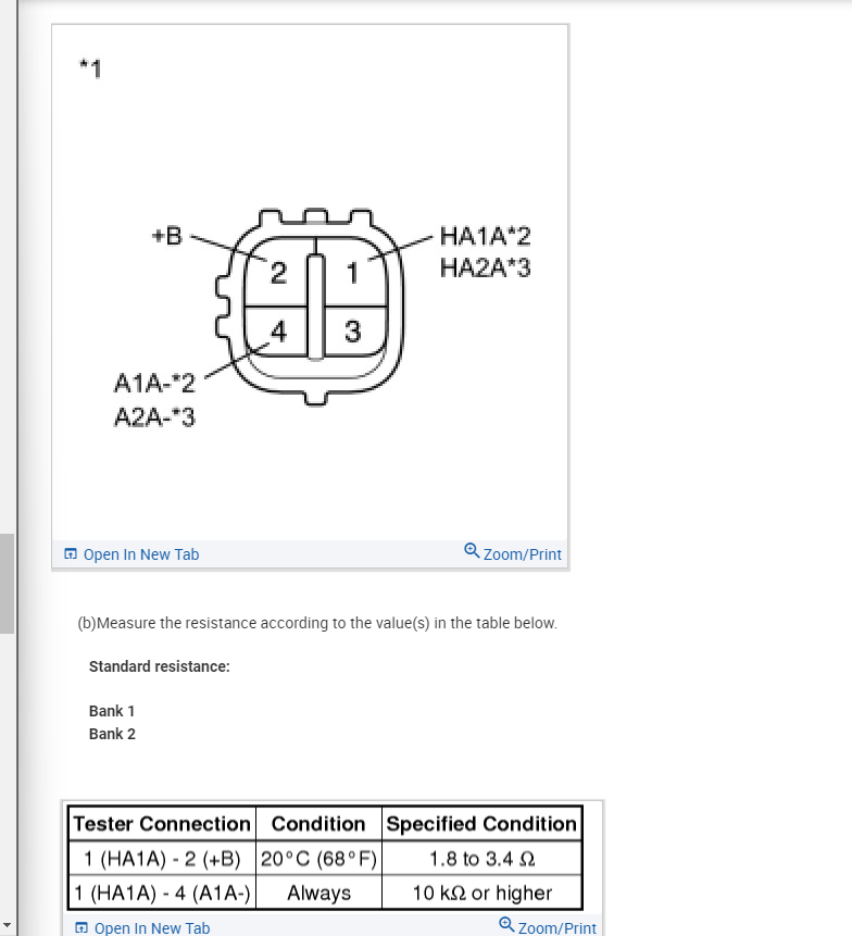

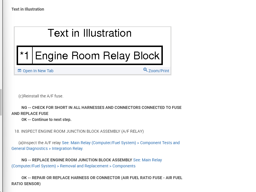

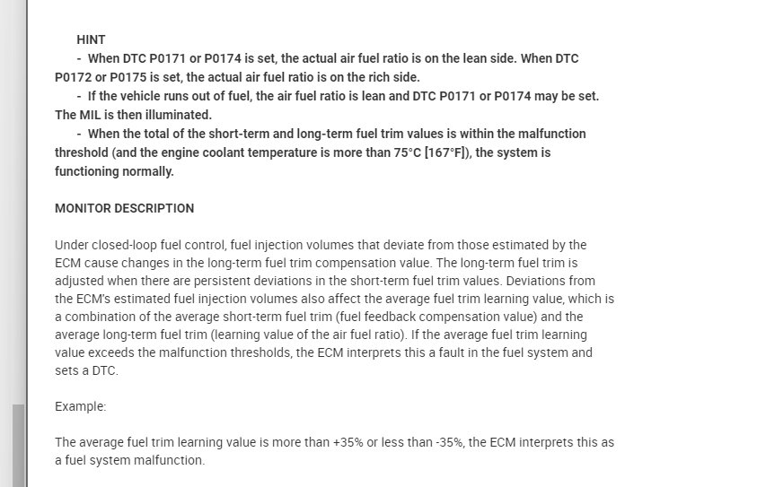

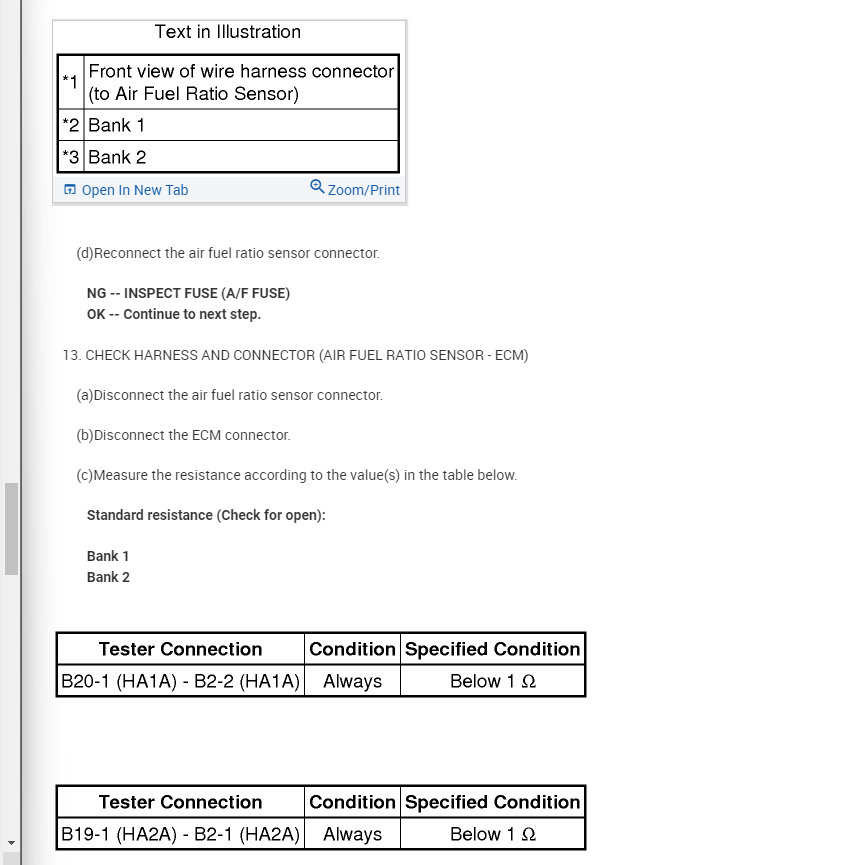

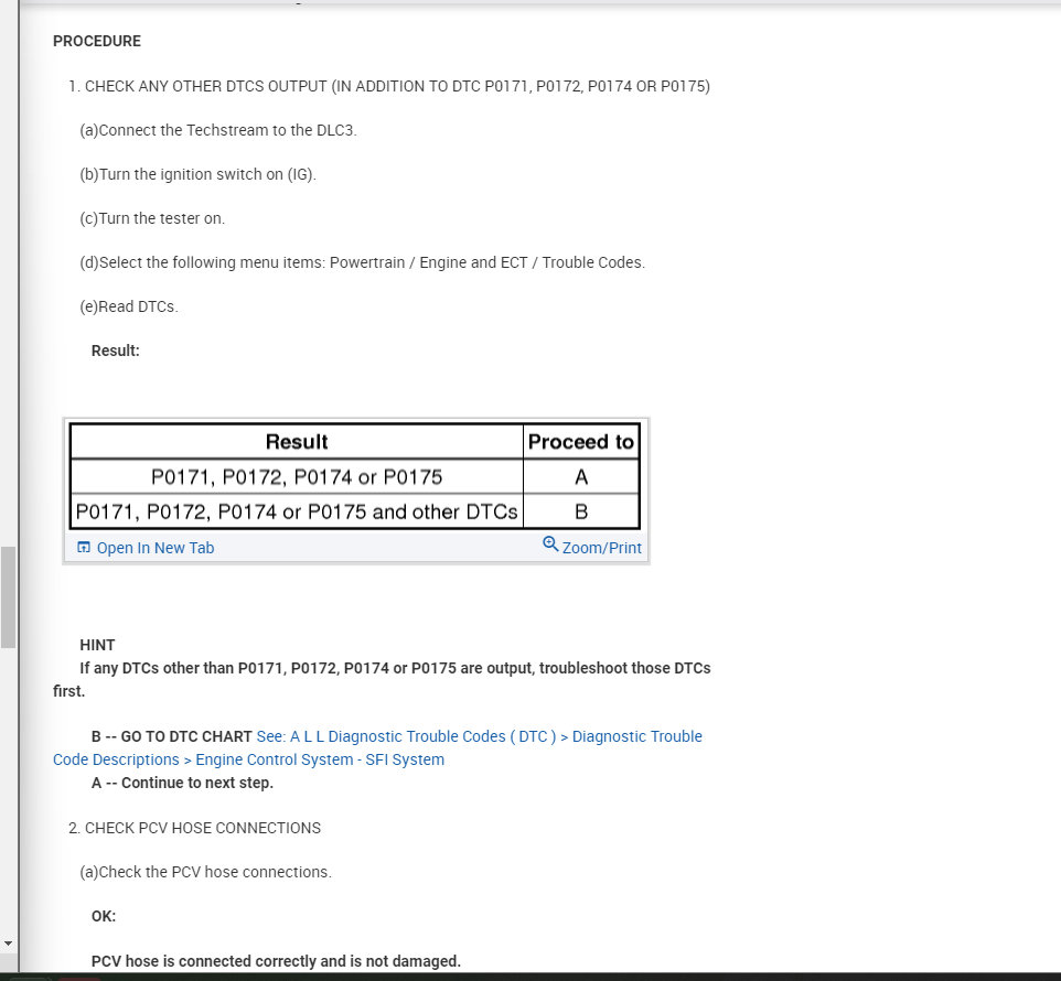

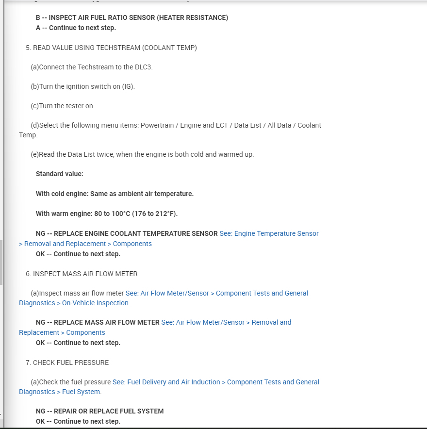

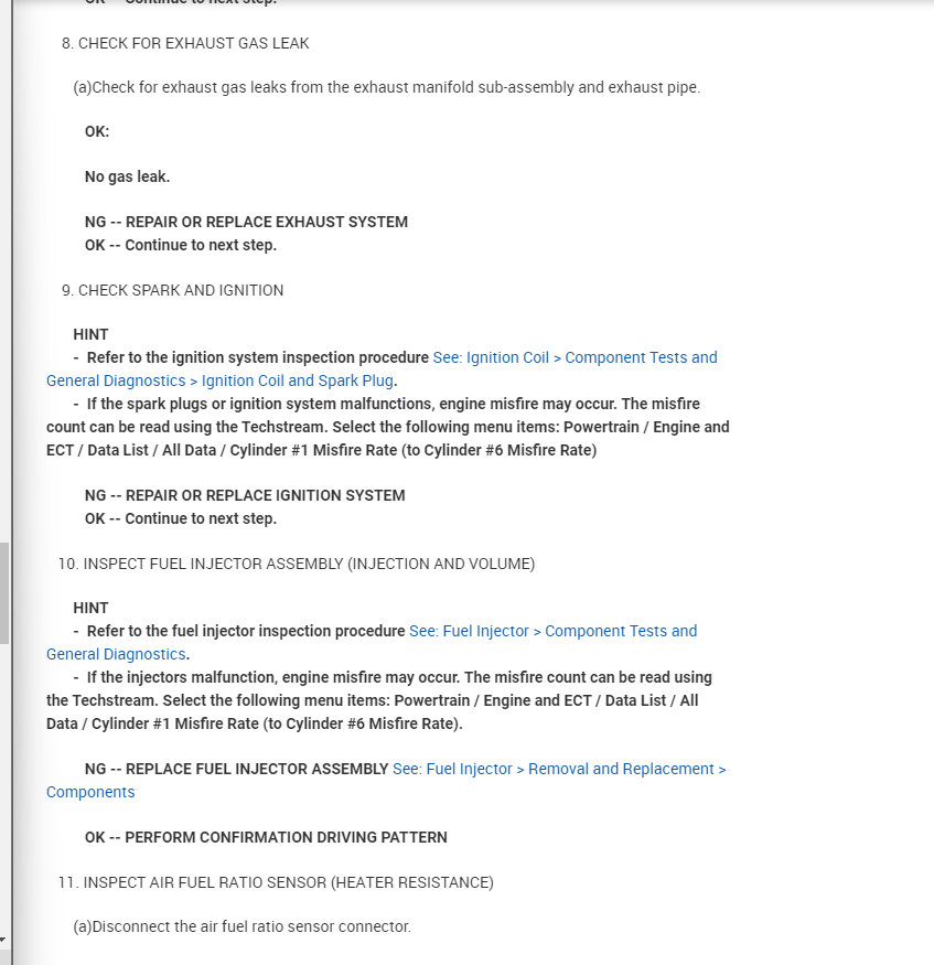

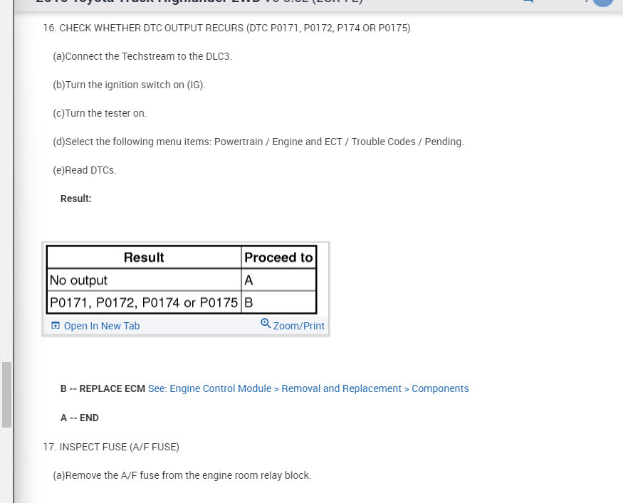

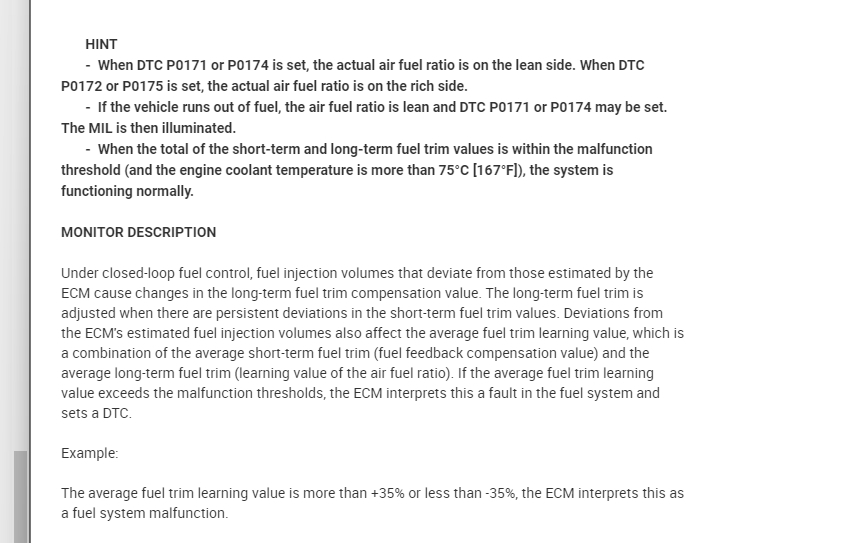

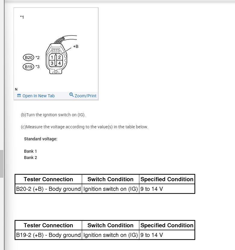

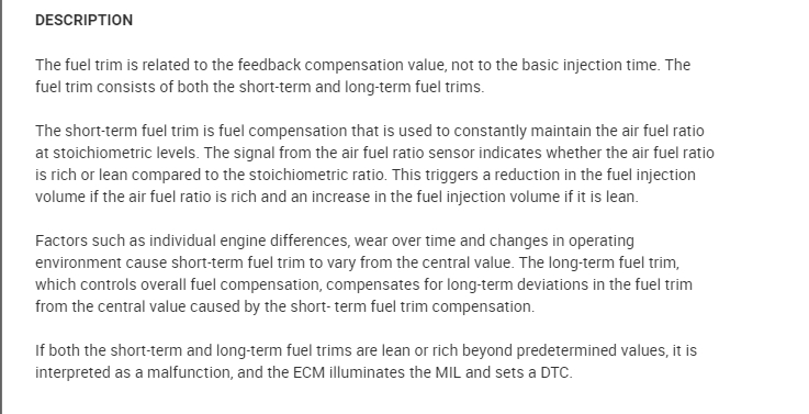

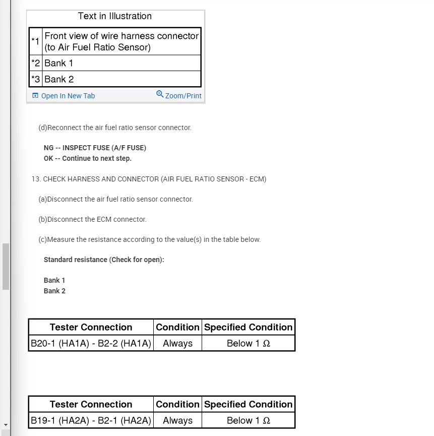

Just to add to what Boris said because I think it is important to ensure we cover the basics on what these codes are telling us. I think we are on the same page, but I want to make sure.
Basically, these codes are telling us that the engine has high oxygen content in the exhaust.
This means there is less fuel in the exhaust to maintain the ideal air fuel mixture.
This could be due to a vacuum leak as you mentioned that is allowing air to come in past the air sensors, so the PCM doesn't know the air is coming in. This is called unmetered air.
Or this could be due to a fuel supply issue that is not supplying the proper amount of fuel causing the mixture to be lean.
To answer your question of what we can evaluate your logs online, yes, we can.
However, what we should start with is just monitoring the o2 sensor data and confirm that they are showing a lean exhaust on short term and long-term data.
This is what Boris mentioned above.

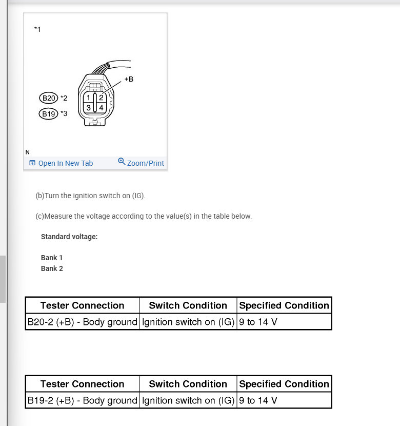

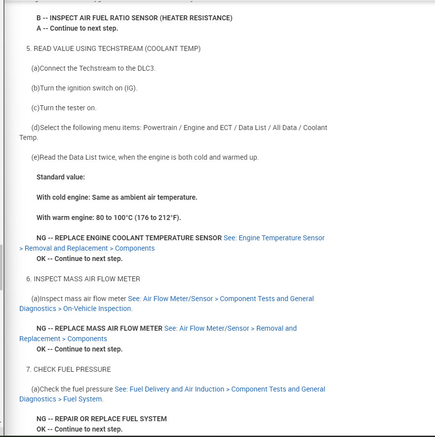

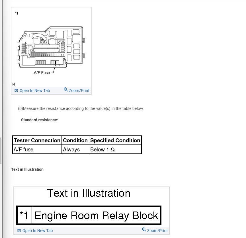

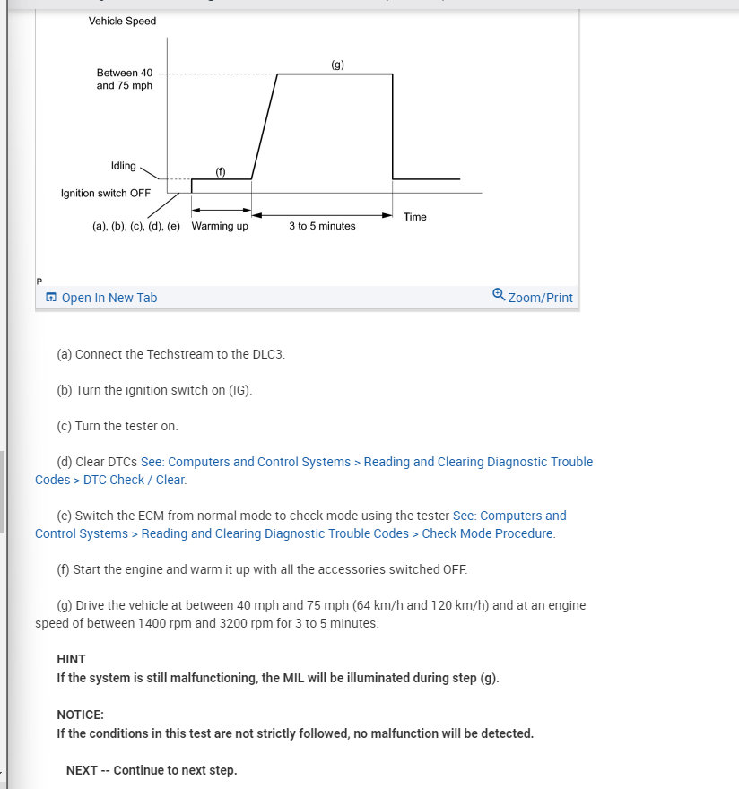

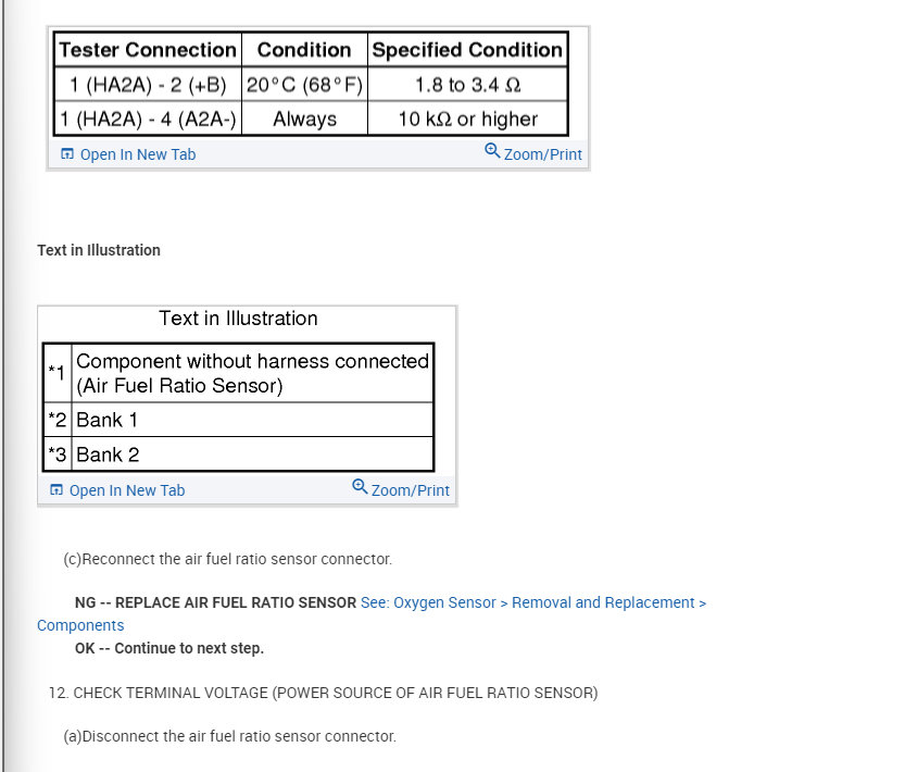

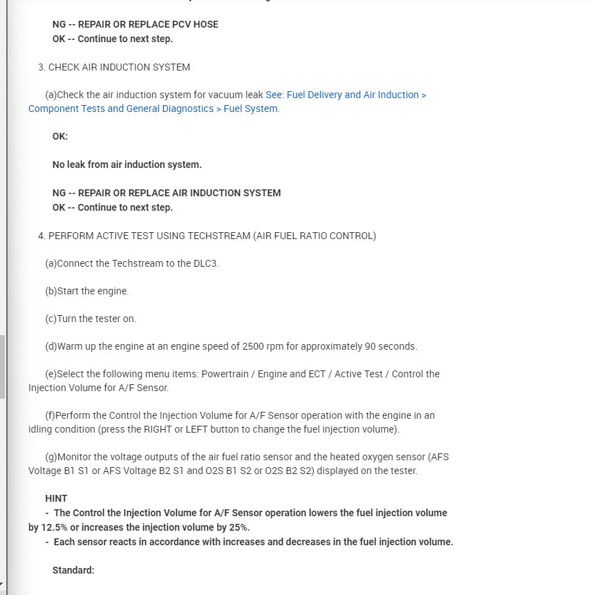

I am going to attach some info below on these codes. This is all the testing that we would need to run through. However, this also will list all the other possible causes of this which includes o2 sensor issues and PCV system.
So, let's run through this and let us know what the o2 sensors are reading and we can go from there.

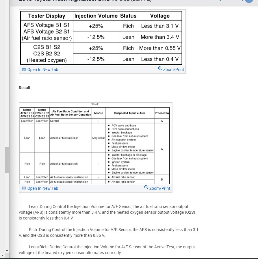

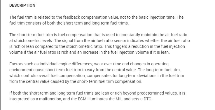

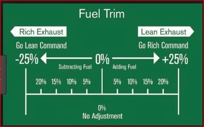

Just to confirm your long-term fuel trims are positive, 20% at idle.
If that is positive, then that is a command to add more fuel because the exhaust is very lean. This would mean there is more oxygen in the exhaust than it wants to see, which is normally a vacuum leak that is allowing unmetered air to come in.
It could also mean that you have intake valves hanging open which will result in different performance issues.

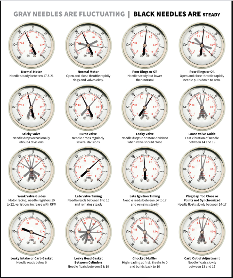

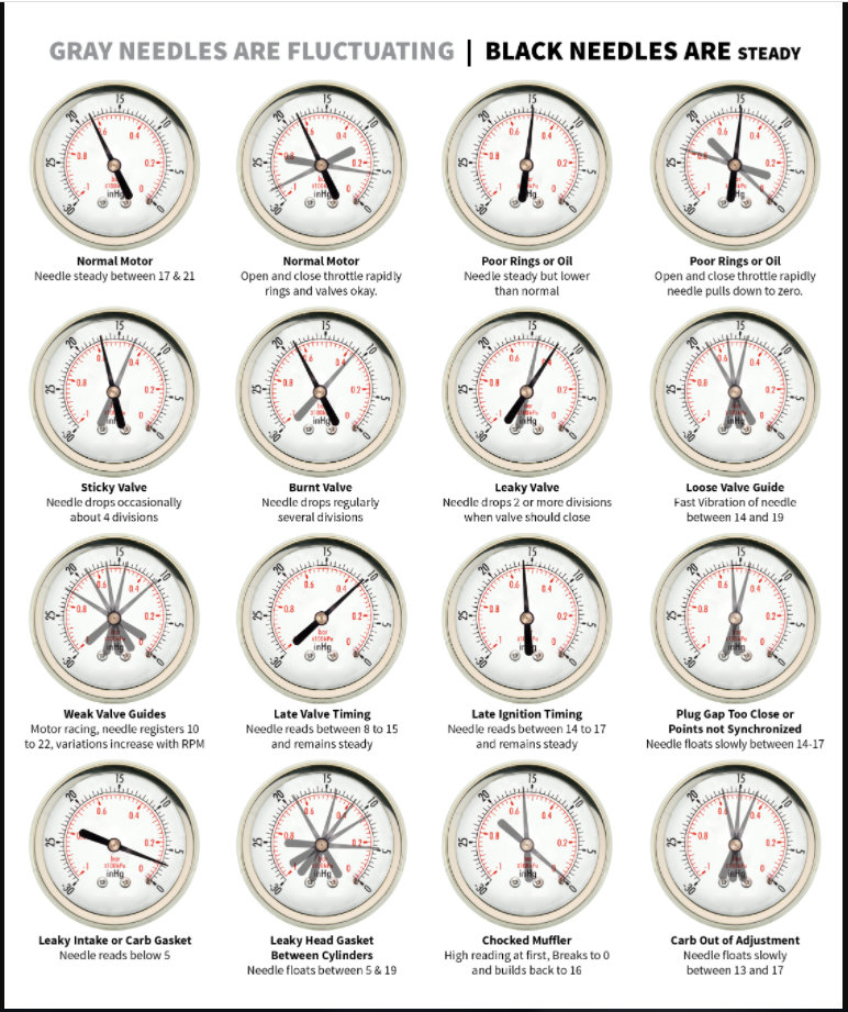

You can check both of these using a vacuum gauge.
Check out the charts below. You could still be correct that this is PCM issue, but I just wanted to make sure we were straight on the positive vs negative fuel trims.
