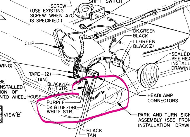

I have the vehicle listed above, 4 door. The front turn signals were flashing on both sides on either left or right turns. I don't believe the parking lights were working, and the rear turn signals/brake light are working properly. When I pulled the pass lens to check the bulb, I found that some had replaced the front sockets with newer ones that have 3 wires. the center one is the ground, and if I disconnect one of the outer wires, the front turn signals work correctly, but no matter what I do, I can't get any front parking lights, but I seem to remember some of the early 60's cars not having front park lights.

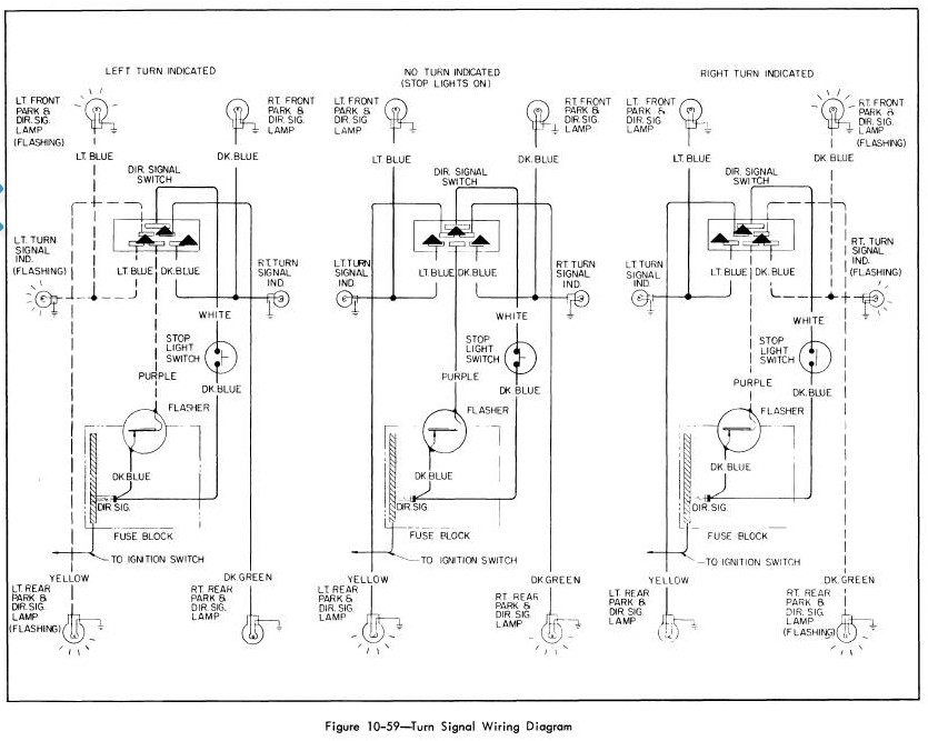

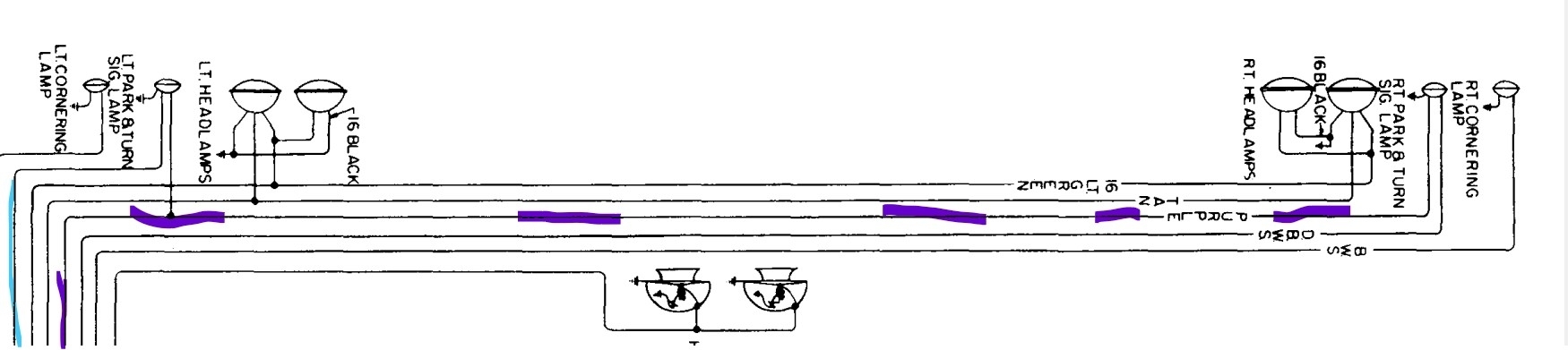

The 64 should have front parking lights that come on with the taillights. The turn signals should be the light blue (left) and dark blue (right) The bulb should be an 1157A (2 filament amber glass. 32 cp turn, 4 cp parking) The parking lamp feed should be a purple wire. The stock unit uses only 2 wires, the bulb ground wasn't wired in it was the shell of the lamp in the metal lamp housing with the ground coming from the lamp housing bolted to the bumper and the bumper bolted to the frame. If someone has changed those out for different holders with 3 wires you need to sort out which one is ground. For that use a test light and turn on the turn signal and probe the wires, the one that flashes is the turn for each side. Now turn on the parking lights and find the park light feed. Now check that the ground is actually connected to a ground. Attached are the OE wiring and routing.

Thank you for the reply. I believe my issue is the aftermarket newer style sockets someone had previously installed on both front lights. I am going to check the wires for signals and park lights with the sockets disconnected and replace the sockets with originals style.

They likely didn't connect them properly. Your description sounds like the lights are trying to ground through the bulb and not through the proper ground. As such you turn on the marker lights but they don't see a ground because the turn signal side isn't connected when the switch isn't in either turn position. However when you select the turn position the power goes through one side of the bulb and then jumps to the other filament and finds a ground path through all of the other marker bulbs.
