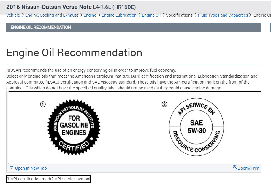

The first thing to remember is this. Oil doesn't wear out. It gets dirty and contaminated. If you change the oil with the manufacturer's recommended oil weight within 5K miles or a year, you are certainly going to be fine.
The reason it is recommended within a year if the mileage isn't reached, (not 6 months) is simple. Engine oil can absorb moisture from the atmosphere, especially in humid environments. This can lead to the formation of acids within the oil, which can corrode engine components and cause additional wear.
So, if you are changing it every 5K miles or up to 1 year, you are fine. However, a heavier-weight oil is questionable. Remember, the heavier the weight, the longer it takes to move it. Most engine wear happens when it is first started and oil is starting to pump. The manufacturer recommends 5w30 (see pic 1) for this vehicle, so although heavier-weight oil shouldn't hurt (especially if you are in a hot environment) it really isn't needed.

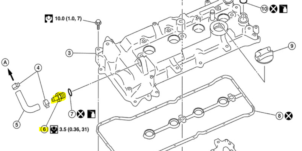

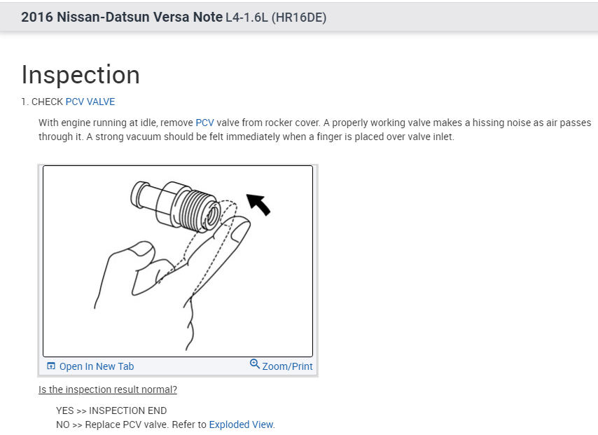

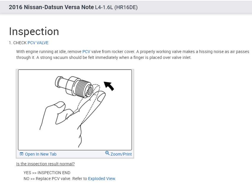

Also, you mentioned the PCV. If it is plugged, it will increase crankcase pressure and moisture to develop in the engine and oil. So, make sure it is in good condition and there are no leaks. See pics 2 and 3 below for testing and location.

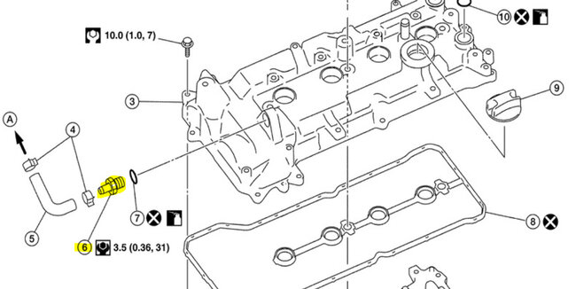

Thank you JakobAndNickolas, I forgot to mention that I live in Central Florida and the temperature there never drops below 25 Fahrenheit or -4 Celsius and I have heard that 10W oil is good for temperatures as low as 0 Fahrenheit or -18 Celsius while the 40 weight oil cushions the engine better than 30 weight oil when the engine is hot, and Florida's lowest temperature ever is -2 Fahrenheit or -19 Celsius which happened in Tallahassee in far North Florida in 1899, and I heard that 5W oil is only needed when the ambient temperature is below 0 Fahrenheit or -18 Celsius, I have a question about the PCV valve diagram or graph or composite sketch, it shows the valve cover is being removed, do I need to remove the valve cover to access the PCV valve? Because when I looked at it in the engine compartment I saw that the PCV valve is external and externally attached to the valve cover and all I might ever need to do is pull the PCV hose clamp, PCV hose, and unbolt the threaded PCV valve and PCV valve O-ring style gasket, thank you in advance for enlightening me and informing me JakobAndNickolas, Alexander Stathas

Hi Alexander, the PCV is external. The pic I have is an exploded view that takes everything apart. LOL And I'm a little (lot) north of you in PA.
You shouldn't have any issues with replacing it. Also, since you are in FL, check to make sure the rubber hose is in good condition and still flexible. Extreme heat can cause them to get brittle and crack over time, especially when working on it. It could cause an engine vacuum leak.

The PCV won't cause engine failure, but it will cause a rough idle if there is a vacuum leak. As far as the heat is concerned, keep in mind, the under-hood temperature is much higher. With the vehicle being 9 years old, it could have dried up or cracked, so take your time and inspect it.
If you want to check for vacuum leaks, here is a link that explains how it's done:
