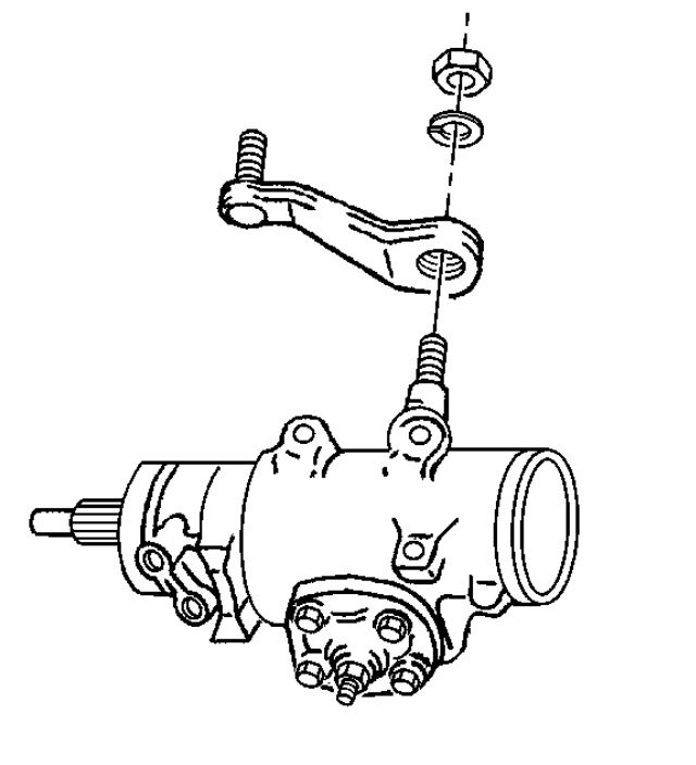

Any tips on taking off the Pittman arm on the front driver side
2006 CHEVROLET AVALANCHE
95,000 MILES • 5.3L • V8 • 4WD • AUTOMATIC
WILL REY
  • 31 POSTS
Cannot find any videos on instructions for this vehicle. Cannot even get the nuts off and it is such a tight fit even if i did i would not be able to take of the arm out. Any one know any good videos on this truck's Pittman arm dissemble? I have had no luck finding any information on it online. :(

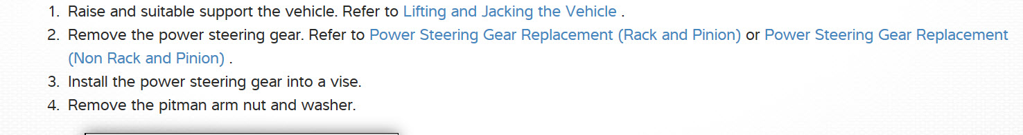

if you are going to reuse the Pittman arm then the box has to come off put in a vise then a puller must be used to pull it off which is no easy task removing them. if you are not going to reuse it , use a cut off wheel cut it then split it it will fall off practically.

if you live in a northern area pitman arms were always are difficult to get off due to salt and other crap making it very very hard to get off. I have personally broken pullers trying to remove them
