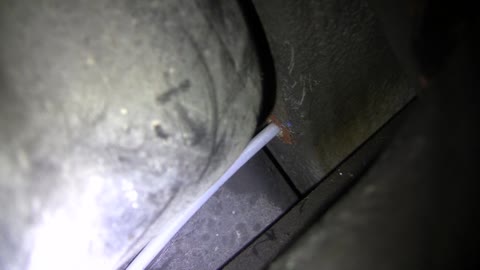

Everything has been done apart from the parking brake cable being reinstalled. It has been installed at the hub end and attached to the parking brake shoes, but when trying to route and snake it back into the chassis so that it can be attached to the handbrake, it is impossible to put back.
The length of threaded rod goes into the hole where the cable originally exited the chassis, but it goes no further and there is approximately 18" of cable left to thread back in.
I have been trying to find any information about how the cable gets to the handbrake, looking for diagrams of where the cable goes (after entering the hole) and what, if any, obstacles there are to getting this done.

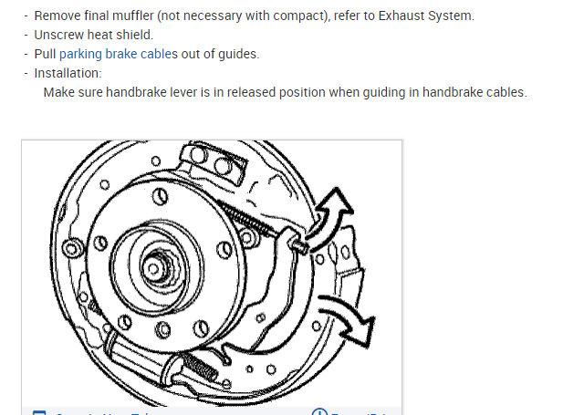

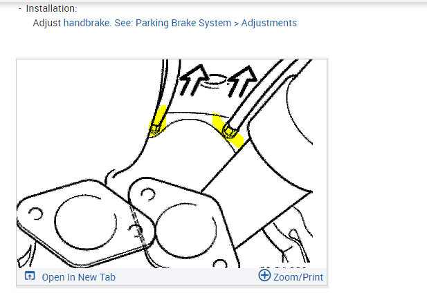

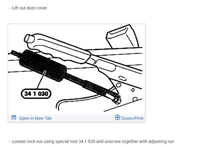

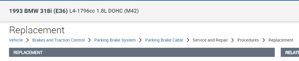

The 320i wasn't offered in the US this model year. I'm showing a 318i and a 325i. The information I have for both is limited to replacing the cable and doesn't show a point of entry.

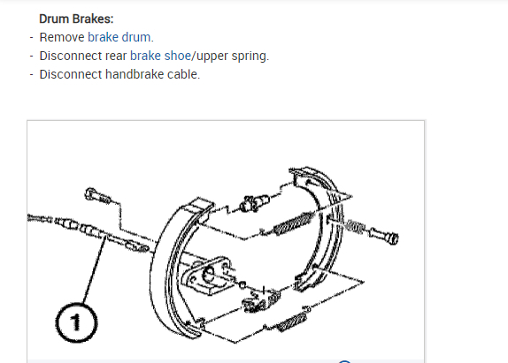

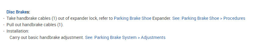

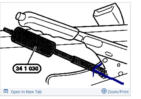

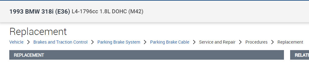

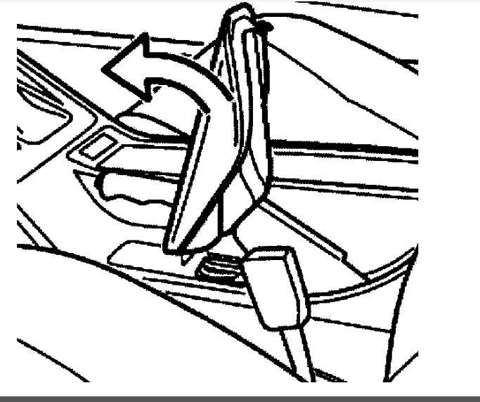

By chance, could you upload a few pictures of what you are dealing with? I may have a suggestion or two. Also, I attached the directions for replacing the cables on a 1993 318i below so you can see what I have. I noted that the directions for the 325i are basically the same.

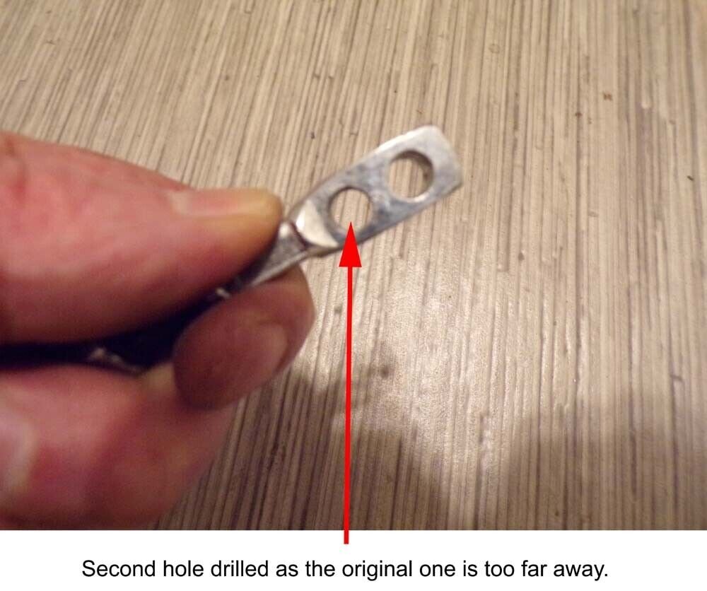

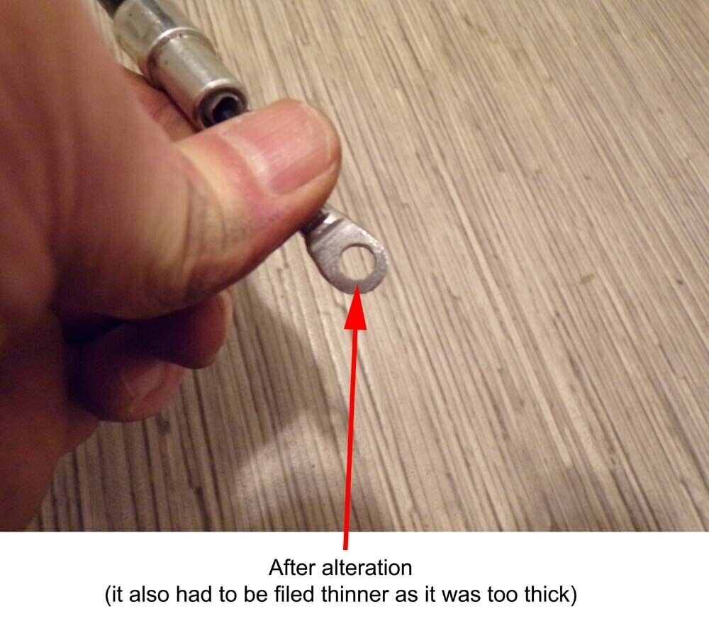

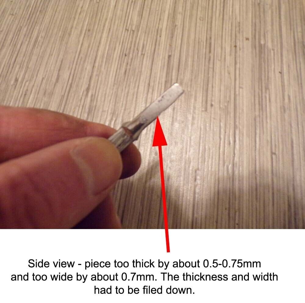

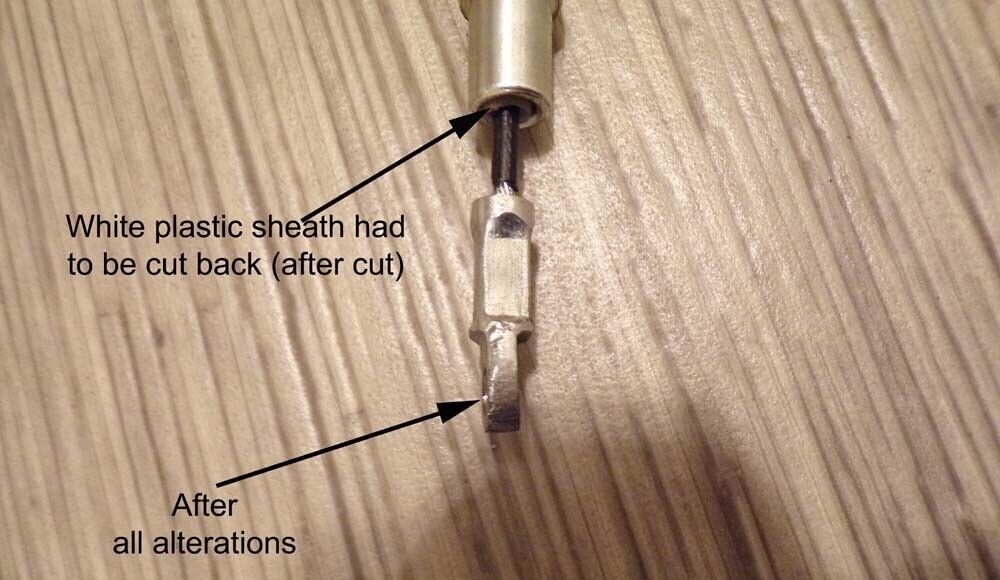

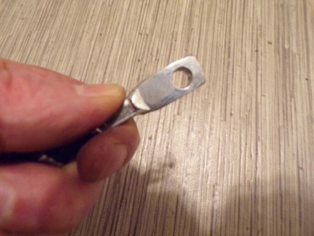

I had to do extensive modifications to the new cable at the brake shoe end (see images) and I have just had a thought that maybe I need to file down the metal at the base of the threaded rod as it is slightly 'fatter' there.

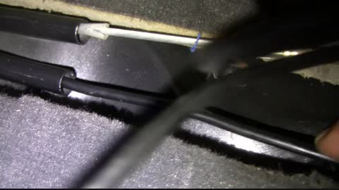

Here is the video of what I am up against. Was I meant to push into the hole in the chassis (that is shown at the beginning) the hand brake end of the black cable (with the metal bit) first?

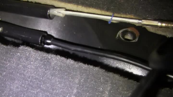

I would think that is how it would have to be done. Are you able to run a piece of mechanics wire from the inside through the chassis to where the cable is located? If it is a problem with the cable stopping before it fully enters, you may be able to guide/pull it through.
Let me know. Also, does the attached pic appear to be the same as what you have?
See pic below.
Mar 7, 2024 at 9:31 AM
CHRISTOPHER SA
  • 255 POSTS
Yes, that is how it is at the hand brake end.

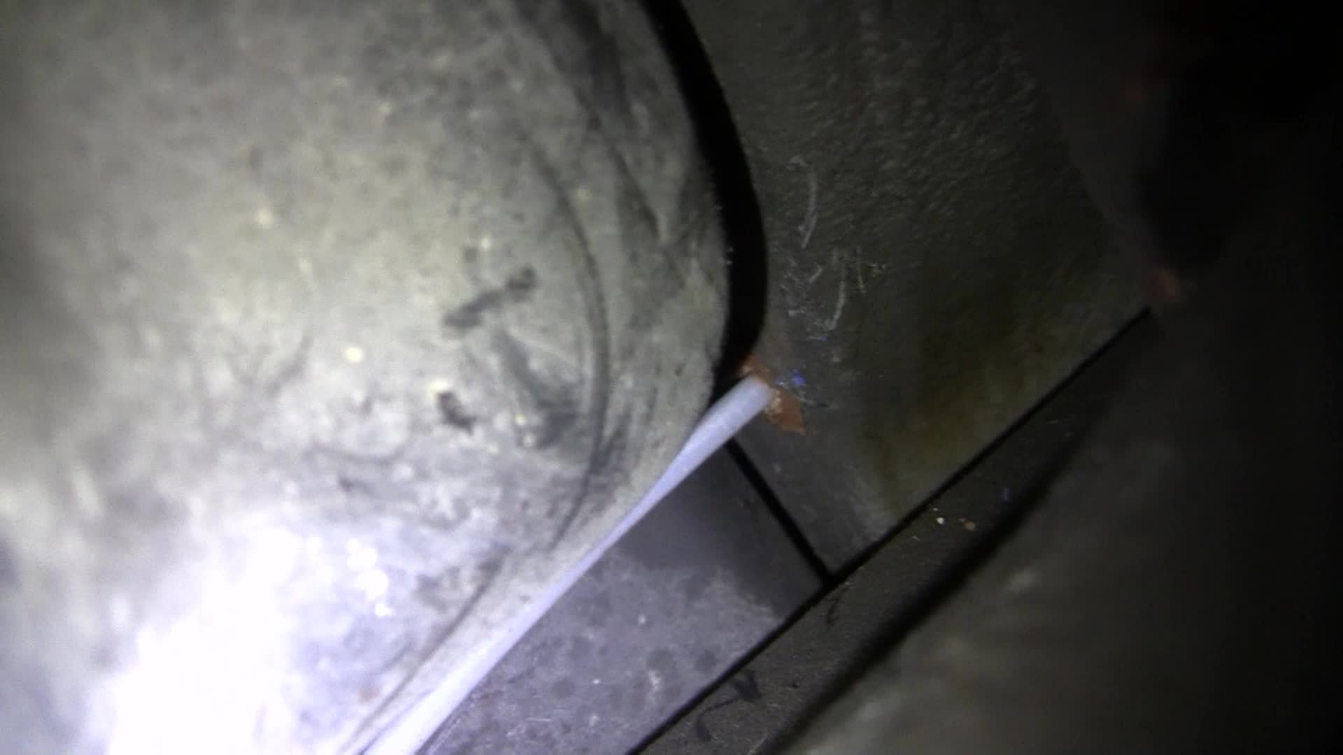

An update.

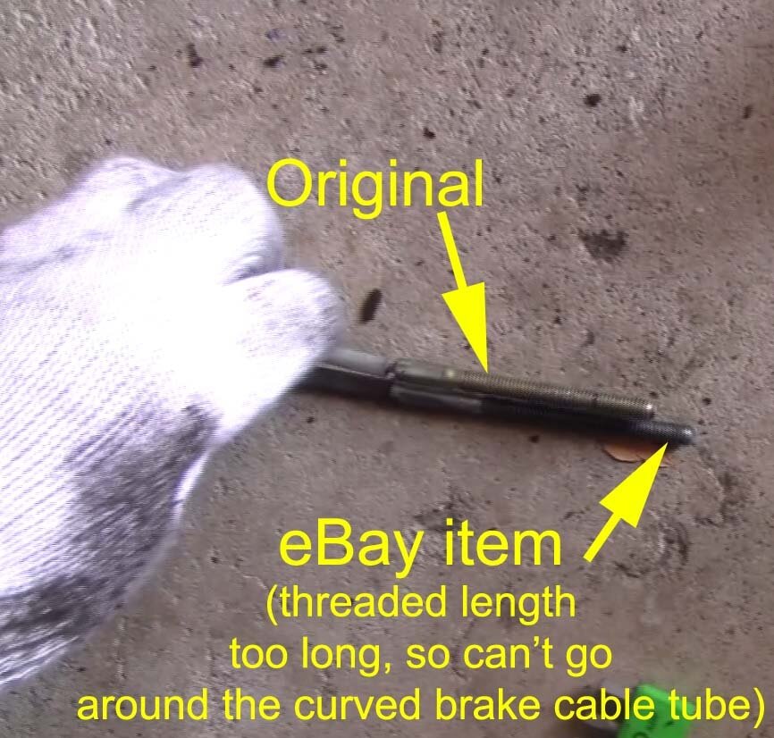

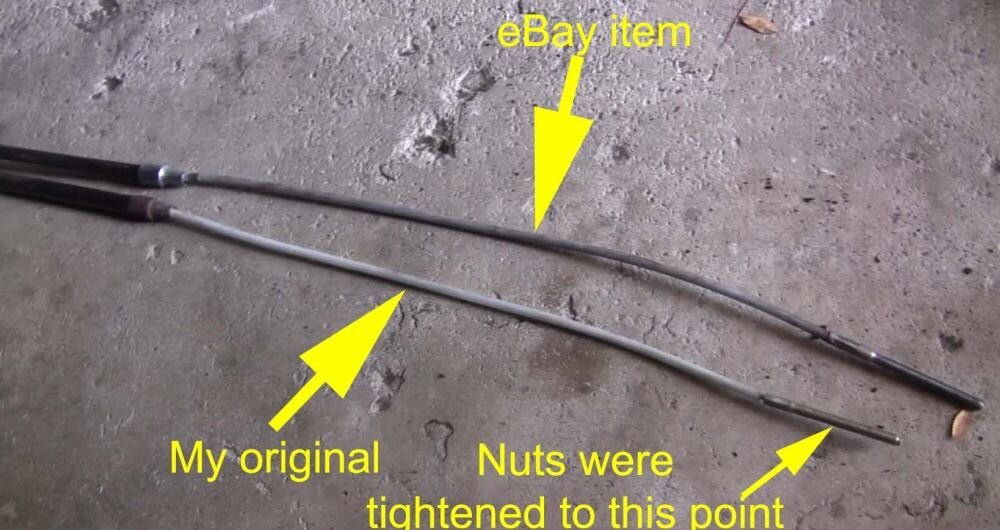

Yesterday, after over a week of trying to get this cable fitted with no luck, I discovered what the problem was the wrong length of cable and the wrong length of the threaded end! See images for a clear explanation.
The end with the thread was 0.5" too long which prevented it from moving around the curves in the tube that went to the hand brake. The tube went from the top of the transmission tunnel, along it for little ways, then curving over to the top of the tunnel to the hand brake. That extra 1/2 an inch prevented it from moving around those curves. And that is why it wouldn't go in beyond a certain point!
I also have a video of the tube itself, as I purchased an endoscope to see what the heck was going on inside the tube/chassis, which I will post soon. But that threaded end was long enough to prevent it moving through those curves. Needless to say, I am getting a refund on the eBay item and have ordered a new cable locally which I will be picking up on Thursday (tomorrow).
Note: The original cable looks in better condition than the new one. The original was rusted into the hub end and the plastic had cracked at the juncture between the metal ferule and the cable. So, I went ahead and tried replacing it.

I finished all the work on the suspension/wheels on all four corners but here is the video dealing with the parking brake cable which was so easy to install!
In the end, the correct cable made it a 5-7 min job not a two-week job!!! I got a refund from the seller of the wrong cable. Shame I had to go through so much time and expense to figure out what was going on.
