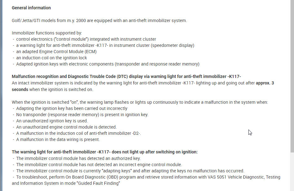

Anti theft system triggered, won't let car run.
Mar 29, 2021 at 12:34 PM
Experienced Mechanic
18,907 POSTS

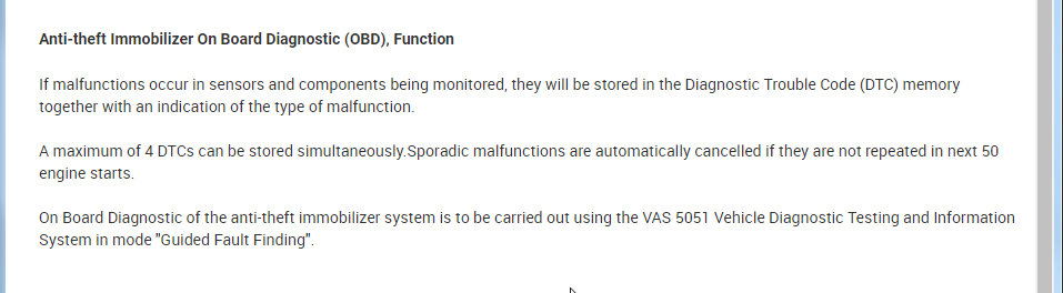

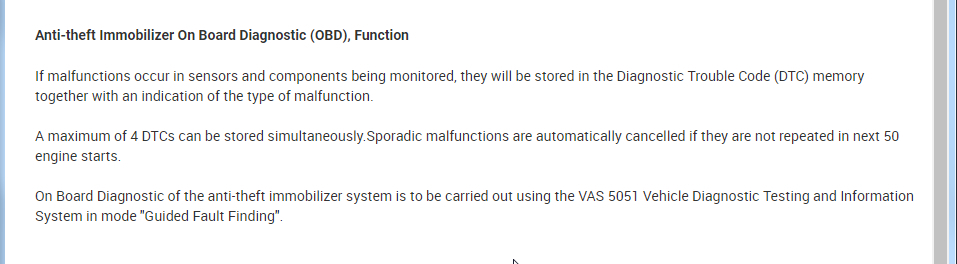

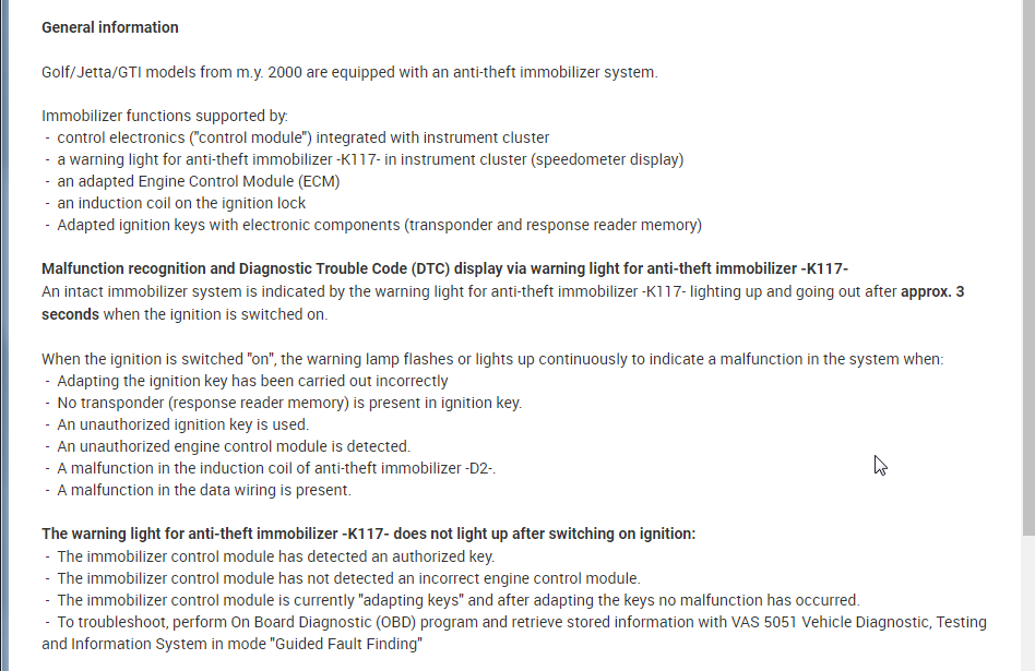

More then likely we have some codes to point us in the right direction.
Below is the info about this system but we need to check for codes.
Let's check for codes and find out what is there. Then we need to know if the key you are using is a valid key or recently had any other issues?
Let's start with this info. Thanks
