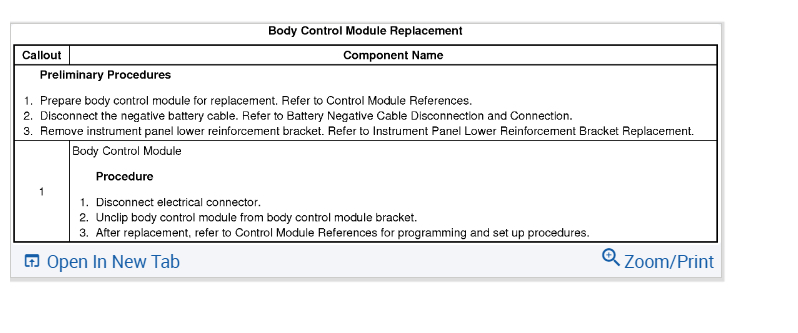

Anti-theft system was triggered and after replacing the battery with a new one the dashboard lights are flickering the radio will not turn off when the car is off and the anti-theft system symbol is lit up.. after leaving the key in the ignition on the on position for 10 to 15 minutes the anti-theft symbol will go away eventually and then I'm able to start my car but as soon as I turn it off, I have to go through the process all over again.

It sounds like you have a voltage surge that took out the BCM, but to be sure let's run a CAN scan. you can get a CAN scanner (Controller Area Network) which will work on most cars from Amazon.
here is a video to show you how:
https://youtu.be/u-4syLc-ifQ

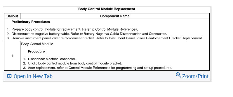

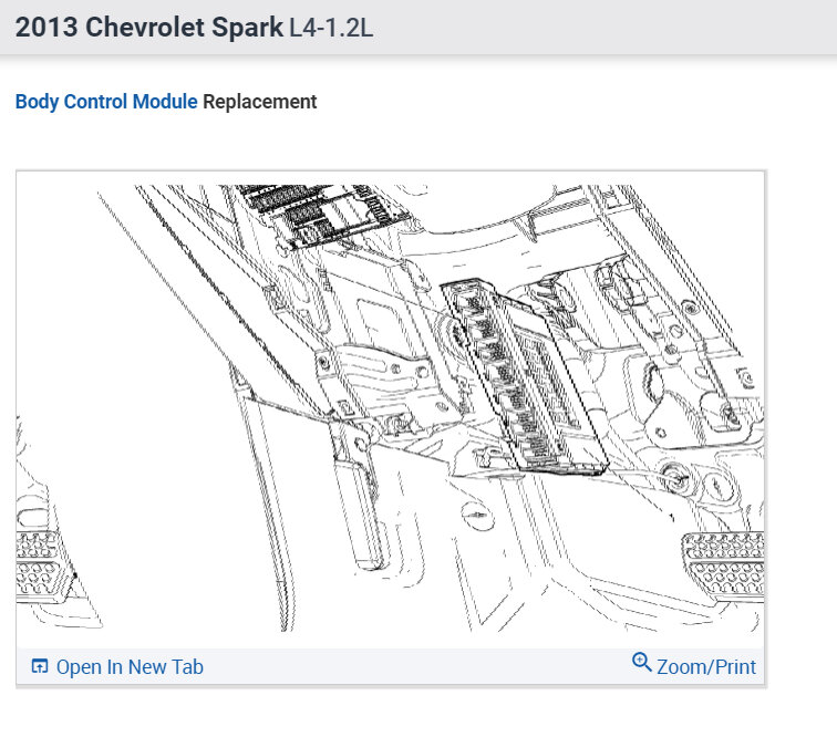

Here is how to change out the BCM, you can get a preprogrammed unit by searching Google or Ebay. It looks like it is under the dash on the driver's side. Check out the images (below). Please let us know what happens.
