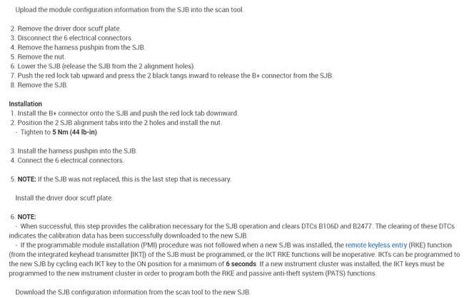

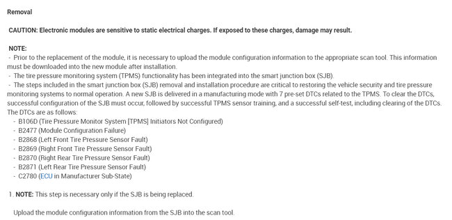

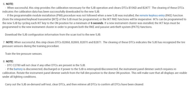

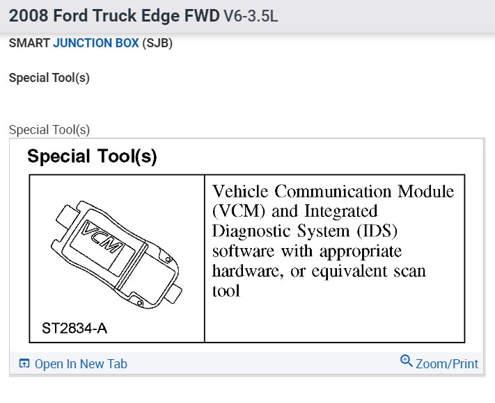

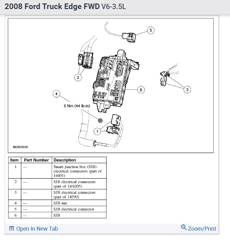

It sounds like the SJB is out which is common, here is how to replace it in case a code comes up for it. Check out the images (below). Please let us know what happens.
