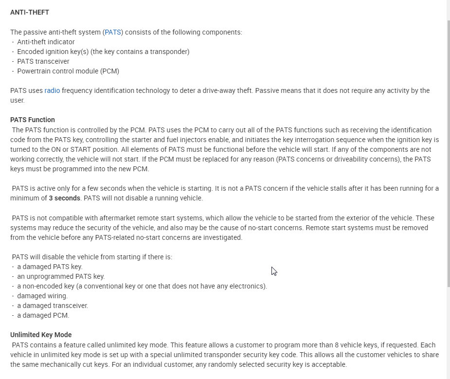

Will not start and anti theft light is on.
Nov 1, 2019 at 3:09 AM

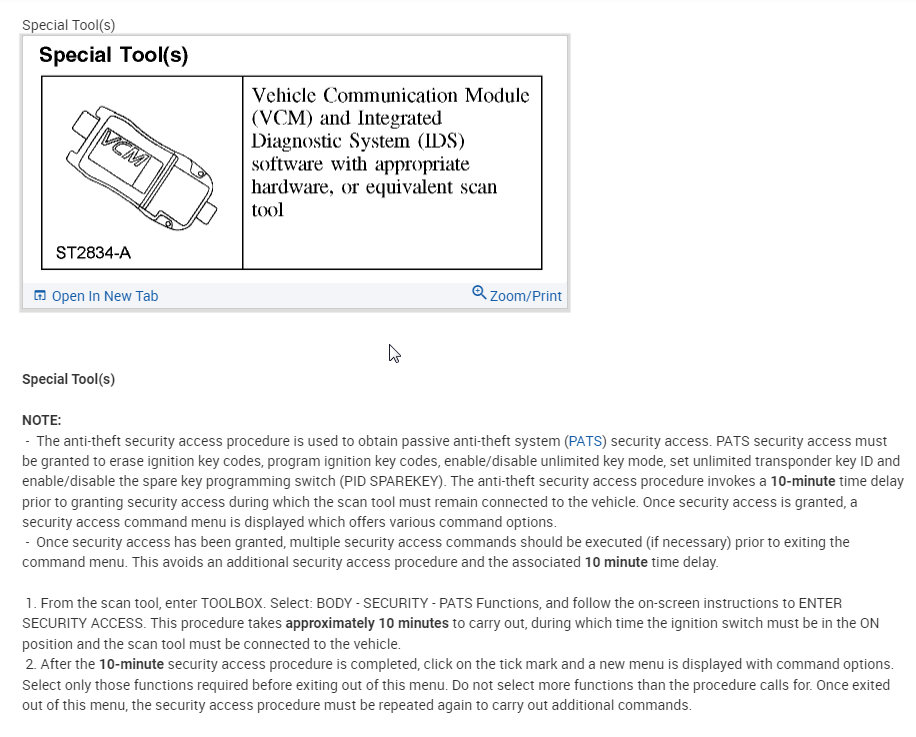

We need to start with pulling codes. More than likely this is just a key issue but there should be some codes that will point us in the right direction. Without the codes, we are just guessing as to what the issue could be.
Here is some information about the system that explains this in a little more detail. Let me know what you find and we can go from there.
