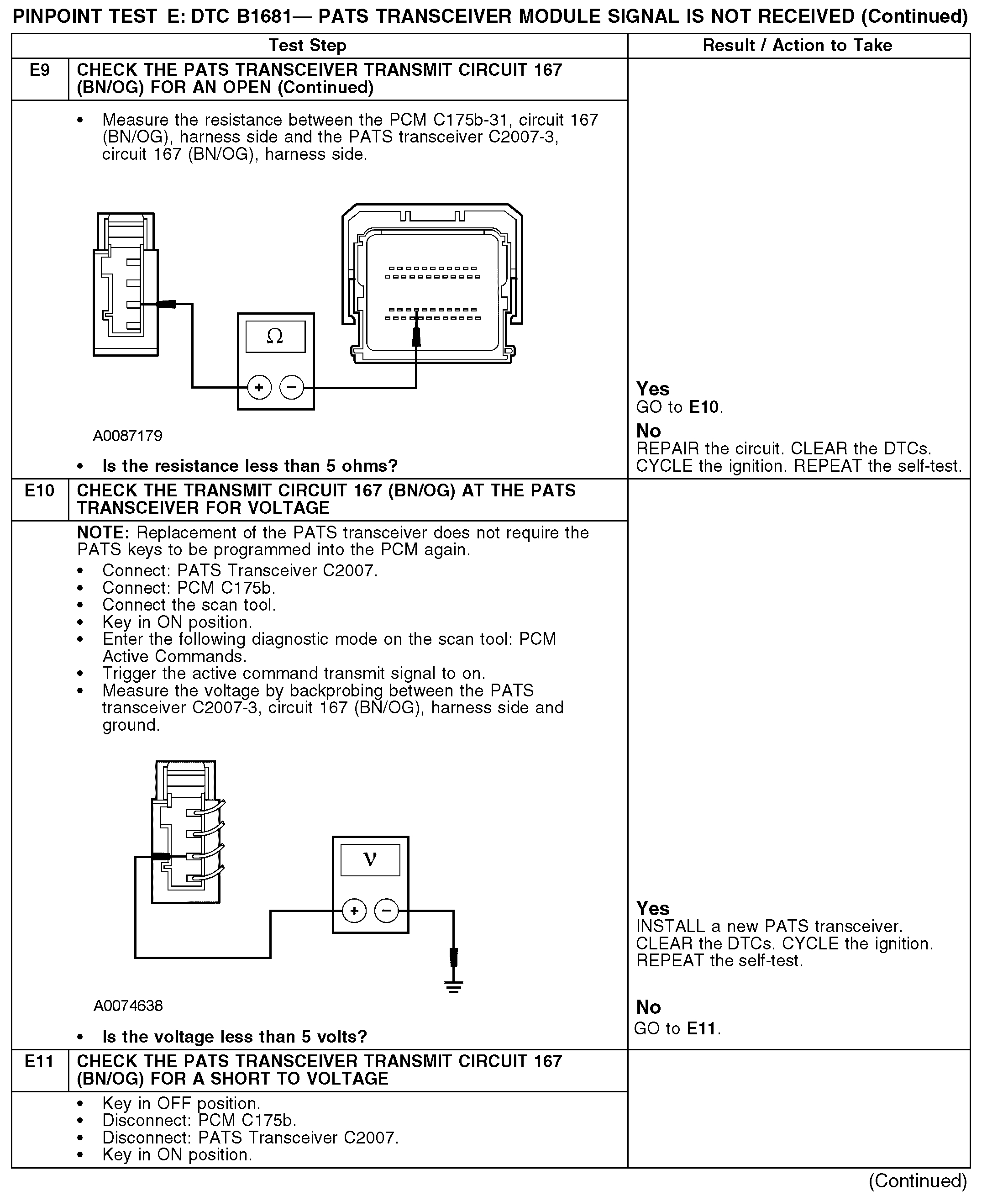

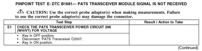

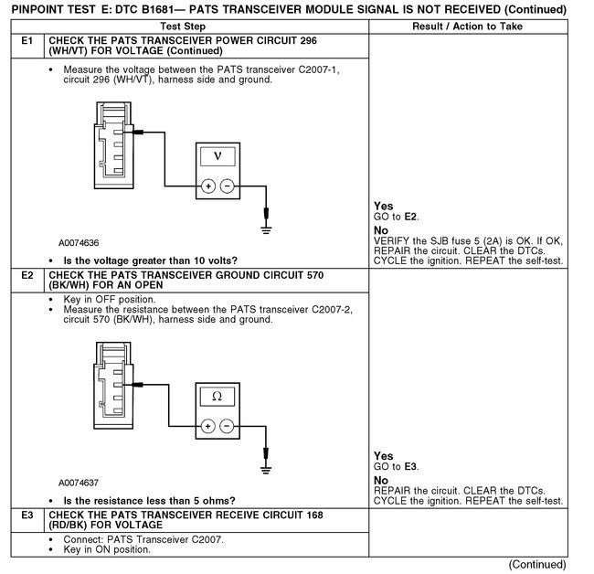

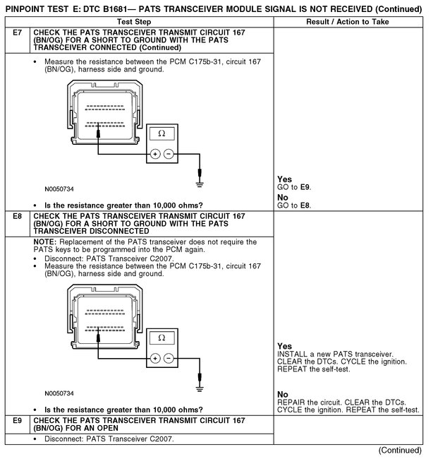

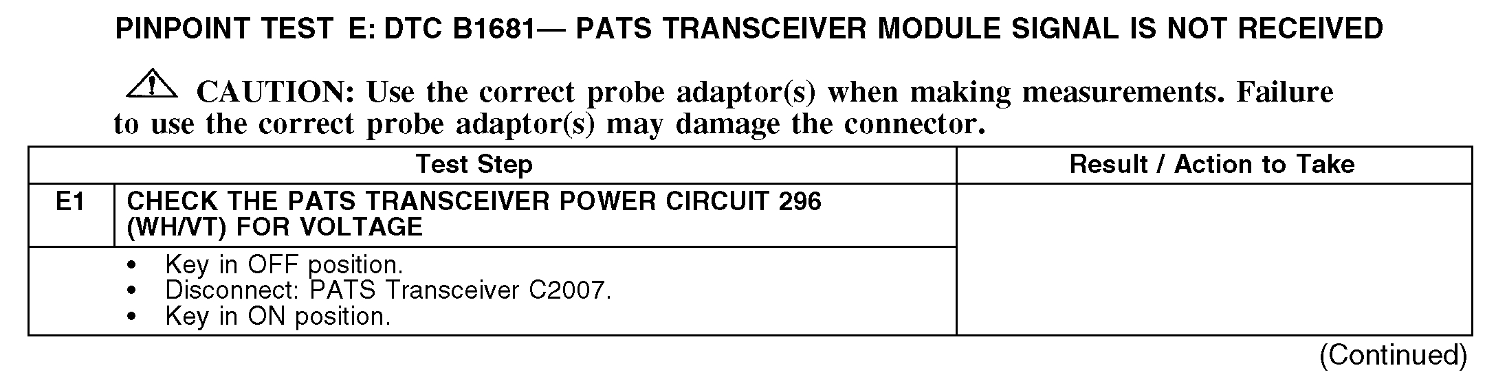

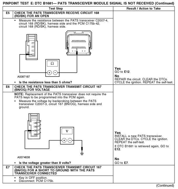

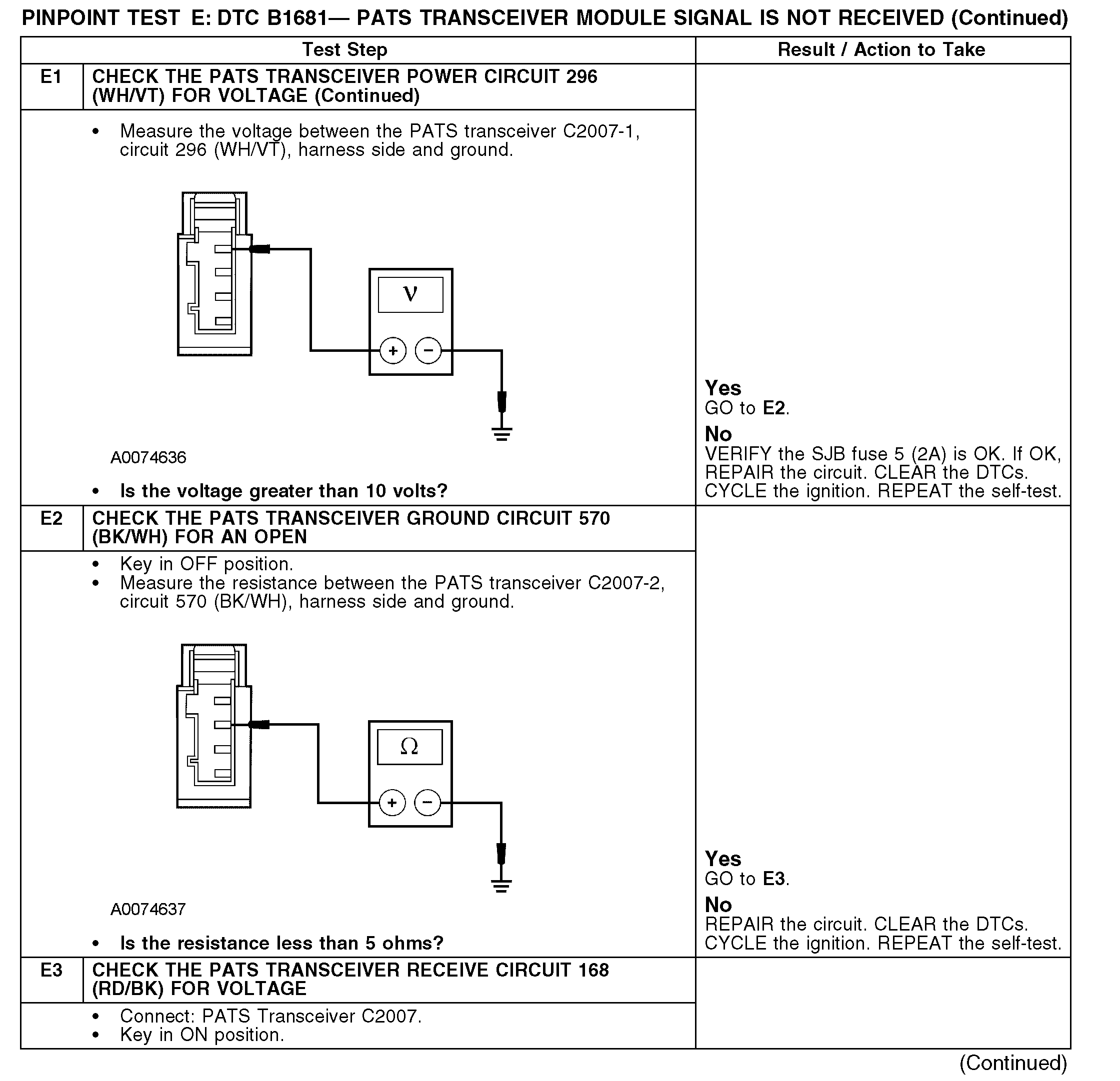

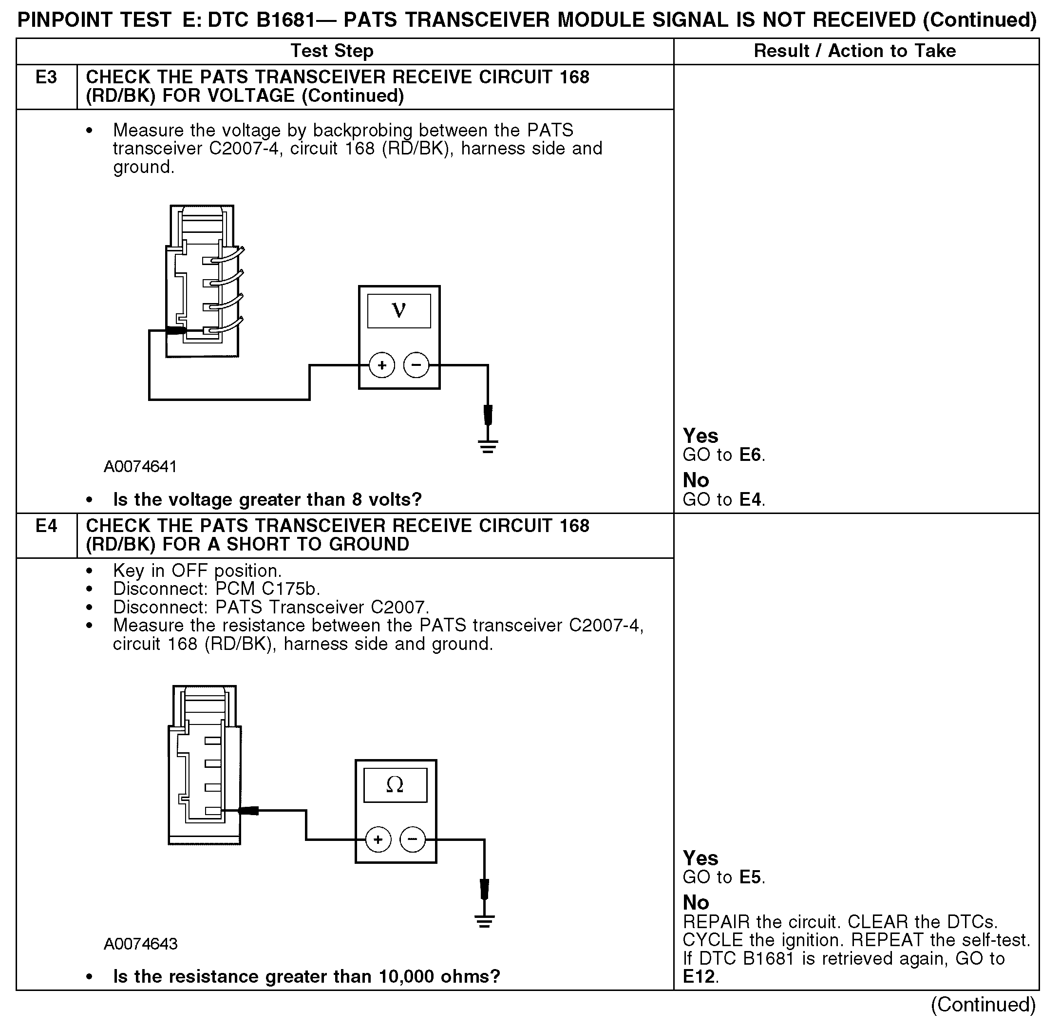

Here are diagnostics for the transceiver. The attached pics correlate with the directions. I'm adding them hoping they may help.
__________________________
2007 Ford Truck Escape 4WD L4-2.3L VIN Z
Test E: DTC B1681 - PATS Transceiver Module Signal Is Not Received
Vehicle Accessories and Optional Equipment Antitheft and Alarm Systems Testing and Inspection Pinpoint Tests Anti-Theft - PATS Test E: DTC B1681 - PATS Transceiver Module Signal Is Not Received
TEST E: DTC B1681 - PATS TRANSCEIVER MODULE SIGNAL IS NOT RECEIVED
PINPOINT TEST E: DTC B1681 - PATS TRANSCEIVER MODULE SIGNAL IS NOT RECEIVED
E1
pic 1
E1-E3
pic 2
E3-E4
pic 3
E5-E7
pic 4
E7-E9
pic 5
E9-E11
pic 6
E11-E12
pic 7
Normal Operation

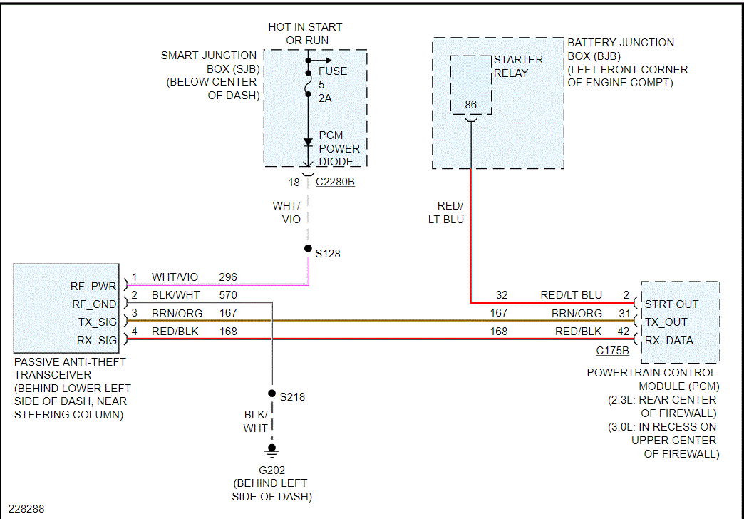

The passive anti-theft system (PATS) transceiver receives voltage from the smart junction box (SJB) fuse 5 (2A) on circuit 296 (WH/VT) and is grounded on circuit 570 (BK/WH). The PATS transceiver and the powertrain control module (PCM) communicate on circuits 167 (BN/OG) and 168 (RD/BK). The PCM compares the key code stored in memory and enables the starter if the key code is correct.
DTC B1681 - sets when the PATS transceiver signal is not received by the PCM. This diagnostic trouble code (DTC) can be caused by circuits to the PATS transceiver, circuits between the PATS transceiver and the PCM, the PATS transceiver or the PCM. This can also be caused by using the incorrect PATS transceiver part number.
Possible Causes
- Fuse
- Circuit 167 (BN/OG) open, short to ground or voltage
- Circuit 168 (RD/BK) open, short to ground
- Circuit 296 (WH/VT) open, short to ground or voltage
- Circuit 570 (BK/WH) open
- PATS key
- PATS transceiver
- PCM
______________________________
Let me know if this helps. Also, the last pic is the schematic of the PATS transceiver circuit.

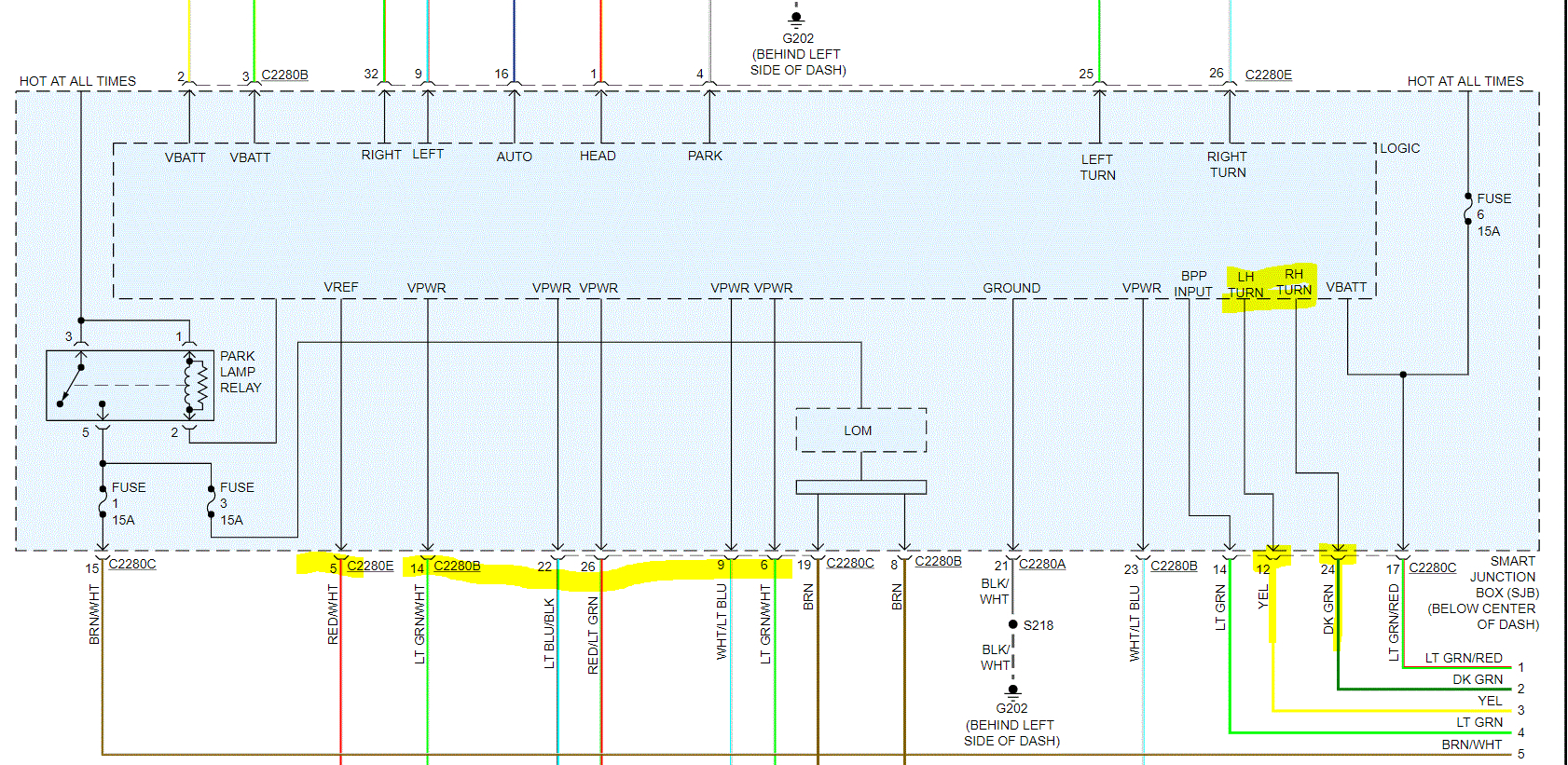

Hi, i am still fighting the issue. I got the car to start every time,but my fuel gauge don't work; turn signal don't work and more important every time you want to shift gear you have to use override so you can move the shifter out of the park. so whatever is causing these problem has to be a common in all of them, because before i couldn't start but everything was working; gas gauge was showing gas i could turn the signals on on both side, shifter shifted without using the override button. so in all i am frustrated. could it be a bad or shorted SJB?

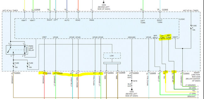

Okay, let's try to figure this out together. Don't laugh, but I need to know if the brake lights are working. That could tie in the signals and the shift interlock. Once I determine that, I can see how (or if) the fuel gauge ties in via a ground.
Keep in mind, it could even be an ignition switch, but that needs to be determined. One last thing, for me to access the correct wiring schematics to review, I need to know the engine size and if it is 4wd.

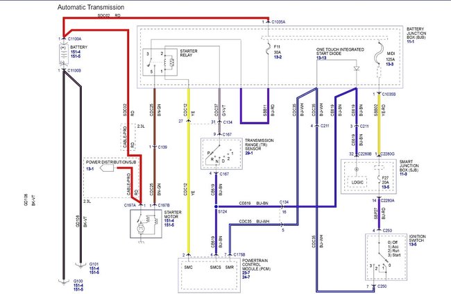

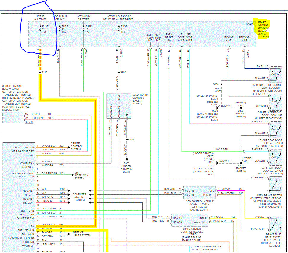

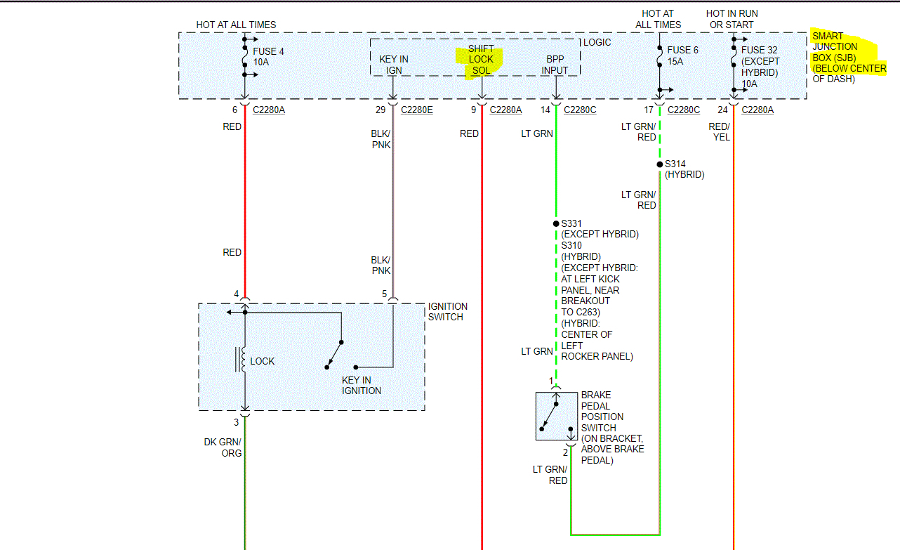

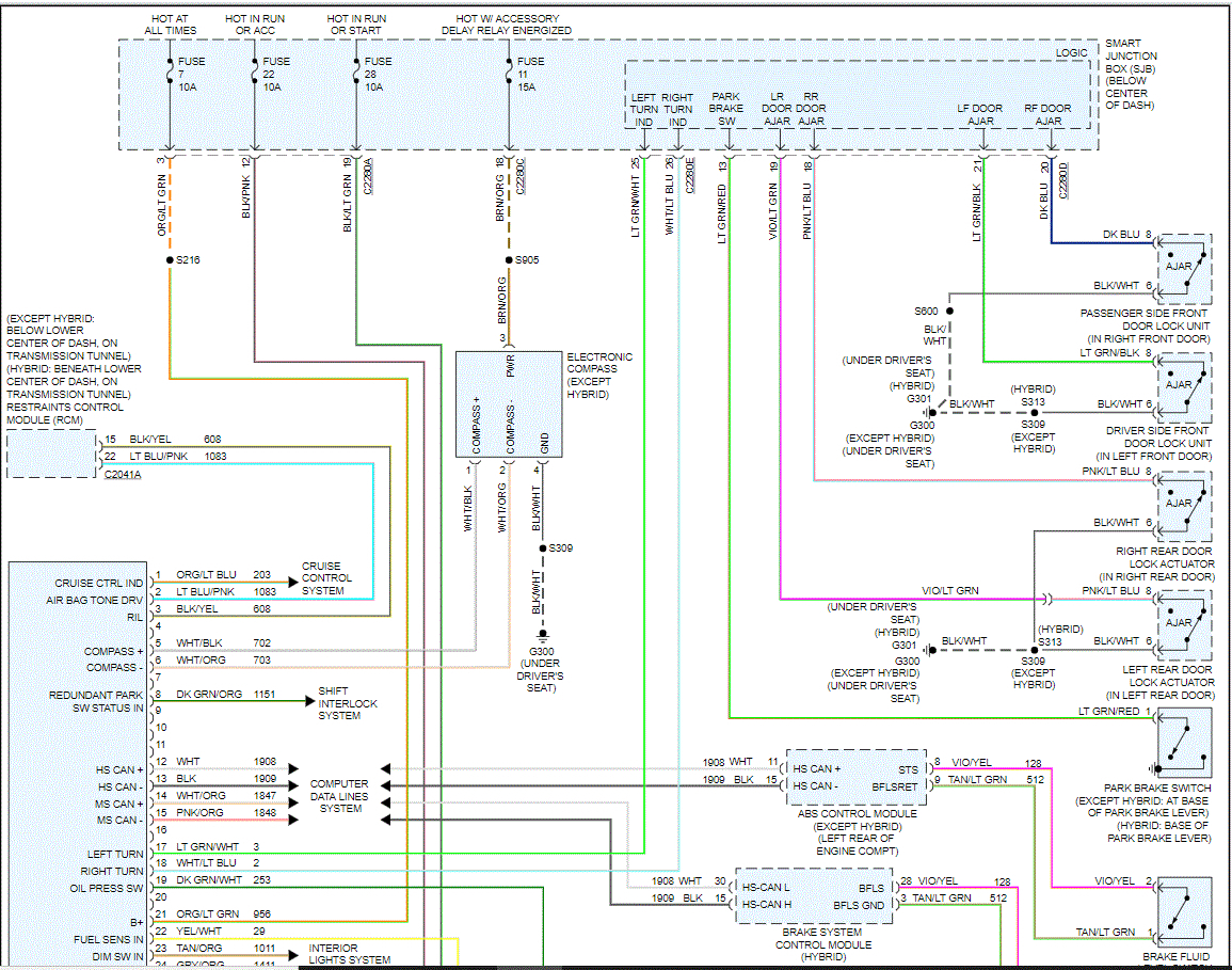

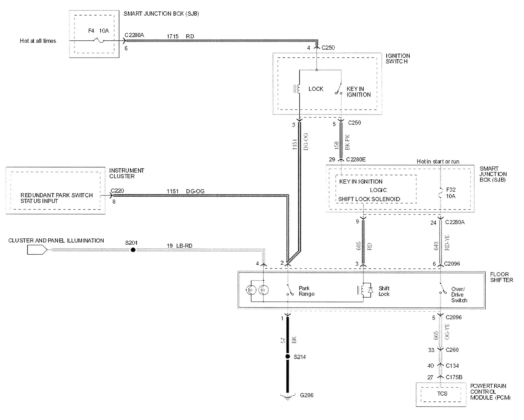

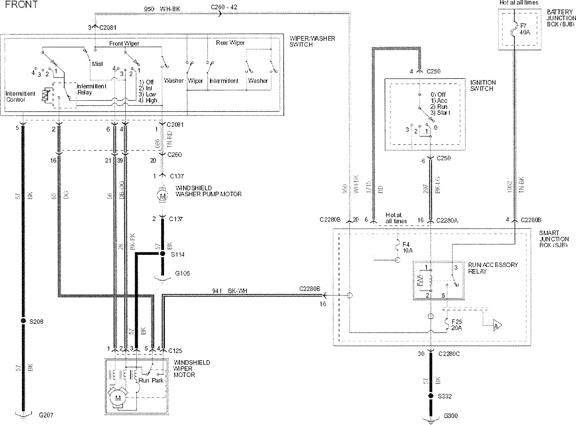

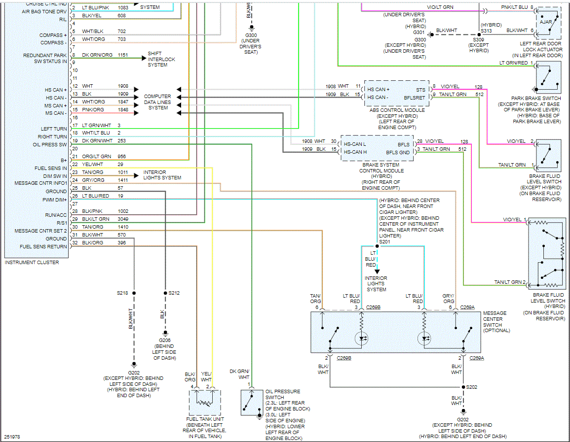

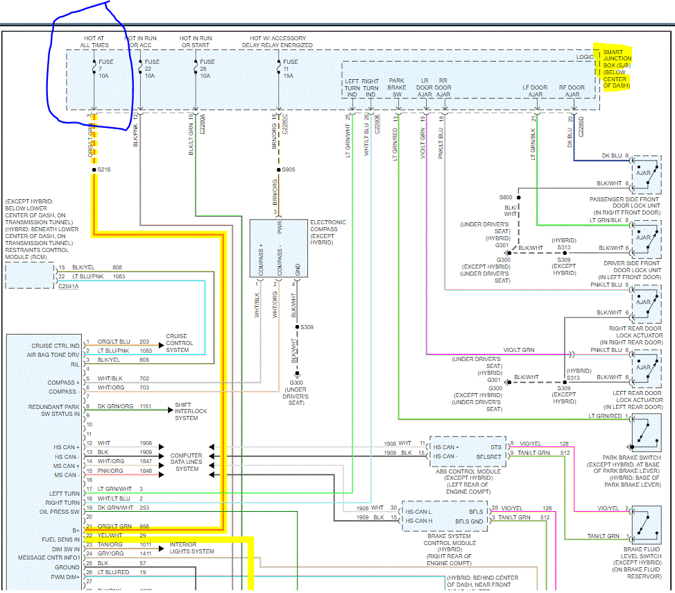

Everything works brings me back to the smart junction box under the dash. I attached a couple of pics below. See if you can tell if there is power to any of the wires I indicated. Note: Pic 1 is of the signals, pic 2 shows the fuel gauge, and pic 3 is the shift interlock. They all have different grounds so I don't think it's a ground issue. Let me know if you find power.

hi, thank you for diagrams. can you tell me the name and location of unit or connector name in the lower left corner?
by the way.
Jan 27, 2021 at 7:54 AM
  • 110,240 POSTS
Is it possible for you to copy my pic and circle which one you are referring to?
Thanks,
Jan 27, 2021 at 9:17 AM
BAHMAN5
  • 18 POSTS
my bad, it's fuel gauge, pic 2. i like to check the wires in that connector coming from fuse 7 in SJB and fuel sens in. i find SJB online and order just in case that may be something broken inside its circuit board.
Jan 27, 2021 at 10:26 AM
BAHMAN5
  • 18 POSTS
also, could you post that portion of the diagram (lower left of pic 2) in full? Thanks.
Jan 27, 2021 at 10:38 AM
  • 110,240 POSTS

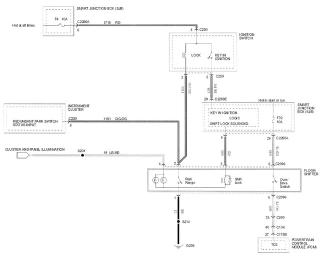

I attached two pics below. They are of pic 2 above. Note that I cut the picture in half. I did this to make it more readable for you. I did overlap the pics so you can follow them.

first on the interlock wiring dia-with key in ignition pin 1- ground --2 battery volt (12.20)
3-( 4.41 volt ) which is the same as pin 9 on c2280a - pin 6 (14.24 volt), pin 4 and 5 nothing really
on the wiper dia everything check okay except , -f25 nothing and consequently nothing on pin 16 of c2280b.
even though i have change run accessory relay no help if you notice right before f25 there is two dashing line which goes somewhere (i have no idea where ,hope you be able to help).
could be my problem another guess of mine is that the SJB circuit board is shorted out which i have order it from Ford .once again thank for your time and help.

hello again, a friend of mine had a switch type rely adapter, which bypass the coil on accessory relay. when it installed and switch on everything came to life, car running ,radio works ,turn signal ,shifter moves easily ,gas gauge show amount. so somehow the power going to the coil side of relay with the switch in accessory or start position is missing or not adequate. well, finally find the cause of all the problem. hope these discussion help someone in the future. one more time thanks for all your help.
