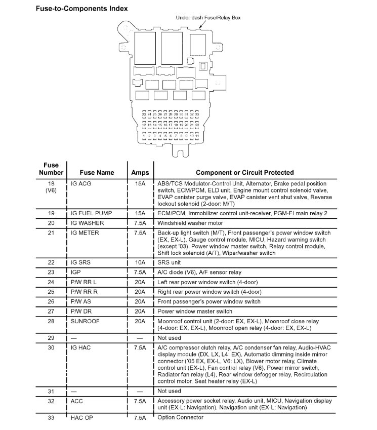

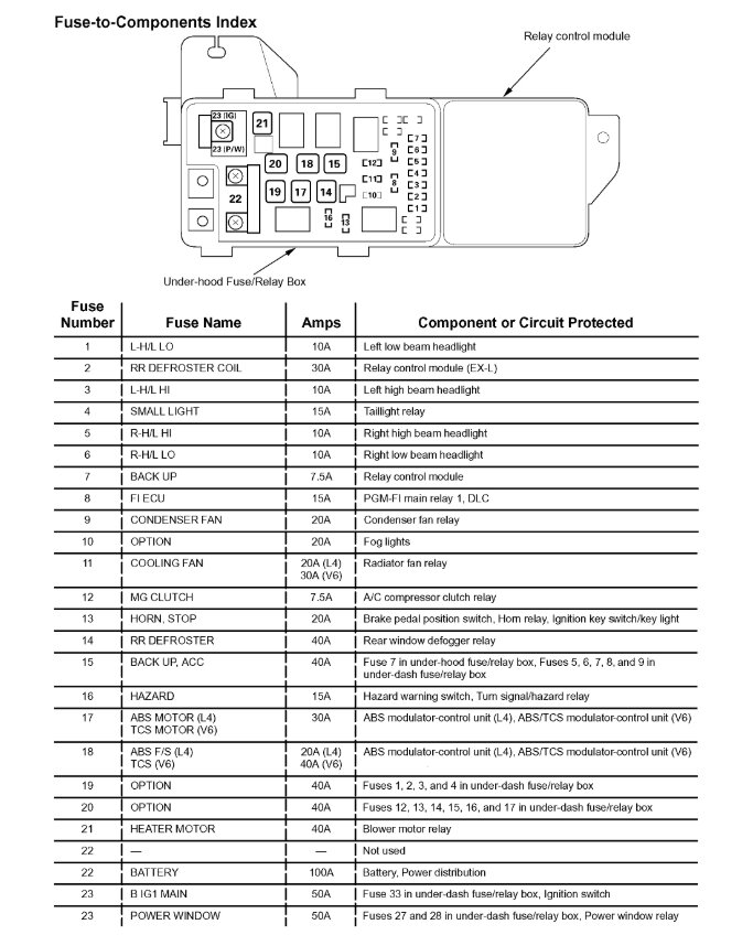

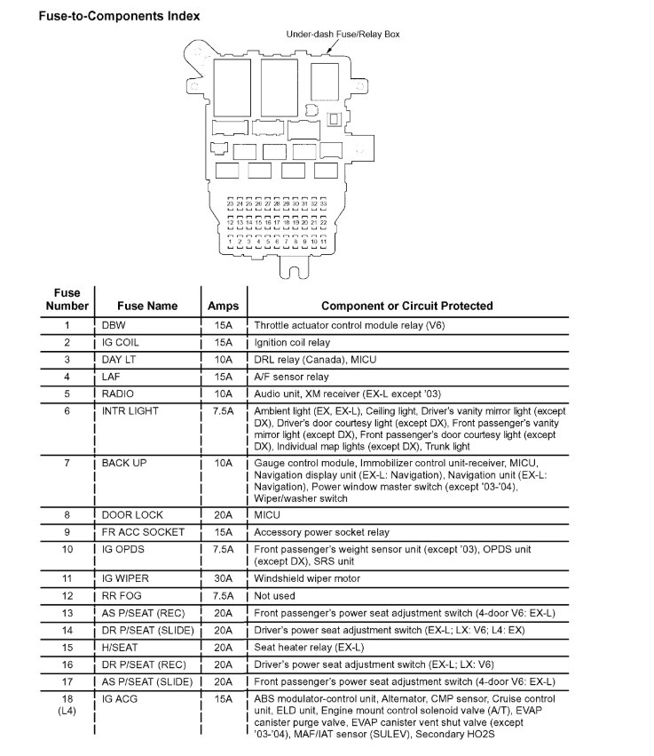

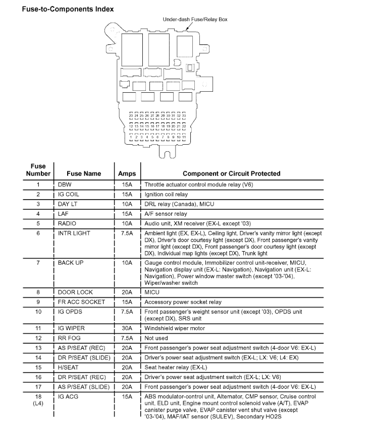

It sounds like the security system is enabled but we should start by checking the fuse with the key on. Also, can I ask if the original key is still with the car or is there a replacement key tried to start the car?
If the fuse is okay with the original key, can I ask if the security light is flashing? If so, I would disconnect the battery overnight to help reset the system.
This guide may help as well:
https://www.2carpros.com/articles/how-to-reset-a-security-system
Check out the images (below). Please upload pictures or videos in your response of the problem so we can see what's going on.
