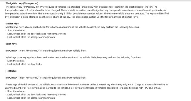

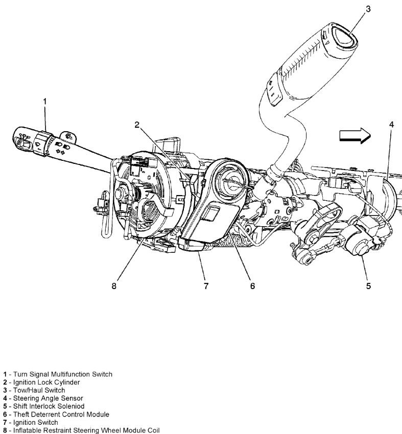

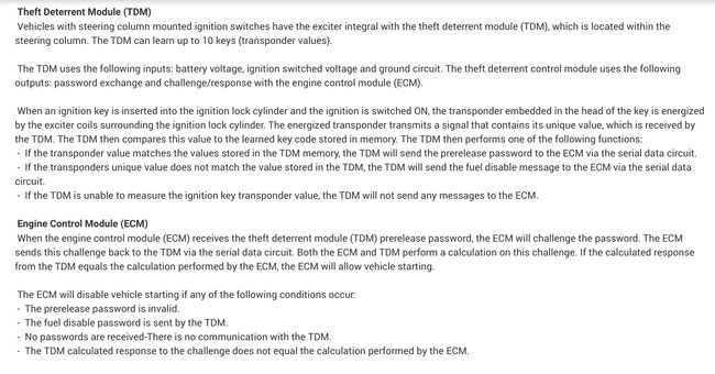

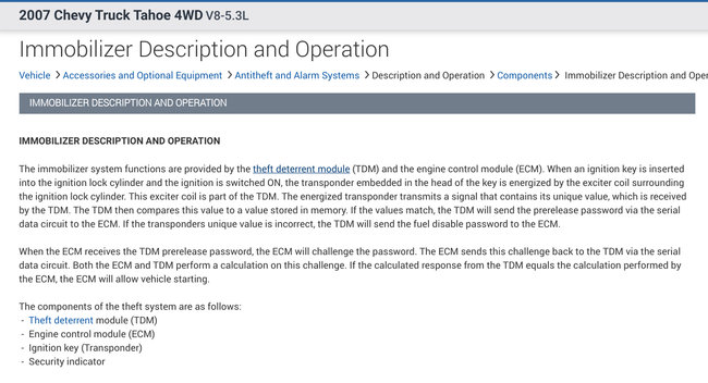

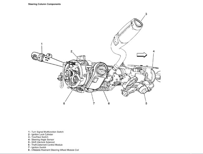

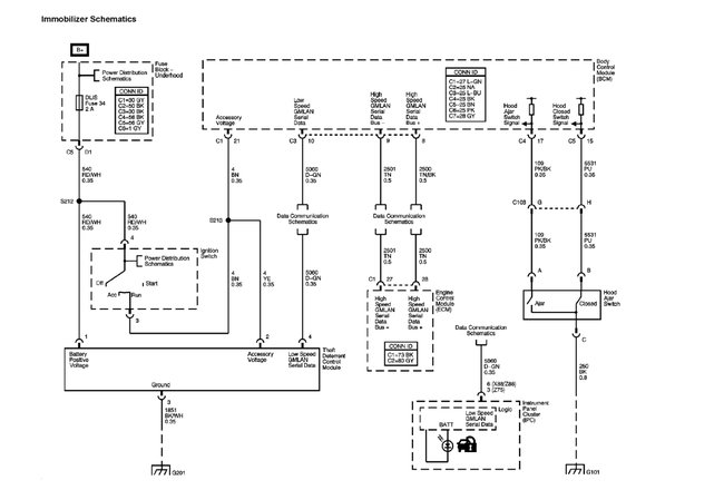

I have included the information that you have requested in the diagrams down below. I have included the description of operation for the immobilizer system, the component locations of the immobilizer system with diagram, and a wiring diagram of the anti theft circuit in your vehicle. Please get back to us with how everything turns out. I hope this helps.

If it has the key on the steering column the part you saw in the column is the theft deterrent module, the ring for the transponder key is part of it. He may be thinking of the earlier GMs that did have the TDM remote mounted in the dash. The TDM ties into the key-less entry system and the power-train module all through the CAN network in the truck. It works by sending out a pulse that sort of wakes the key up, then it reads the signal from the key and compares that to a list of valid keys for your truck (up to 10) If the key is valid it sends a signal to the PCM telling it that it can turn on the fuel pump and ignition and start the engine.
If you have key-less entry it works about the same except that the fob transmits a low power signal carrying the code to identify it as a valid fob.
Once the TDM is replaced it has to be programmed into the system with a scan tool, and a GM dealer terminal then the keys need to be relearned as well. Each TDM also has a unique code to ID it to the system which is why it needs to be programmed in.
The TDM is part #6.

Called the dealer today and they said I could bring my own module that I purchased myself online and install and they could program it. They originally quoted $645.00 to replace and program. I bought a $83.00 part plus $15.00 shipping to get it next day. I just have to pay the $65.00 diagnostic and $150.00 to reprogram now. If i could have programmed it myself i would have but i know it needs to be done by dealer. I am going Friday to put the part on and have it done. I will update once i have done so. Thanks for the help. I do have another quick question? The dealer still insists the dash has to be taken off but i am wondering if he just means i have to do so because it is easier to get to the module under the steering column panels? I have already removed all those before so that's not an issue. Just making sure there is nothing i am missing because in actuality i was able to access it without even taking the panel off near the foot pedals.
Dec 11, 2019 at 8:40 AM
STEVE W.
  • 15,411 POSTS
Not sure what they are talking about as the module is under the column covers, I know the book says you need to remove the trim panels but it can be done without doing that to get the covers off. Maybe you should remove the covers before you take it in. Then you could ask them why the dash has to come out when the part is plugged in right there??
