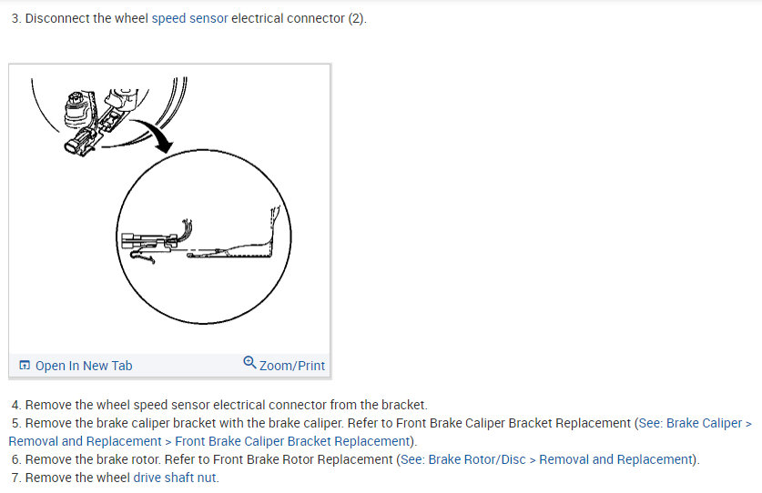

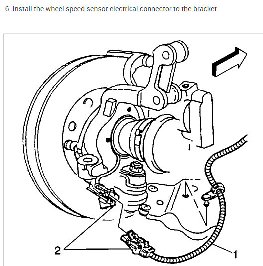

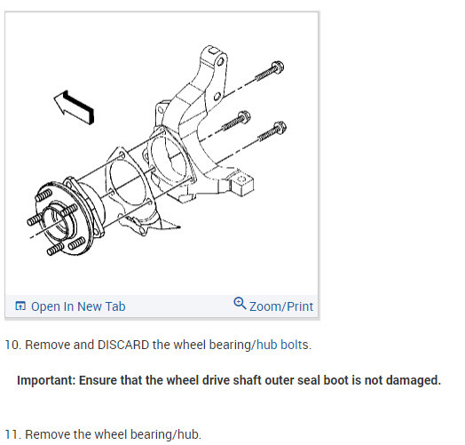

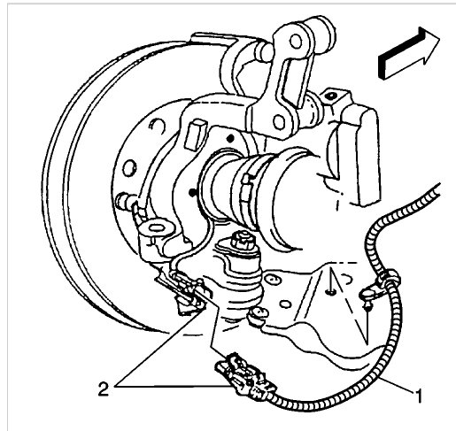

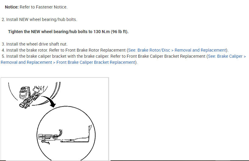

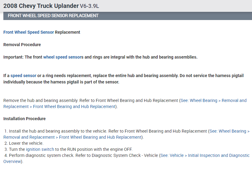

How do you change the anti lock brake sensor right front please?
May 2, 2018 at 3:20 PM
DANNY L
  • 5,648 POSTS
Hello, I'm Danny.

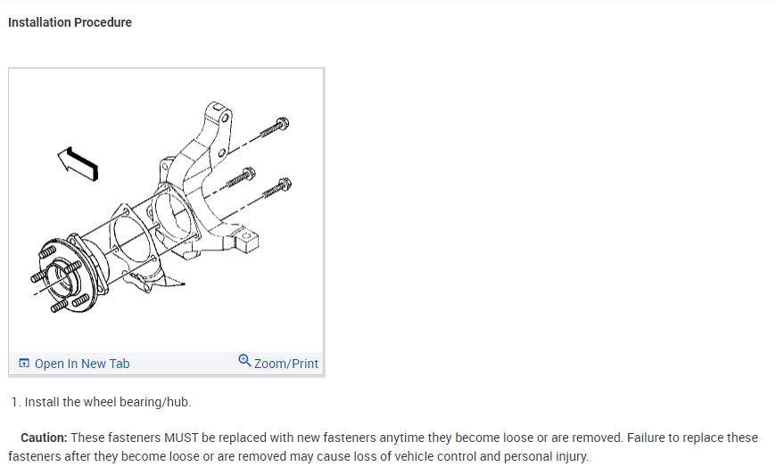

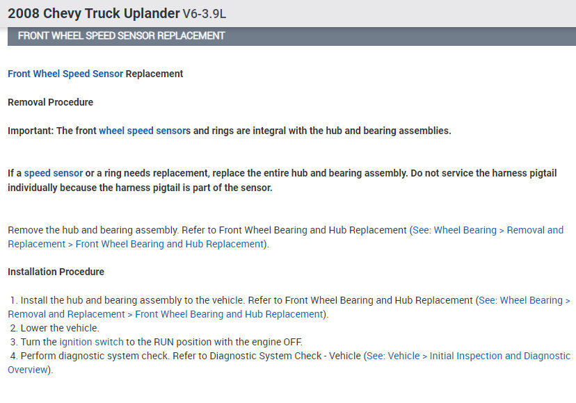

Here is the information you requested. Here is a guide to help you step by step with instructions in the diagrams below to show you how on your truck:
https://www.2carpros.com/articles/how-to-replace-an-abs-wheel-speed-sensor

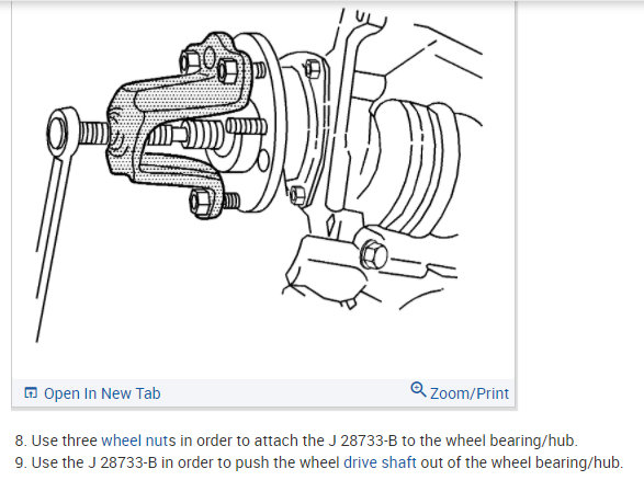

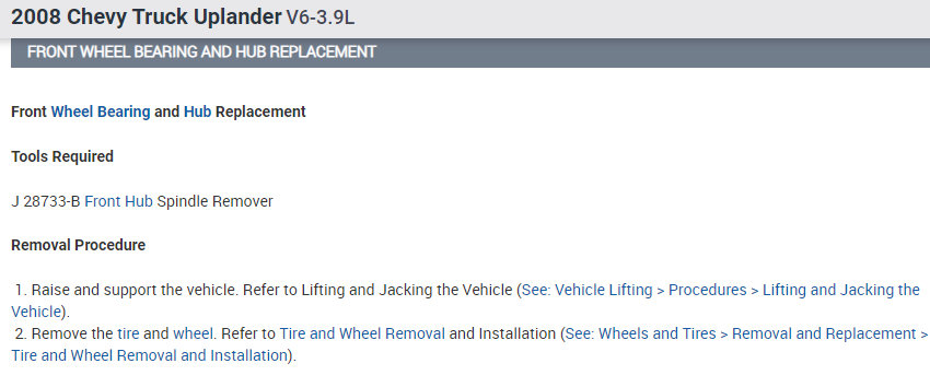

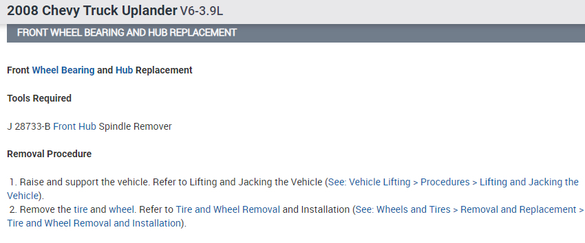

The wheel speed sensor is incorporated into the front wheel bearing-hub assembly and will have to be removed and replaced as a unit. Here is a wheel bearing-hub assembly replacement tutorial for you as well:
https://www.2carpros.com/articles/bearing-hub-replacement
I've attached picture steps below on how to change the wheel speed sensor and hub assembly on your truck. Hope this helps and thanks for using 2CarPros.
