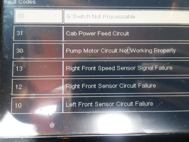

So I had it ran for codes and it did not look good. Three wheel speed sensors are out. That would explain the lack of speed.
Wednesday, September 11th, 2019 AT 2:14 PM
TJ NAYLOR
  • 14 POSTS
So I had it ran for codes and it did not look good 3 wheel speed sensors are out that would explain the lack of speed. But I just changed the front passenger side.

Can you help me figure out what the codes mean? Except the wheel speed sensors. There is a couple of codes I'm not familiar with.
Wednesday, September 11th, 2019 AT 7:45 PM
94 TRANSAM
  • 680 POSTS
Absolutely, Give me all the codes and I will look them all up.
Rich
Wednesday, September 11th, 2019 AT 8:55 PM
TJ NAYLOR
  • 14 POSTS
G switch not prossiable. Cab power feed circuit. Right front speed circuit failure. The rest are speed sensors I'm not sure if bad speed sensors can trigger all if that.
Thursday, September 12th, 2019 AT 2:14 AM
