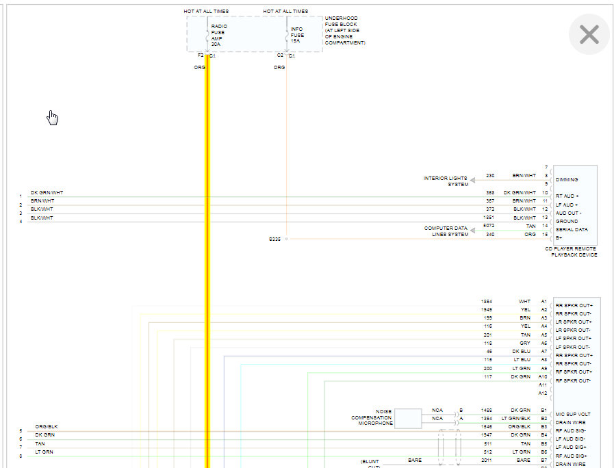

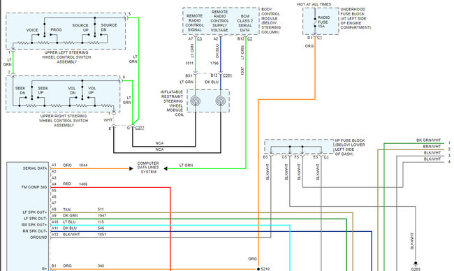

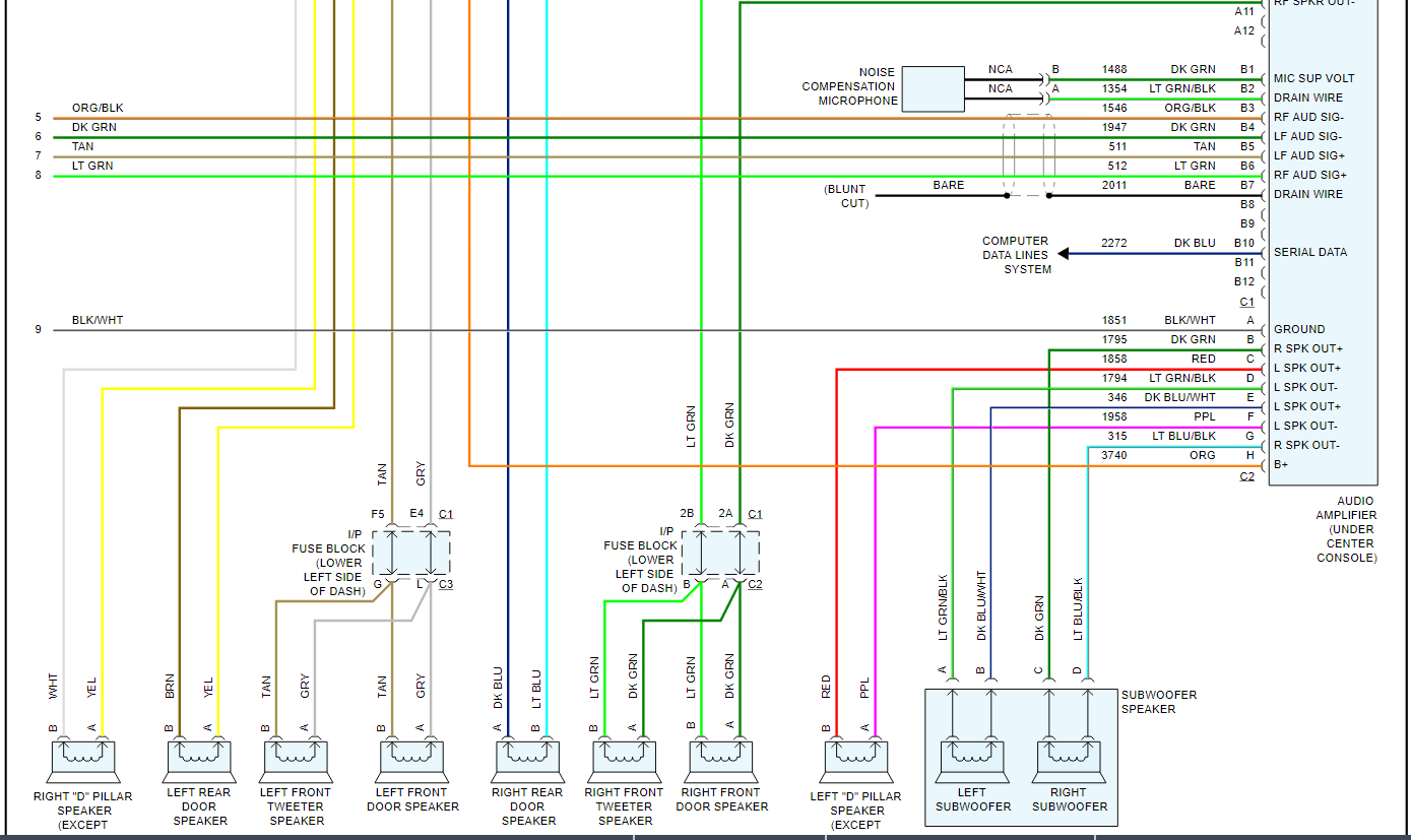

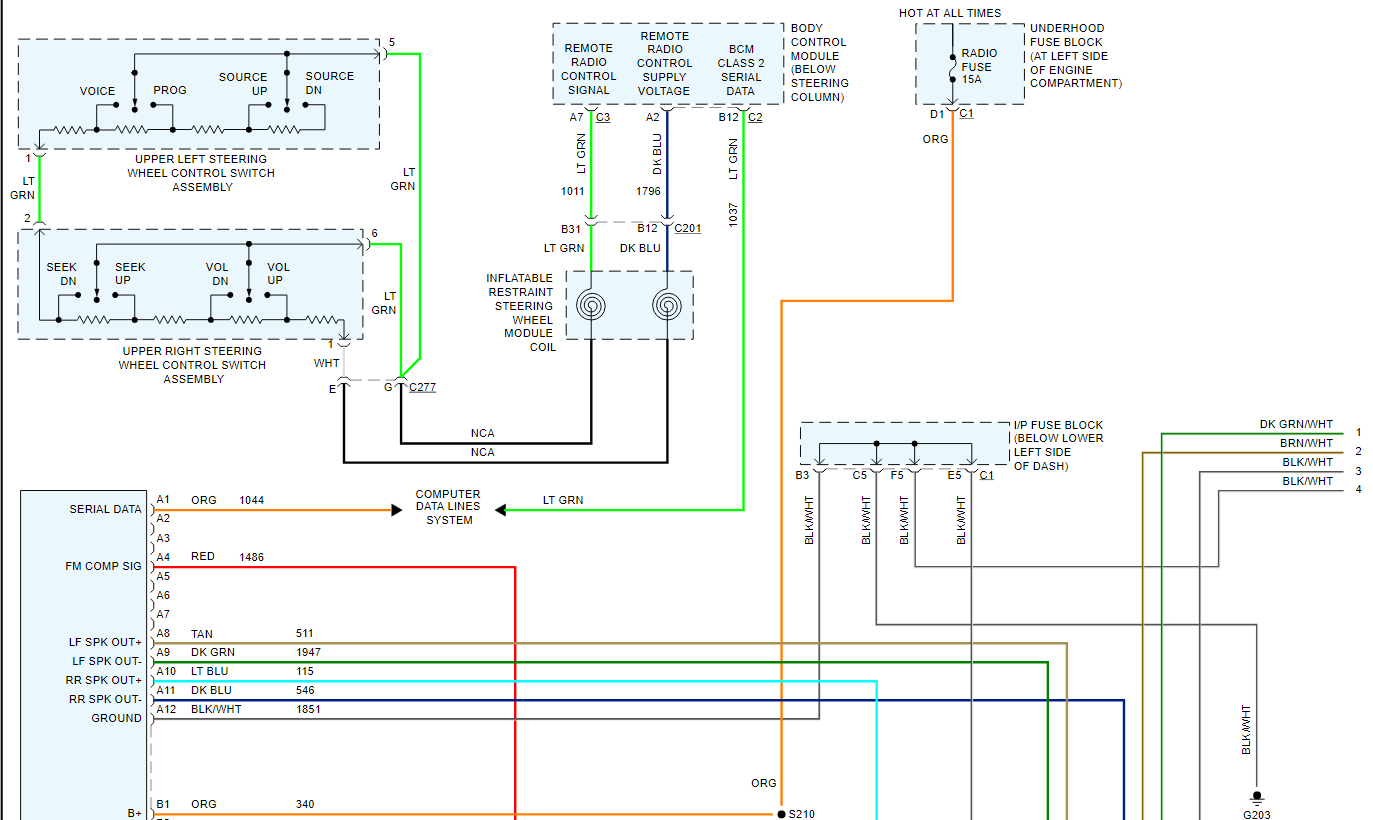

My truck has been having a parasitic draw and I narrowed it down to my amplifier for the stereo. When I unplug it the draw goes away. I am looking to find where the relay would be for the amp I know it is wired direct from fuse box under hood but there is a relay somewhere in between. Could someone tell me where this relay is?
Nov 7, 2020 at 5:30 AM
Couple questions first, not necessarily to change your direction but more for others that visit this site and may have similar issues. I assume you are monitoring the draw with the meter in line of the negative cable and post? If so, what is the draw? Then what does it drop to when you unplug the amp?

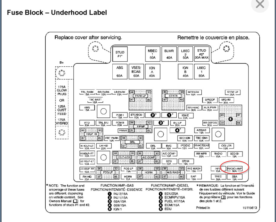

As for the relay, your system does not have a relay for the amp it has a fuse for the B+ feed that I highlighted. The fuse is in the under hood fuse box. However, the fact that the draw goes away when the amp is unplugged, is pointing to the amp as the issue. More then likely it is not shutting off as it is shorted internally. So I would just test the wire from the fuse to the amp for a short to power and if that passes then the amp will most likely need to be replaced.

No, there is not a relay in the circuit at all. It is direct wire.
https://www.2carpros.com/articles/car-battery-dead-overnight

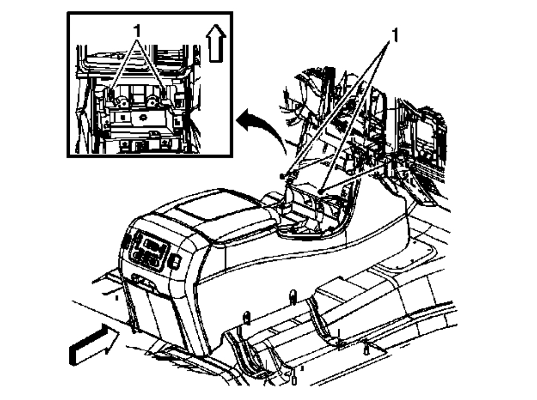

If you unplugged it and the draw went away, replace the amp.

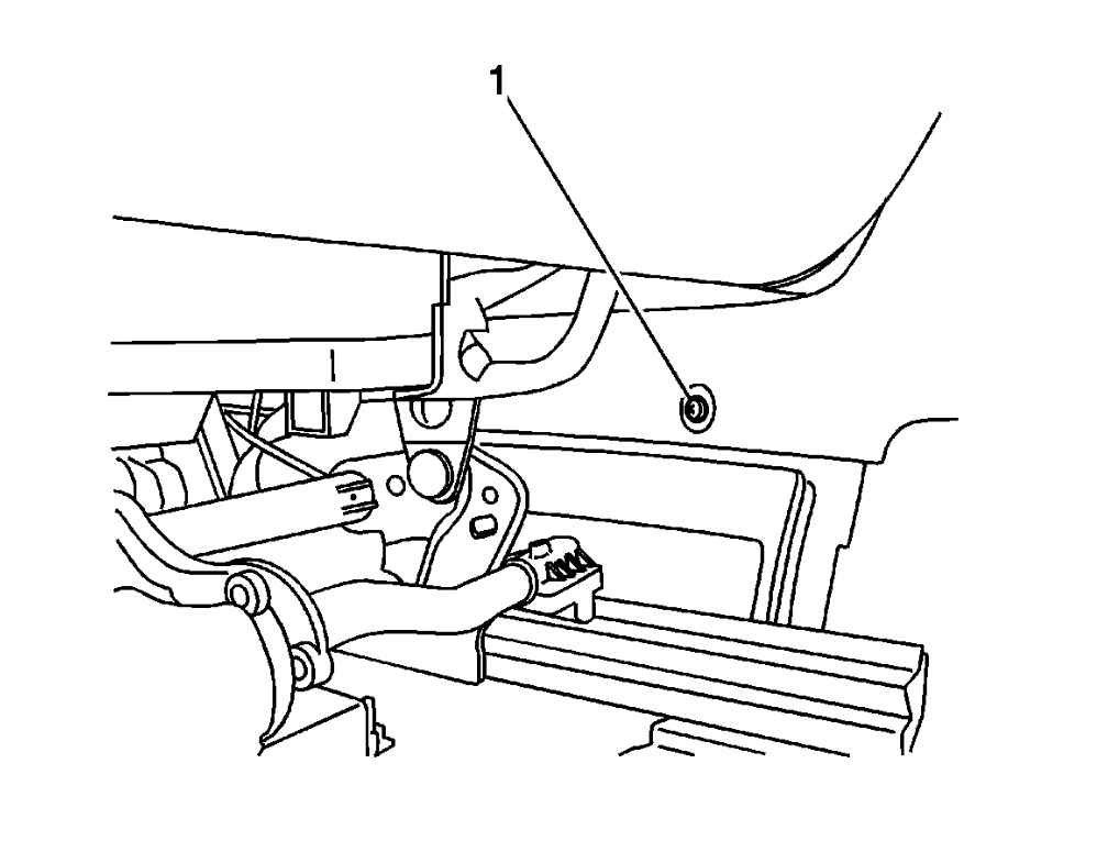

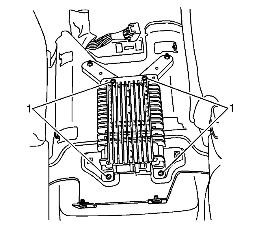

1. If equipped with a Bose(TM) amplifier, remove the radio amp fuse located under the hood electrical center.
2. Remove the floor console bezel.
3. Remove the cupholder.
4. Remove the bolts (1) retaining the console to the instrument panel (I/P).
5. Remove the console storage bin.
6. Remove the center console end panel.

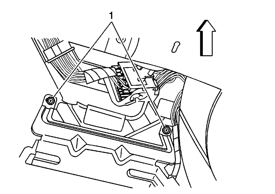

7. Disconnect the audio amplifier electrical connectors.
8. Remove the 4 screws retaining the upper console bracket to the lower console bracket. The front 2 screws (1) are shown in the graphic.
9. Move both front seats to the fully forward.

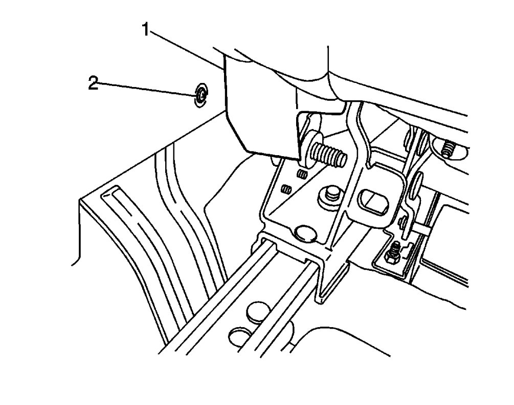

10. Reposition the inboard seat track trim (1) in order to gain access to the rear console side panel screw (2).
11. Remove both rear console side panel screws.
12. Move both front seats to the fully rearward.
13. Remove both front console side panel screws (1).
14. Disconnect the floor console electrical connector.
15. Remove the console assembly from the vehicle.

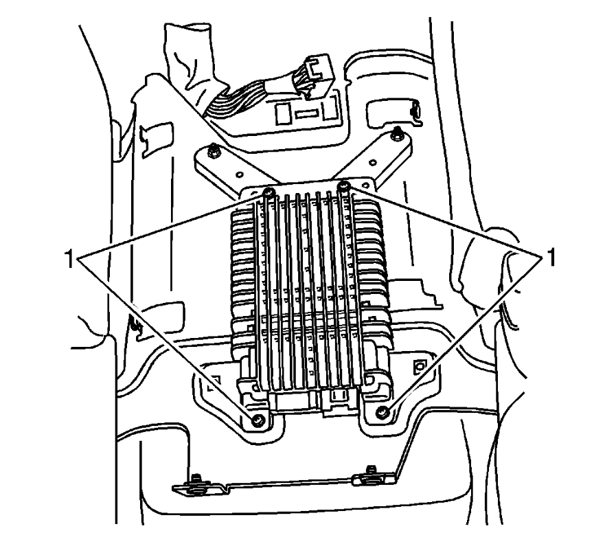

16. Remove the audio amplifier screws (1).
17. Remove the audio amplifier from the vehicle.

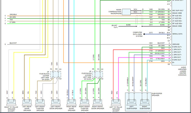

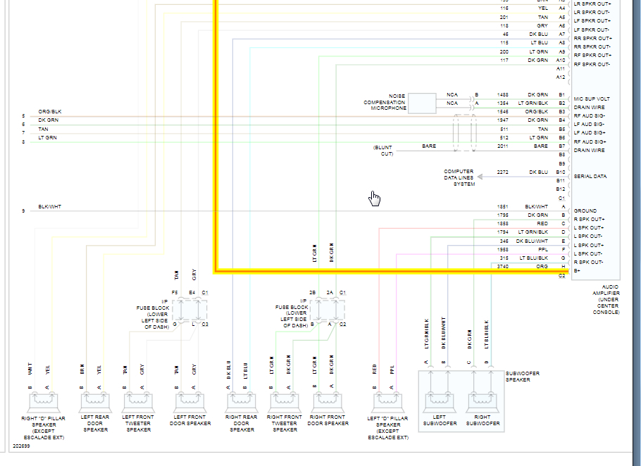

I went to the dealership yesterday and got a wiring schematic for my system. In there I did see there is a relay between the fuse and the amp. It is not the amp itself because I had already replaced that. I did do a parasitic draw test which was .665 amps. When I pulled the stereo/amp fuse the draw went away and dropped to .050 amps. I then tried disconnecting the amplifier and the draw went away. Same results. The amp has its own power supply as does the radio. The amplifier from what I see in the schematics that I got does have a relay. I had already replaced the amp. Still the same draw.

I do not think there should be power there. With key off and everything asleep. Even if there was there wouldn't or shouldn't be to cause this much of a draw but at a bare minimal. A replacement amp that was tested should not have same issue. I am not going out to buy yet another amp because I know I will only get the same results. I do have a wire schematic for this system and it does show there is a relay somewhere along the way. It must be somewhere under the dash or something. I pulled the radio out the other day and had seen a relay tucked in behind there. Don't know what it is for but. There are relays other than in the fuse box locations. My wire diagram says there is one.
Nov 7, 2020 at 10:49 AM

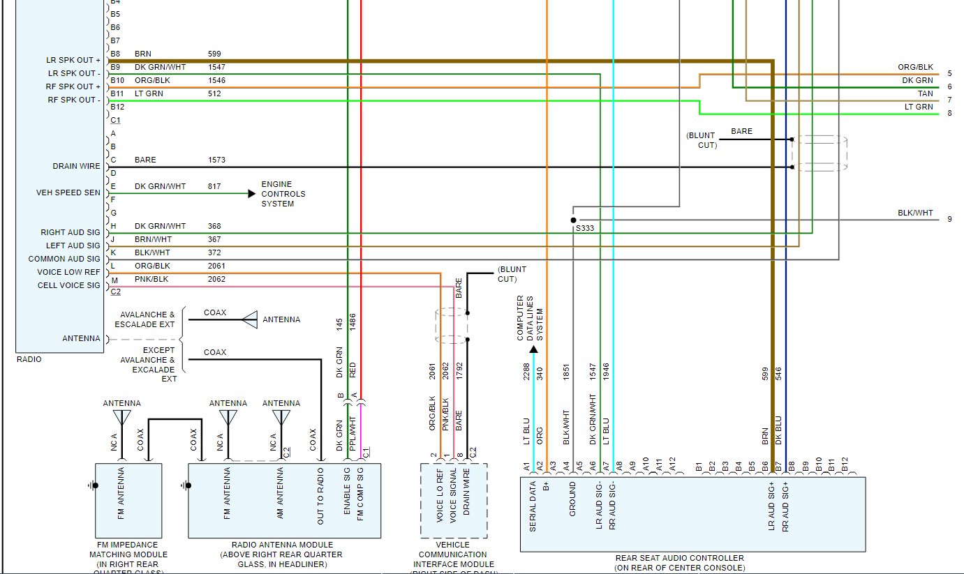

I sent you the correct diagram for your car.
I am sorry you do not understand electronics when it comes to modules but that is the way it is.
Think of a toilet bowl. You have 45 pounds of water pressure to the tank. That pressure is voltage and always there.
The current flow is the flow of water in the tank. With the valve closed, there is no flow but you still have pressure.
Nov 7, 2020 at 10:57 AM

The wiring diagrams you sent me does not show the wire going from the amp to the 30 amp fuse. Don't other modules have a relay in their circuit?
Nov 7, 2020 at 11:14 AM
No, they are direct wired from the fuse box.
