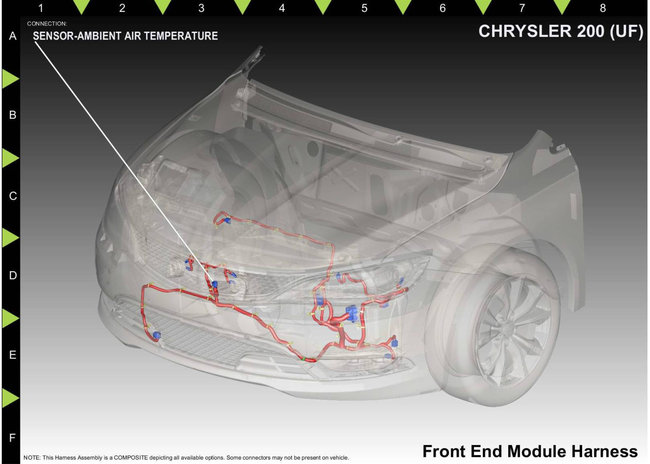

Hey CARYN HORTON,

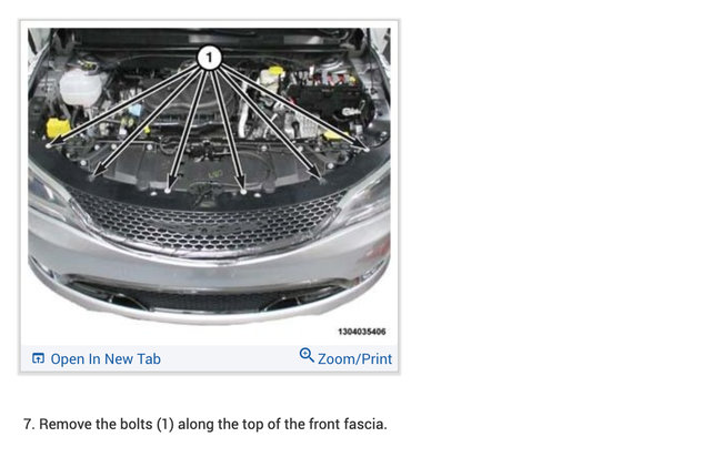

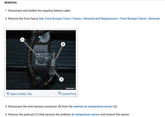

The ambient air temperature sensor is located as shown in the picture attached.
It looks like you will have to remove the front grill which is attached to the front bumper trim.

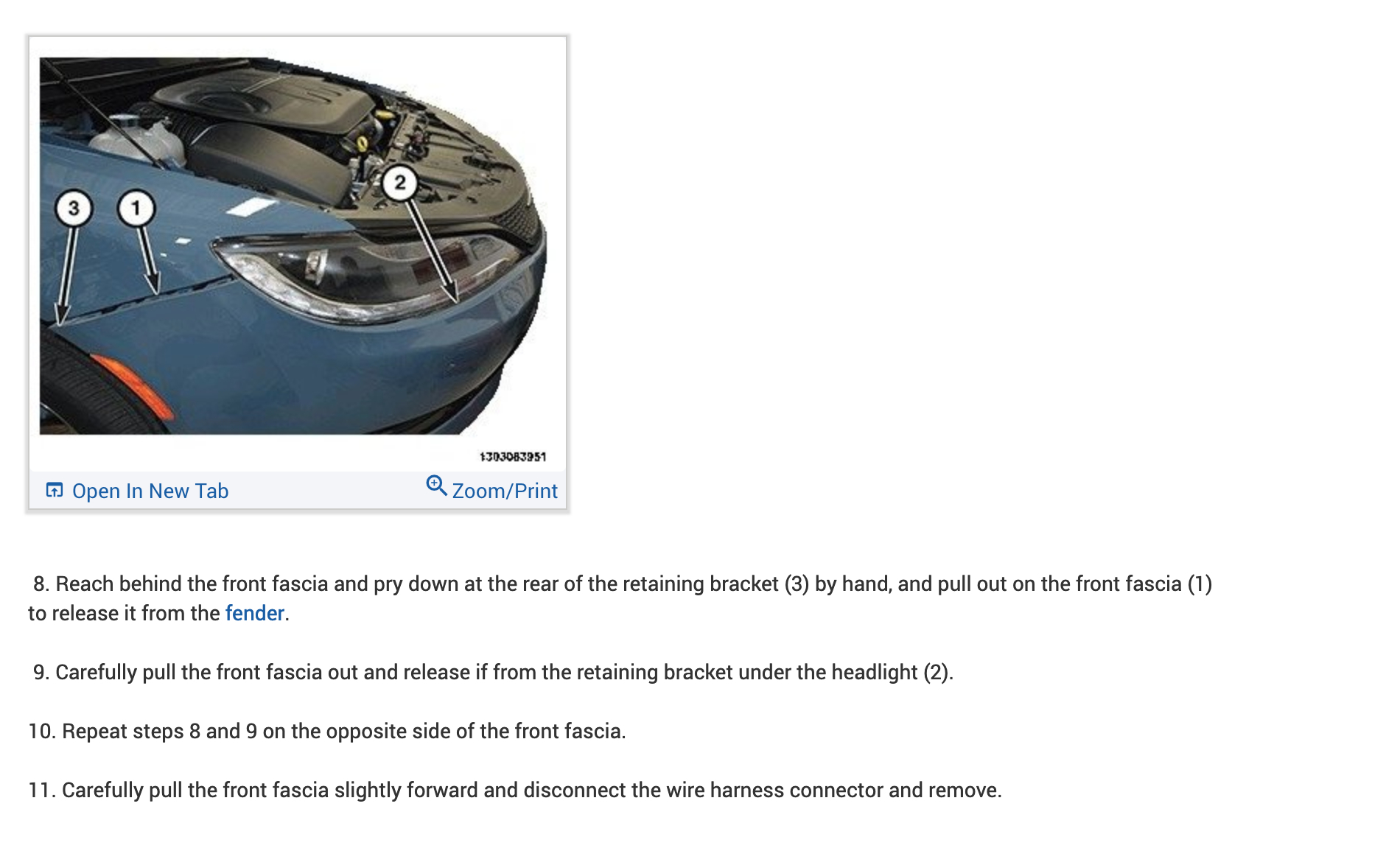

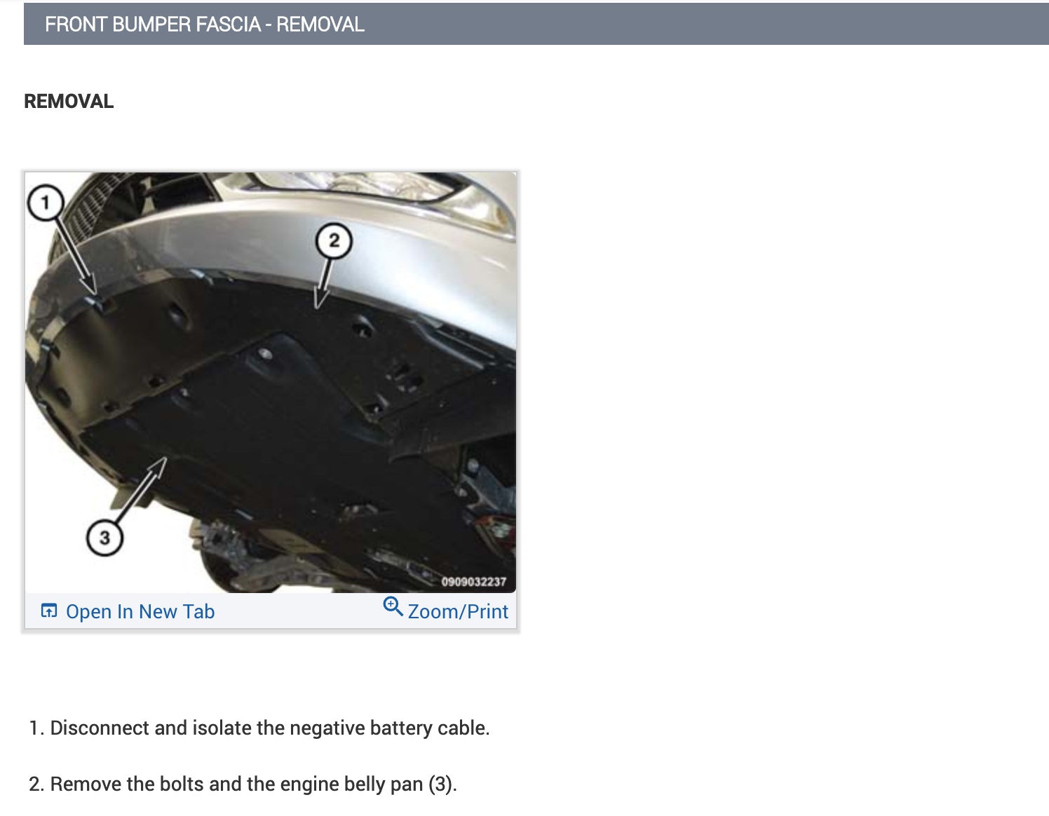

Hey CARYN HORTON,

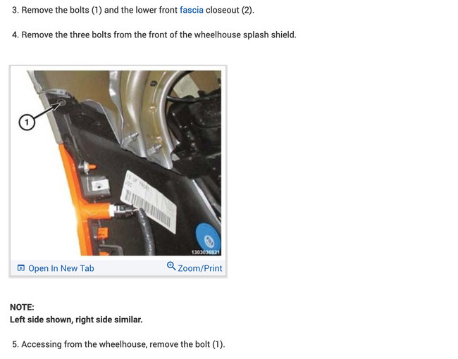

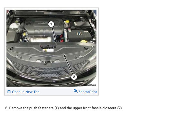

From what i can see yes you will need to remove the whole front bumper.
I will add the instructions below.
I have also found a video which runs through it and will give you an idea if you feel comfortable tackling the job. It also shows how to release the bumper around the headlight which is the only tricky part.

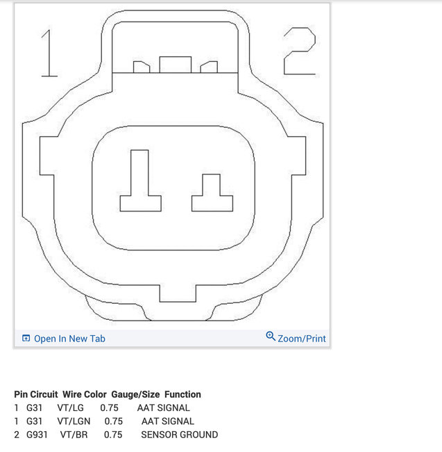

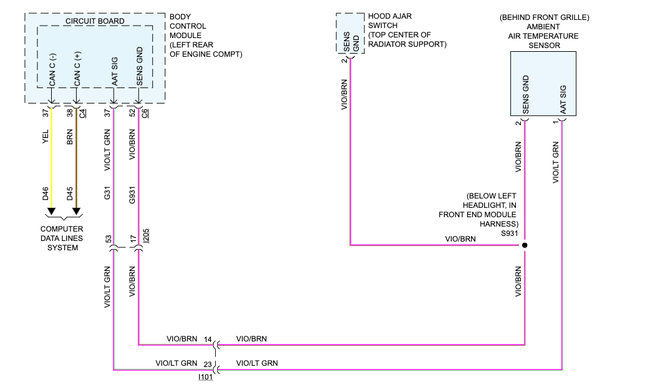

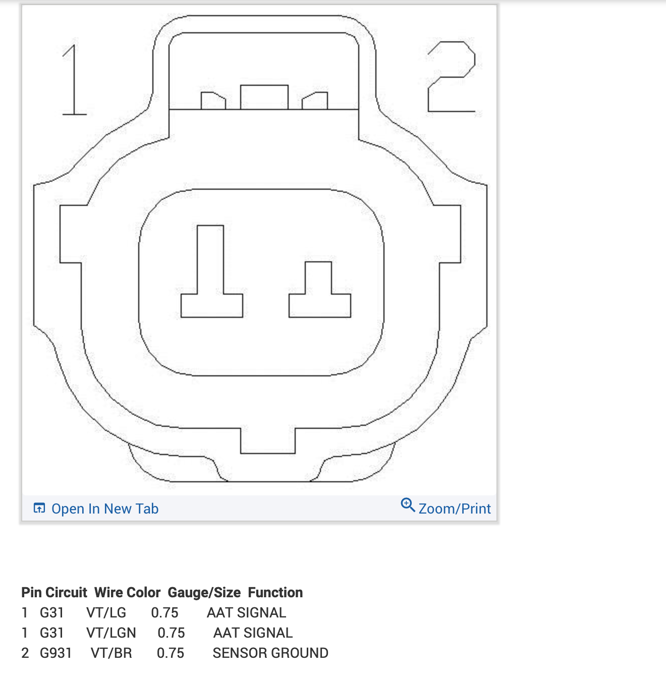

As i said in my previous message if you would like to check the wiring for this sensor the instructions are below.
You will need a multi-meter to perform these tests.
Disconnect battery negative cable
Disconnect the ambient air temp sensor (after bumper removal)
Access and unbolt body control module (fuse panel underneath drivers side dash)
Disconnect connector C6 shown in second picture.
Check continuity from ambient air sensor connector plug to body control module plug for the two wires shown in wiring diagram below.
Also with both plugs disconnected check resistance between each pin of the ambient air temp sensor and a know good ground. Then switch multi-meter to voltage and do the same check. This ensures you don't have any shorts to ground/positive.
As you can see this is fairly involved and in the interest of time you may choose just to replace the sensor and see how you go.
