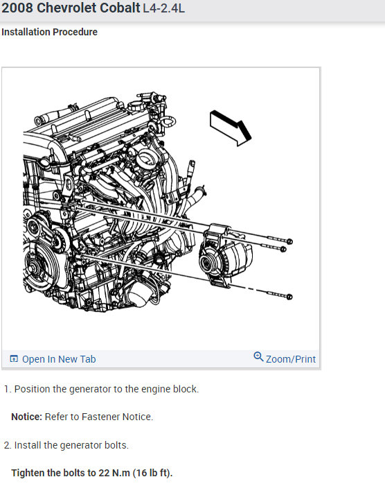

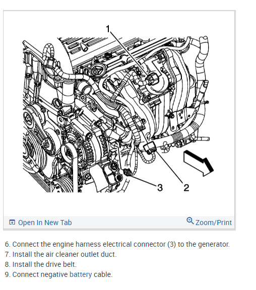

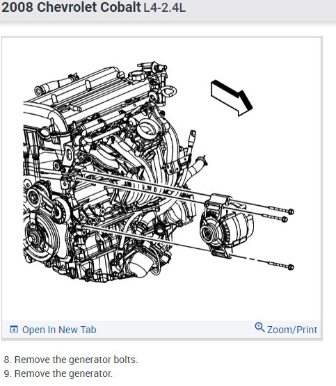

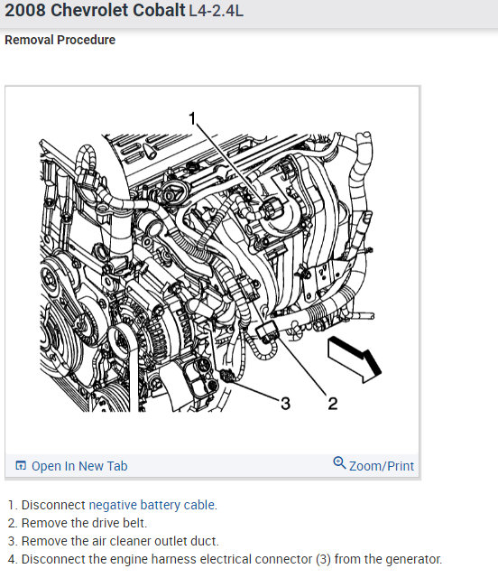

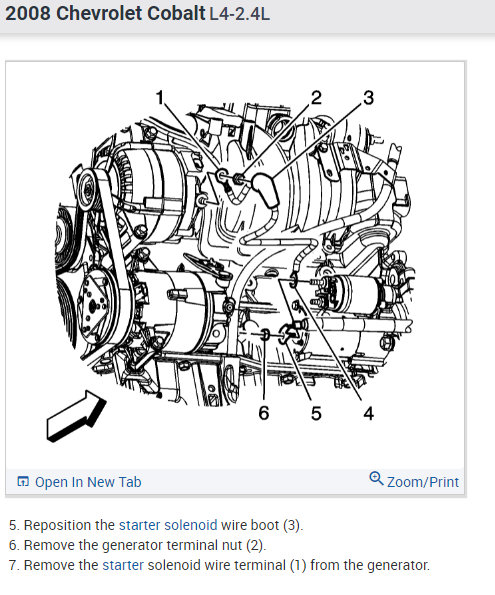

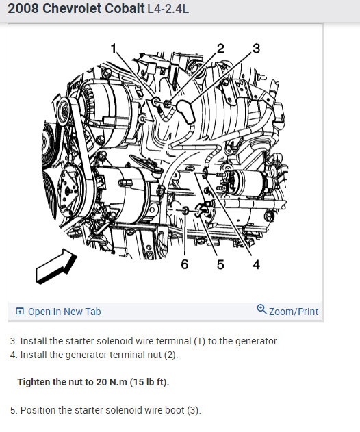

I believe I smoked my diodes in my alternator when remote-starting the car. It started slowly, and then I smelled burnt electronics when I approached the car. Charging System Light is on. Battery read 12.1V when car was not on. After starting, I am reading 11.7V. Bad alternator! Any helpful hints for the removal and replacement process? Many Thanks!
Jul 12, 2021 at 3:16 AM
SQM
  • 6,383 POSTS
Check out these articles that provides some very good info on alternator testing and replacement:
https://www.2carpros.com/articles/how-to-replace-an-alternator
https://youtu.be/Z-p4dMJUpUw
Also attached replacement procedure of the alternator on your car.
