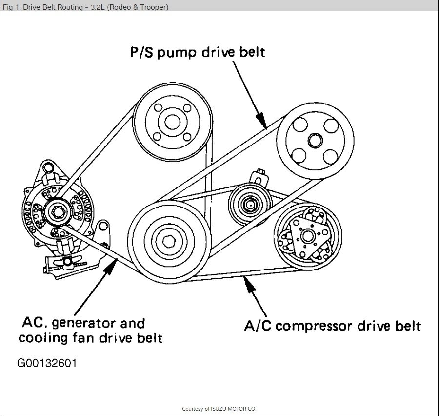

How do I replace alternator belt?

The alternator belt is the one that is furthest in, you need to remove the power steering and A/C belt before the alternator belt can be removed or installed. At bottom of alternator you can see the adjuster bolt which has to be loosened to allow the alternator to be pushed back to release the tension and allow it to be removed.
