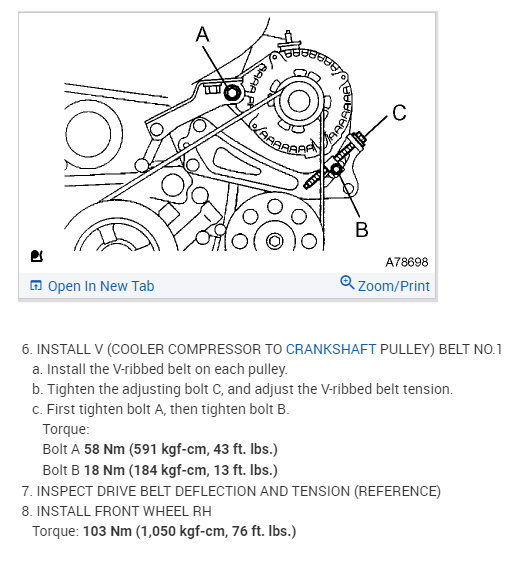

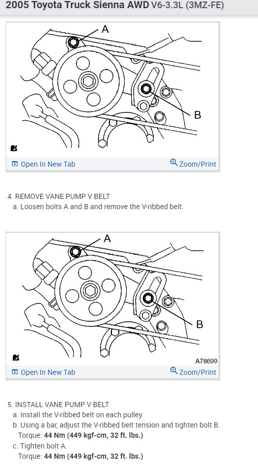

I had installed a new serpentine belt and tightened the bolts not torqued. The car squeals at the ignition start for just a second. I believe the bolts are not tightened so the squeal is present. Should I just torque the bolts or unloosen them first then torque them. I don't know if they are over tightened, and I won't be able to tell if I just torque them.

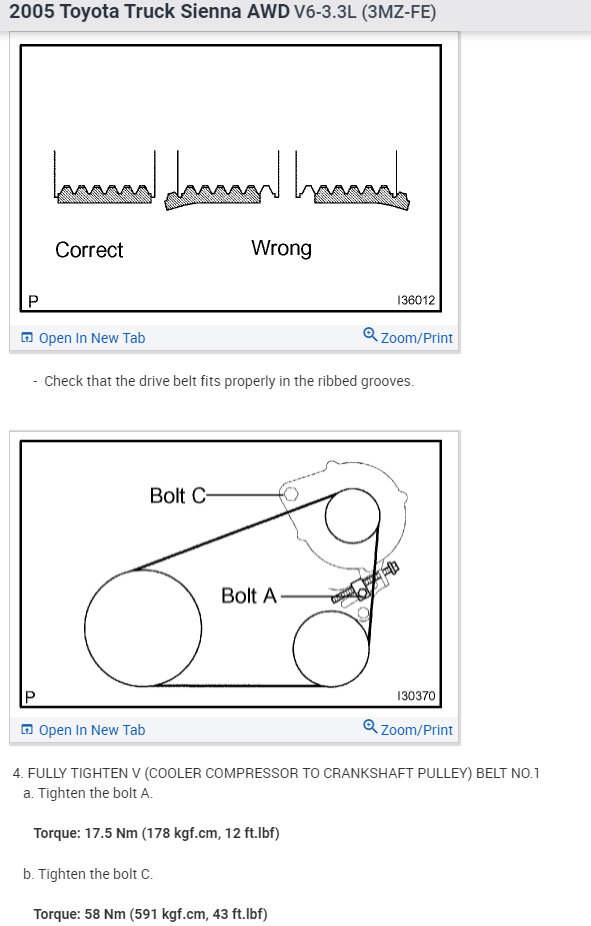

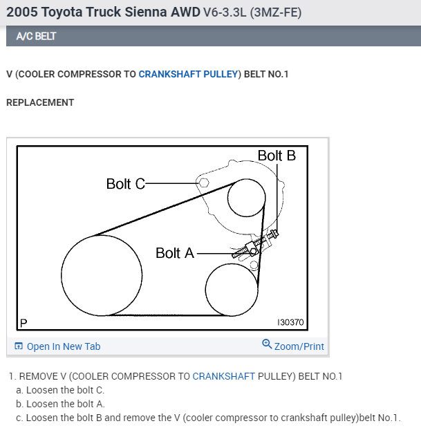

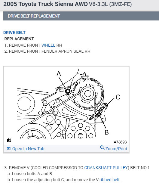

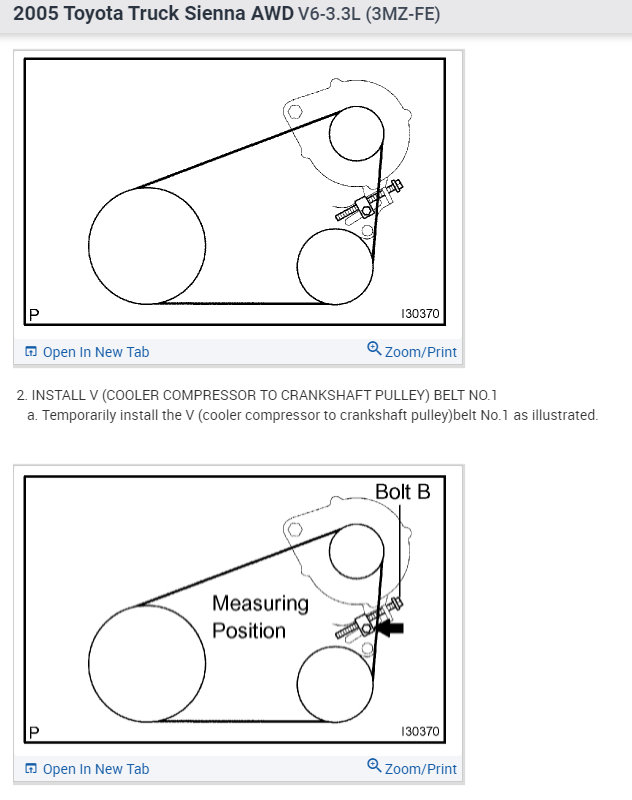

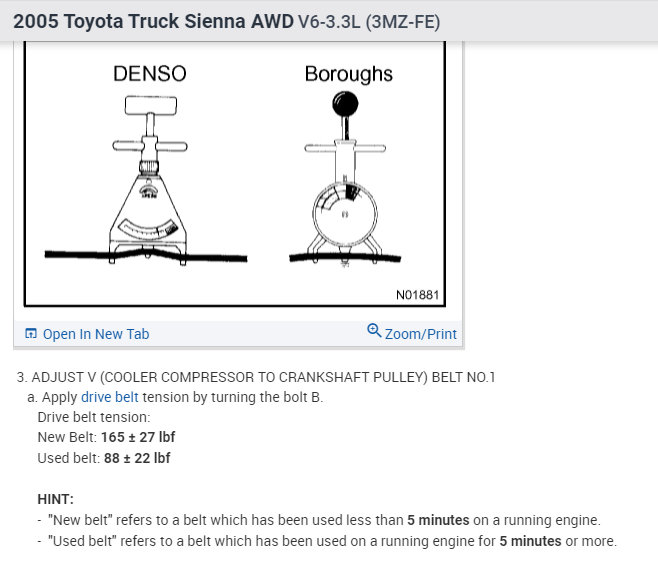

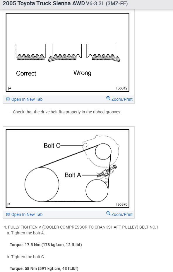

The best option would be to loosen the bolt just enough and then torqued to the specifications.
I have attached the replacement procedure including the torque specification for both the alternator belt and A/C belt below.
https://www.2carpros.com/articles/serpentine-belt-tensioner-replacement
