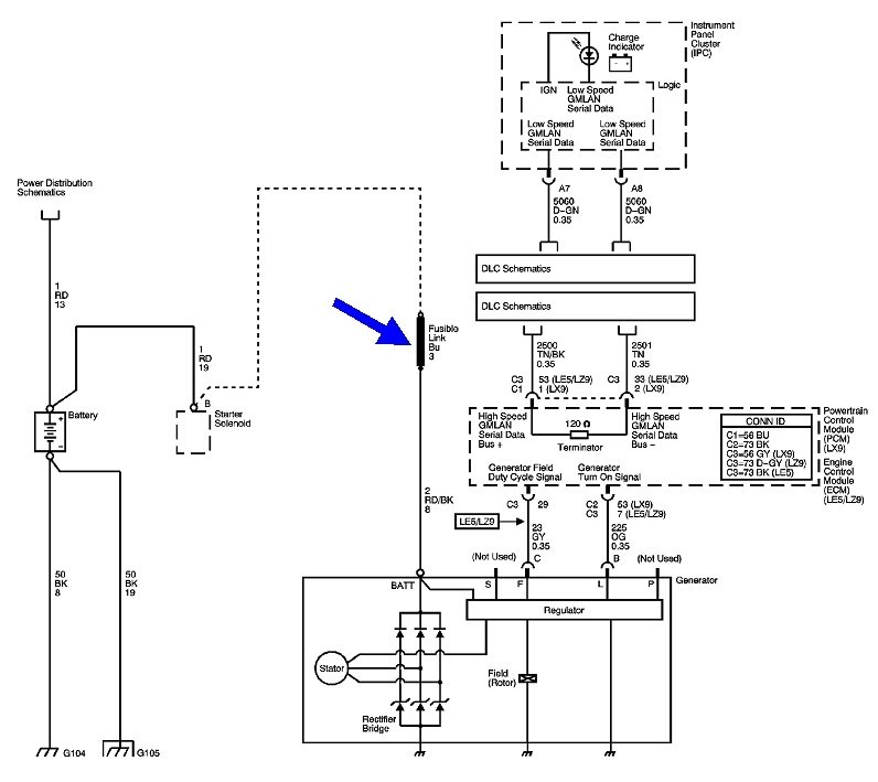

So, after retiring this car for about two months as winter cold and freezing weather wreaked havoc through the land- I restarted the engine to check things out. I had placed a new battery back in May of 2020. I drove it for about 10 miles, shut it off, did some work and returned to drive back home. 5 miles later, the engine loses acceleration, IPC light lit up one after another and the power door locks locked and unlocked in a state of frenzy. I managed to escape multiple traffic lights but ultimately the engine stalled at an uphill one-way traffic light. I managed to back up the car into a parking garage where I did obdii scanning (a total of 18 codes! mostly purge solenoid and emission related codes and TPS, Catalytic converter and other codes related to a past problem IMT stuck open and ISS low voltage. Unfortunately, I erased the DTC and could not replicate the codes many of which were repeats of the same thing). Then, I did some electrical testing. There was distinct rubber melting smell and smoke (which disappeared before I could determine the source- belt maybe? I thought to myself). Lighting and battery power seemed fine at the time of the breakdown. The next morning, I returned to do more testing. I found that the battery was literally dead. Jump starting did nothing more than move the car to the next garage a block away. I suspected the alternator. I got me a new one and in the freezing rain and snow, I replaced both the alternator and belt (belt had some rubbed or burned areas but still good; alternator tested at 15.2 volts output and still good). Tried to start the car; no go. Battery not being charged. I recharged the battery at a parts store, and went back to the site, installed and drove the car home (10 miles). Finally, at home the alternator isn't charging the battery. I tested the wiring, all grounds are in good condition. Alternator output is 14.8 v, but battery is 12.8 and going down. Finally, the car still running in the driveway, the engine begins to lose power again. Battery: 10.2 V and going down. I retested the battery and had it recharged at a part store. The same: Battery: good (the same pattern again). I decided to check out the BCM and interior fuses because I heard zapping sounds coming from that area after I shut off the engine. Heater blower motor fuse was blown (so was the auxiliary power outlet fuse back in the trunk fuse box). I replaced the fuses. What do I do next? One thing I am thinking: to attach a separate cable between the alternator post and the battery positive, run the engine and see if the alternator charges the battery? Is this possible (almost doubling the connection between the positive battery post and the alternator?) just to see the difference or is this totally wrong way do things? When I test voltage using the alternator post, I get 14.8 V at the alternator but only 12.8 V at the battery when the engine is running (meaning the alternator isn't charging the battery), and I get 12.1 V at the alternator post when the engine isn't running. The bottom line is if the battery is damaged, why is it able to recharge from low 3 volts at the stores but not be maintained at 12.8 inside the engine bay being connected to the alternator? I say this because someone mentioned that this battery maybe good, but it is really failing? I don't get it. It is under warranty but why replace it when things aren't clear?

Just doing a follow up on the above. So, I took the battery back to the retailer and they tested it and told me it was charged up but the cells inside were going bad and offered me a new battery. I installed the new battery, but it didn't solve the issue (as I predicted). So, I take it the alternator isn't charging the battery for sure and something is ruining it as well. I am not getting any DTCs besides the old problem of stuck open IMT with two codes the 2078 and 660. I did replace the IMT but it didn't fix the problem. I am not sure about one more thing: something smells like burning rubber. I lifted the car and looked everywhere but can't find melted or scorched wiring. I have yet to test the starter solenoid and B terminal but the car starts every time. Could something be taking the alternators charge away from the battery?

This is why I often tell people to use a test light instead of a digital voltmeter. If you stop reading right here and retest what you did already, but with an inexpensive standard test light, you'll find different results.
You inadvertently stepped over the best clue in that you found different voltages at the battery's positive post and the generator's output stud. Those two are tied together by a fat wire, so there has to be the same voltage at both ends. You'll notice the starter solenoid is in that circuit too. Don't pay any attention to that. It is only there because GM often uses that as a convenient tie point so they don't have to run two separate wires back to the battery. That solenoid is not part of the charging system.
At some point the end of the wire at the generator became grounded, either by accidentally shorting it to ground with a wrench, or because two or more of the generator's six internal diodes were shorted. That burned open the fuse link, shown by my blue arrow in this diagram. That is why you see a higher voltage at the generator than at the battery. The generator can be thought of as a pump for electrical pressure, (voltage) and the battery is the storage tank, like the water tower for your city's water supply system. As long as the voltage is higher at the pump, current will try to flow into the battery, but it can't get there because of the blown fuse link. GM's voltage regulators are inside the generator, so the entire system is working properly and regulating at an acceptable 14.8 volts. It's not supplying the electrical system though. That's why the battery is running down as you drive.
The fuse link wire is usually located near the starter solenoid. You'll see at least one piece of heat-shrink tubing on it about four to six inches from the terminal. Tug on that wire to test the fuse link. If it's still good, it will act like a piece of wire. If it's burned open, it will act like a rubber band.
You can buy new fuse link wire from any auto parts store. They may even have special ones for GM vehicles that have the terminal already crimped on one end. You'll need to splice the other end to the red / black wire, then seal it with heat-shrink tubing with hot-melt glue inside. That will seal out moisture. These are typically about 12" long. You can cut them into two or three pieces to make multiple repairs. The length you install is not important. It simply needs to be a smaller diameter than the other wires it protects. That makes it the weak-link-in-the-chain, just like any other fuse, except it is a slow-acting fuse.
Fuse link wires are selected by color which denotes their current rating. Don't try to use a regular piece of wire. Fuse links have insulation that will not melt or burn.
There's one confusing thing related to fuse link wires. That is they form a coating of carbon on the inside of the insulation where arcing occurred as it burned open. The generator's output current can't get through that carbon, but when no current is trying to flow through it, no voltage is dropped across it either. For all practical purposes, a digital voltmeter doesn't rely on current flow through it to take a voltage reading, just like a pressure gauge on a compressed air line doesn't require air to flow through the gauge to take its readings. You start with 12.6 volts at the battery, drop 0 volts across the fuse link, carbon, and rest of the wire, so you end up with 12.6 volts at the generator, as you found.
Now try to do that with a regular test light with an incandescent bulb inside, not one of the new fancy ones with all kinds of electronics. The bulb requires current flow through it to light up, and that current can't get through the carbon track. It will correctly show 0 volts at the generator. Another way to see this is to take the reading with your voltmeter, then while you're seeing the 12.6 volts, touch the test light there at the same time. When you do, the voltage will drop to near 0 volts.

Wow, the battery is charging at 14.8 V after I:
1. replaced the starter (B post was half broken-I am not sure how that happened) and although was not a problem (I tested it), the pink S wire connector plastic housing to the solenoid was broken as well. These GM starters have plastic housing where the S terminal plugs into it, and they are so fragile; I noticed they're broken on many cars. They can cause intermittent no start because the S terminal connector just slips right out.
2. replaced the nut-washer on the alternator post (there was a very light weight tin-like washer in between the post and the terminal. I don't think it was supposed to be there).
3. replaced the fusible linked thick wire between the alternator and the B post on the starter solenoid.
I liked your "water pump-storage tank" metaphor on the alternator-battery relationship because it allows the listener to understand how electrons flow in a circuit (compared to current and the electromotive force or voltage)
Your test light test method also proved to be true. Of course, as you mentioned most of us think of a test light as too simple of a tool to solve our electrical dilemma. But in this case it was necessary to show how regardless of voltage the connection just wasn't there.
Now, I was prepared to splice the fusible link per instructions. However, I got me a whole fusible link wire from another G6. I found an Impala's wiring as well (the same engine 3.9, but it was thicker (good maybe) and shorter (which prevented me from choosing it as an option). As always, I am thankful for your instructions and help.

So are you saying the system is working now? I suspect it is.
As for your observation of different fuse link wires, this is one item that needs a mention, especially for the benefit of other who might see this when researching a similar problem. Very often a car model could come with one of multiple choices in fuse link wires. Depending on factory-installed options including cruise control, air conditioning, high-output or rear heater, and rear-window defroster, those packages usually include an optional larger generator. A smaller generator could come with a 12-gauge fuse link wire, while a larger one would come with a 10-gauge fuse link. The wire has to be large enough to handle the full output of the generator for a short time. In the rare event two diodes were to short inside the generator, that would cause a dead short, and any fuse link wire will burn open.
Where it's possible to get into trouble is many of us think if big is good, bigger is better, and they bolt on a higher-output replacement generator. I must also point out the generator is physically incapable of developing more output current than it is designed and rated for. Lets say that's a real common 90-amp unit. The next important detail is they will only develop as much current as the vehicle needs, and no more. With head lights on, and heater on a lower speed, a typical car might need around 30 amps including a little to recharge the battery. Now if you replace the generator with a 120-amp unit, it is still going to develop only 30 amps. This would equate to a municipal water pump that can pump 100 gallons per minute, but since the tower is full, it's actually going to pump just as much as the people are using, and no more. If they install a 150 gallon pump, it isn't going to pump any more than the old pump.
For your car, that means no matter how big the generator is you install, it won't matter to that fuse link wire, . . . that is until your mechanic comes along to perform a charging system test. Professional load testers have us dial up a heavier and heavier load on the system until system voltage drops no lower than 13.75 volts. The voltage regulator will see that and in response, run the generator harder and harder to keep up with demand. When it reaches that maximum output is when we take the current reading. It's also important to note that there's no such thing as a weak generator. It will develop very close to its rated current or, if it has one defective diode, very close to exactly one-third of its rated current. The point of interest is if you have a 90-amp generator, during this test is the only time it will ever develop 90 amps. The fuse link was chosen at the factory to handle 90 amps for enough time to make it through the test.
Now if someone installed the 120-amp generator, and your mechanic runs this charging system test, it's going to develop close to 120 amps for a few seconds, and that can burn open the fuse link. Now you'll have a no-charge condition. Of course the mechanic gets the blame, but he had no way of knowing this modification was done.
At this point, if you happened to notice the color of the fuse link, and it's the same on the old and the replacement cable, everything will be fine. Even if it is different, it's going to work fine because every fuse link is a smaller diameter than the wire it's spliced to and is protecting. It's still the weak link in the chain.
