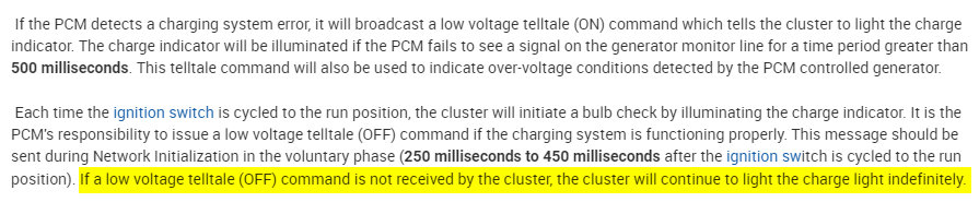

When you have the charging system code it needs to be cleared to stop the warning message for showing up here is a video to show you how.

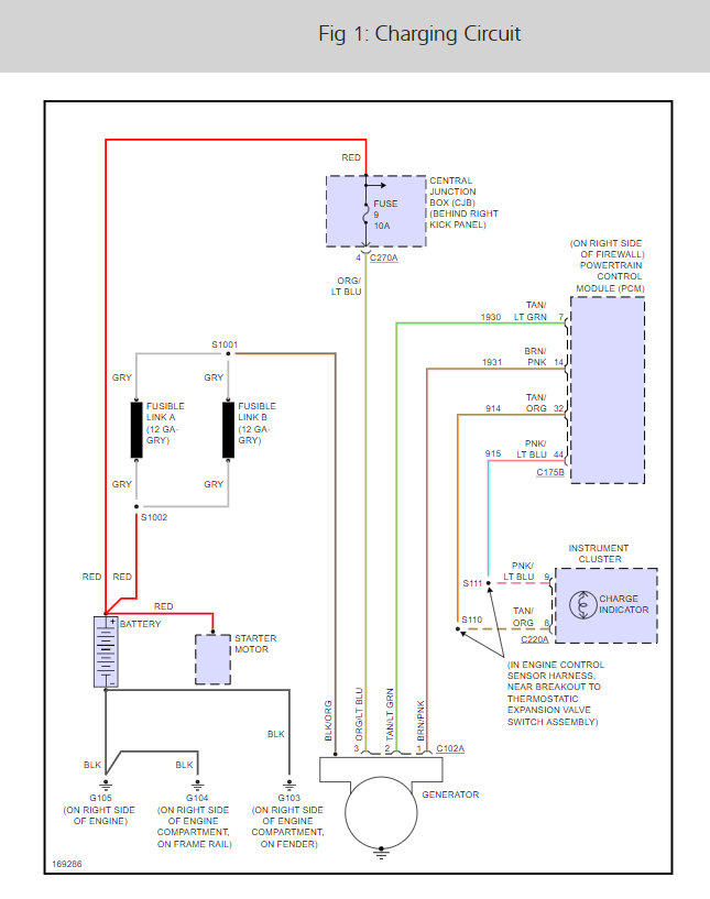

If you clear the codes and the warning comes back lets make sure the fusible links have power on both sides. Here is a guide and the alternator wiring diagrams to help you test and see how the system works.

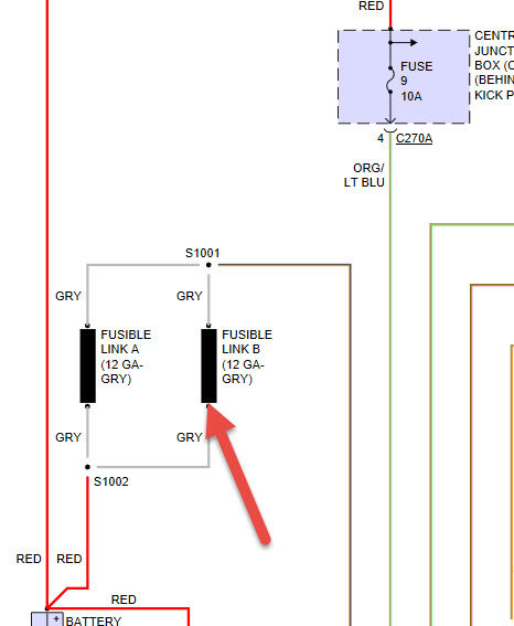

Check the two fusible links in picture they should have battery voltage both sides. The problem may be the PCM but lets run some tests first. Check out the diagrams (Below). Please let us know what you find.

Although I appreciate for your reply I'm not sure I understand. The alternator is definitely charging the battery and does not drain overnight but the battery light continues to stay on. Before spending money to test the fusible links, please advise If the alternator will still charge the battery with a faulty or blown out fusible link? Thanks.

it will charge if one link is still working. this maybe a poor connection at pcm.
There is a tsb on this to reprogram the pcm and check connections for being faulty but due to age of truck i'm not sure it will be taken care of so you will need to call a dealer about this. There is a sleeve and protective grease that needs to be installed.

OK, now its starting to make sense. I was told a blown fusible link will trigger the battery light to come on and will not charge the battery. Based on what you are saying, if one of the fusible links is faulty it will cause the battery light to come on but will continue to charge the battery. If that's the case, I will need to start by checking the fusible links and take it from there. Can you tell me precisely where the links are located and how to test them. Can they be tested with a multimeter in the vehicle or is it necessary to remove them completely and then check both ends.If you have any images of this procedure it will be quite helpful. Thank you kindly for your help, I will let you know the outcome asap..

Sorry, I forgot to mention that I did notice a 5" rectangular plastic casing covering 2 gray wires wrapped up in electrical electrical tape and run between the battery and alternator one was burnt through so I replaced it that fixed the problem and I had to clear the codes thanks for the video. Thanks again I love this site.

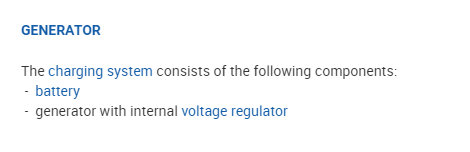

PEYTON RUCKER
I'm having a similar issue on my Ford explorer I changed the alternator yesterday everything was fine after and now this morning the battery light came on but the charge is not dropping all the way had batter tested and it got but says not getting any volts from the new alternator
Oct 30, 2019 at 1:49 AM

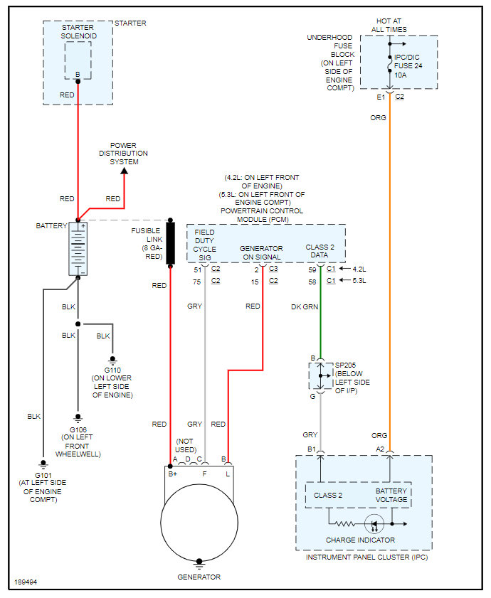

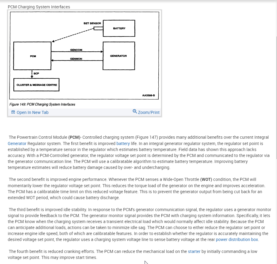

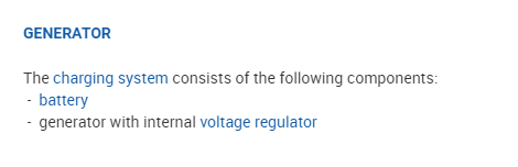

It appears your system has an alternator which means it is a PCM controller voltage regulator. Generators are the ones with internal voltage regulators and are replaced with the generator. Take a look at the attachments but Navigators with this issue usually have a failed regulator in the PCM. Let me know if you have questions. Otherwise, lets get a new post started with your Explorer info. However, these are almost identical to the Lincoln vehicles.
Oct 30, 2019 at 8:52 AM
