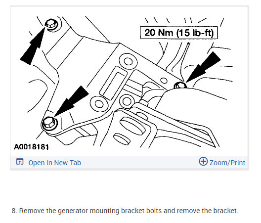

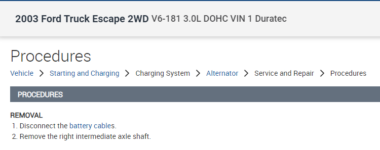

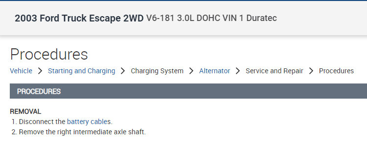

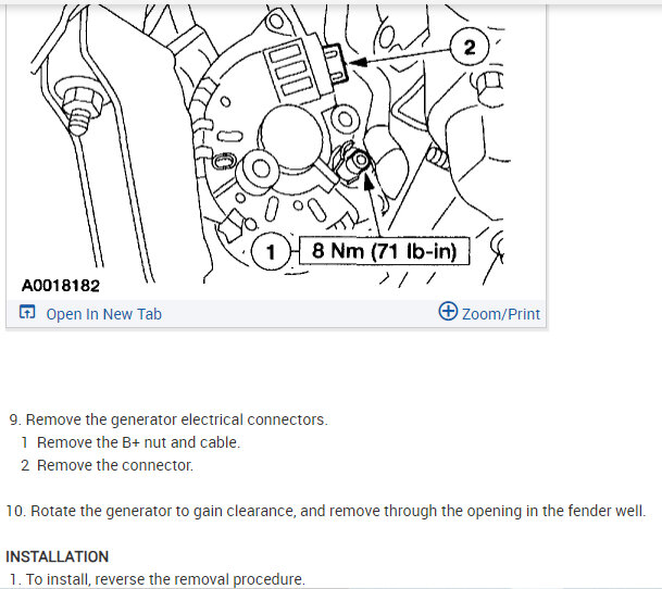

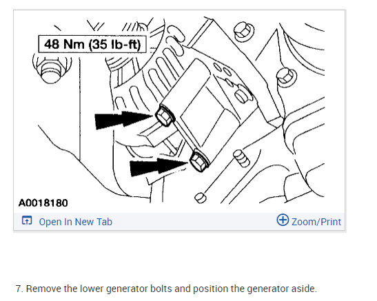

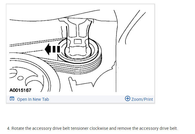

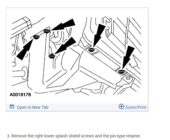

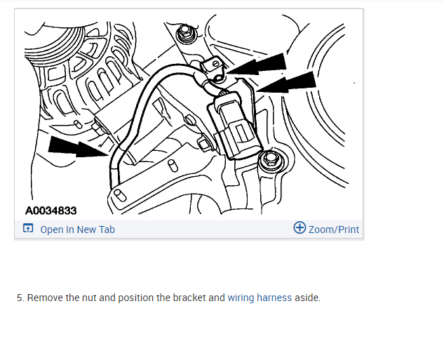

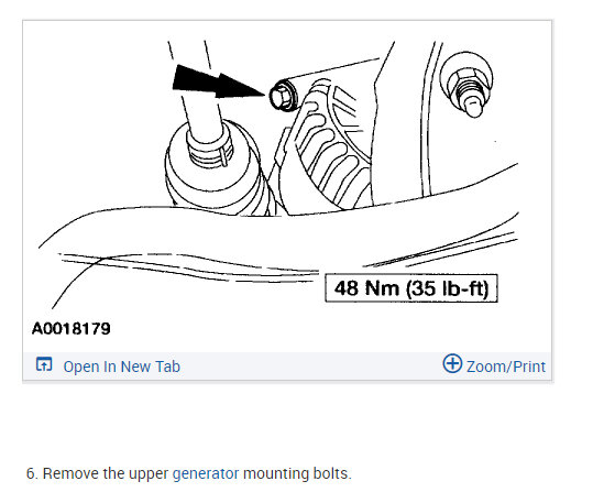

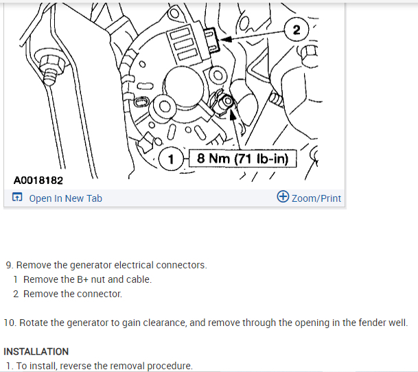

The alternator is low on the passenger side of the engine front. These are a bit difficult to remove because of their location and the lack of space to physically remove it from the engine compartment. Whatever you do, make sure the battery is disconnected prior to starting the job.
I attached the directions below for the removal and installation of the alternator. Note that it does indicate to remove the intermediate axle shaft.
Take a look through the directions and let me know if it helps or if you have additional questions.

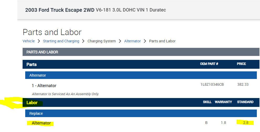

No problem whatsoever. The flat rate for labor is 2.8 hours. I attached a pic below for you to see it. The alternator price listed is an OEM part. That's retail for it and why it is so expensive.
Take care and let me know if there is anything I can do to help.
See pic below.
