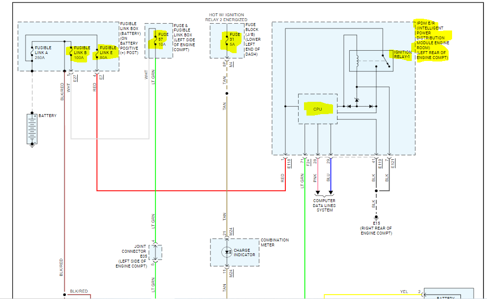

Brand new starter, alternator, belt, cable ends and new plug on alternator. . Sometimes a week at a time then shuts off. Sometimes if it sits for a while will restart and run again.

not what i mean. Battery goes dead randomly. May last a day (even running with lights and heater on) or a week. Drove fine for a day and a half and when came to stop sign, stopped and went to take off no power and battery drained. Wrecker came about 45 minutes later and started right up. Got it home and I ran it for about an hour with everything turned on and did not stop running. shut off and on a couple of times and started right up.

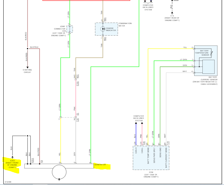

altenator stops charging. runs for a day then battery will go dead. Runs sometimes for a week. on the 3rd alt. Everything is new. Battery, cable ends, belt and new alt plug.

Okay, chances are it is the result of the computer processing unit (CPU) in the intelligent power distribution module. I attached the wiring schematic below so that you would have a reference.
The CPU isn't serviceable, so what I'm going to recommend is to scan the can-bus.
CAN stands for controller area network. Basically, the different modules in the vehicle communicate with each other via a few wires. This type of scan would retrieve codes regardless of the module storing them.
Here is a link that shows how it's done:
Other than the CPU (which is my primary suspect based on what you have already done), the only thing left is a connection issue. Make sure none of the fuses are failing and making contact and then not. Also, recheck the ground (black wires) between the alternator and the right front of the engine compartment.
See pics below. Note: I cut the pic in half to make it readable for you. I did overlap the two so you can follow from one to the next.
